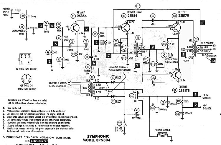

I am including the schematic here.Hi-Fi-Mogul wrote: ↑Thu Jul 29, 2021 4:28 am Well, this is an unpleasant surprise.
I wondered why this record player was set on 16 RPM.
The motor has a replaceable brass stepped speed turret,
with 2 set screws to hold it on the rotor shaft.
The smallest diameter step of the turret somewhat
matches 33.3 RPM, but it's too slow.
Normally, that would be the 16 RPM setting.
I think this is a 50 Hz turret, which for who knows why, was
put on this motor.
I have spare BSR motors, but this one runs on 9 volts.
Any way I could wire in a replacement to run on 120 V ?
The BSR 120 VAC motor I have has the same size mount
bracket. It fits perfectly in the old mount location.
The platter working diameter is the same in all these BSR's
at 7 inches wide, so that's cool, too.
If I wire the replacement motor to 120 VAC, then
the On/OFf switch would be located on the AC IN side of
power transformer T1.
Then take the rectified lead coming from diodes X1/X2 and
wire it right on C1 electrolytic.
Trim off the now extraneous old motor wires.
Does this seem functionally correct ?
- 1-Symphonic Samsonite Schema.png (230.8 KiB) Viewed 6324 times
- Posts: 8922
Re: Whimsical Suitcase
Yeah, you'd have to run the power switch ahead of the PT, then wire around the AC/DC switch. Then send the rectified DC from the rectifiers to the first filter cap. Looks like that should work. You might need a more robust power switch than the one there to operate on 120 volts.

- Posts: 1345
RE: switch. These BSRs come with a plunger type switch thatelectra225 wrote: ↑Thu Jul 29, 2021 10:56 pm Yeah, you'd have to run the power switch ahead of the PT, then wire around the AC/DC switch.
came already wired onto the AC 120 V motor I will substitute.
So no problem with that.
RE: Motor. Motor is DC, running off of battery or rectified AC,
per the schematic.
I cleaned and lubed the motor. It runs very noisily.
I'm going with the 120 VAC BSR motor substitute.
QUESTIONS:
I'm removing On/Off switch S2, Battery M1, and
the 9V motor from that part of the circuit.
I'm a bit confused as to how the X1X2 rectified voltage
connects and enters the circuit.
I see DC voltage originally connects to the record changer
switch S2, and it connects to the positive side of
the battery supply.
Does the DC voltage travel across the batteries' connection ?
Should I wire a ground (chassis in this case) connection
to that leg of the DC voltage ?
S2 switch diagram indicates DC voltage goes to ground.
- Posts: 8922
The "AC" terminal on S1 is actually B+ from the rectifiers. I might suggest removing S1 and just connecting B+ directly to the filter caps. And, yes, basically, the voltage from the power transformer (+ terminal of rectifiers) flows thru the battery. 7.4 VDC comes from the rectifiers to the 9 VDC battery. The positive terminal of the battery and the rectifiers connect to common negative, a rather different arrangement. The center tap of the power transformer supplies B+ to the filters. You should maintain the connection from the + terminals of the rectifiers to ground, at S2. I would remove S1, S2, M1, and the phono motor.
- Posts: 1345

- Posts: 1345
The Symphonic Samsonite is ready for travel.
A nice thing I discovered is there is a
terminal strip where the wiring
I needed to alter is wired in.
That AC/battery switch was already
wired to C1 with the center tap from the
power tranny, when in the AC position.
The ground point to use for the B+ rectified
voltage was right next to where both
rectifiers' positive ends were wired on the strip.
In photo, rectifiers are the 2 little green men.
I cut off the orange wire in the lower part
of the photo that went to the On/Off switch
of the original motor wiring.
I left a 2 inch pigtail which I wrapped around
the ground post of the terminal strip, and soldered in.
Voila', I had sound !
Then I took a BSR donor 120 VAC motor with its
switch already wired on.
Cleaned the motor, and it fit perfectly on the mini-changer base.
It had a female Amplok connector on its wiring, and I
used the male Amplok disconnected from
the original DC wiring scheme.
The output seemed a bit low. I checked the stylus and
it was not seated well in the cartridge rubber saddle.
Now output is pretty good.
Enjoying an LP test listen to “Whipped Cream and Other Delights”
by Herb Alpert and the TB.
Not bad at all !
Not bad at all !
