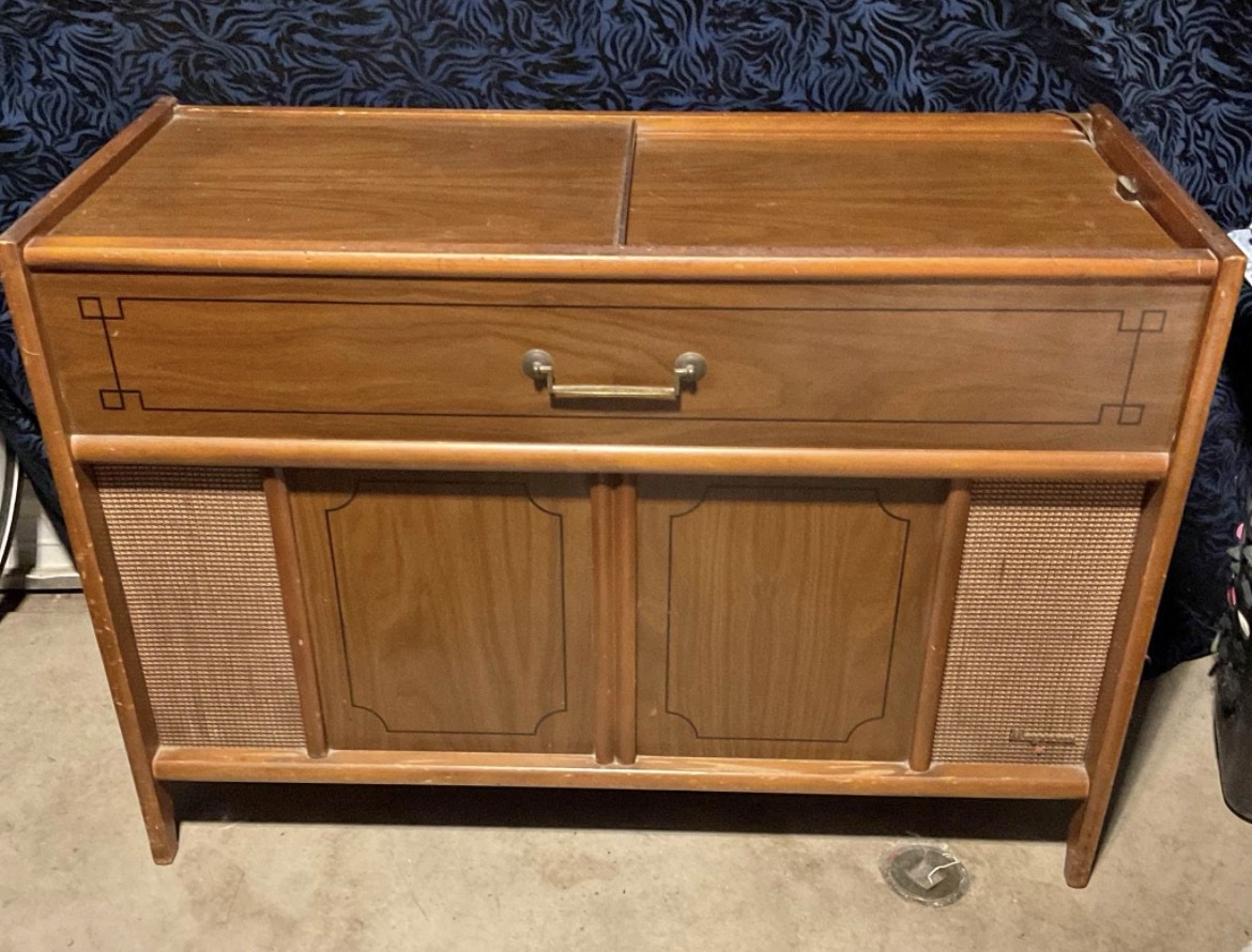

A little background: During COVID times, I picked up the vintage radio bug, after finding a late 40s Motorola AM/SW radio on Craigslist for $20. I re-capped, re-resistored, and re-wired that unit successfully after practicing on a similar vintage Packard Bell that they guy with the Motorola threw in for free when I went to pick it up. Recently, my early 90s Sony stereo receiver decided to blow something inside, rendering my ability to play my beloved LPs, so I decided to look for an AM/FM/Turntable console to restore, like so many units I remember seeing in older relative's homes growing up. So this weekend I found something cheap, after doing zero research, and I just picked it up. Now after having it a few days, I've pulled the amp and preamp and spent some time on the internet trying to see what I've got. The paper label on the cabinet reads 1ST288G. It looks exactly like the unit on the right, in this exerpt from the 1963 Magnavox catalog.
Here's what it looked like when I picked it up: Note that only one side of the top slides. Unlike earlier units, this model was cheapened by eliminating the record storage area.

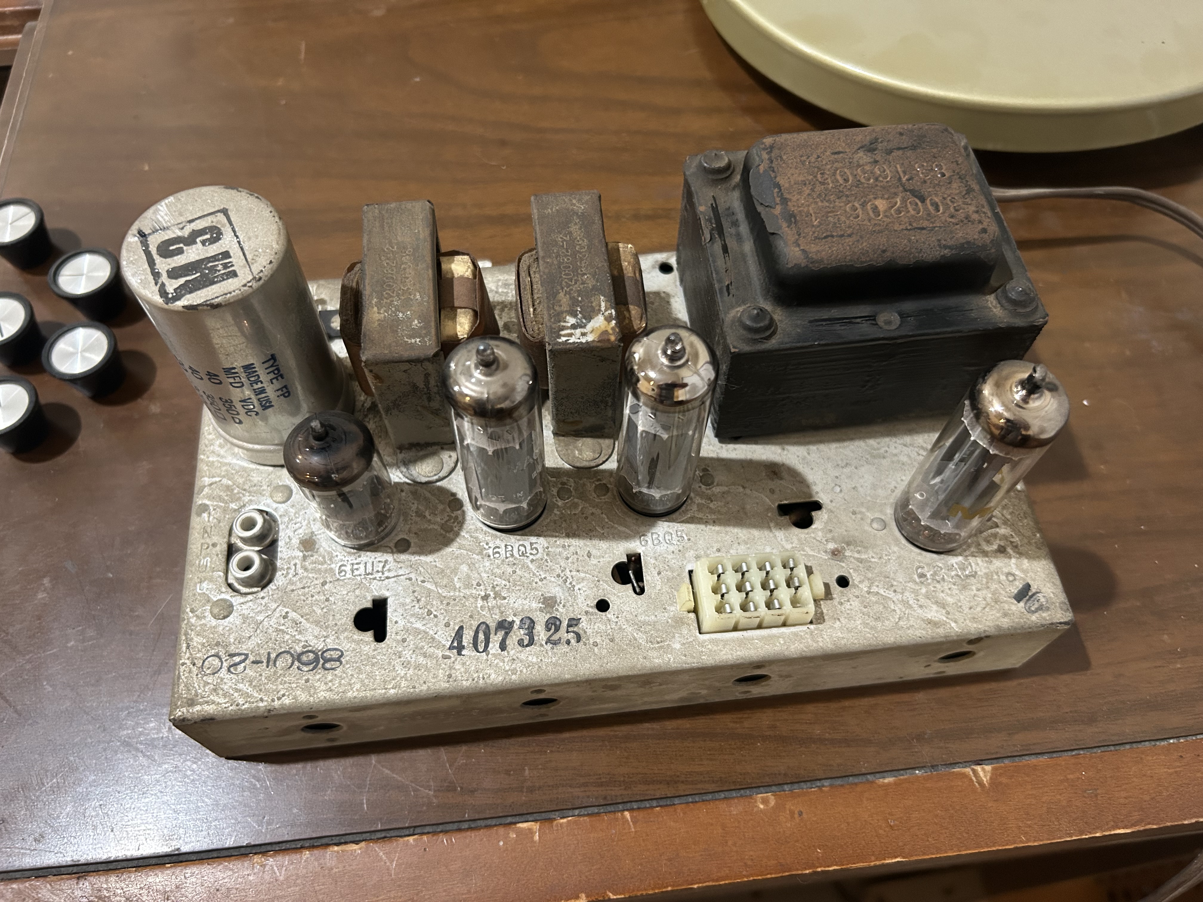

As I mentioned, I pulled the amp and preamp to see what I'm dealing with, and it turns out to be as follows:
Amp: 8601-20, the well-known single ended micro-power amp with 6BQ5 tubes
Preamp: 7907-00

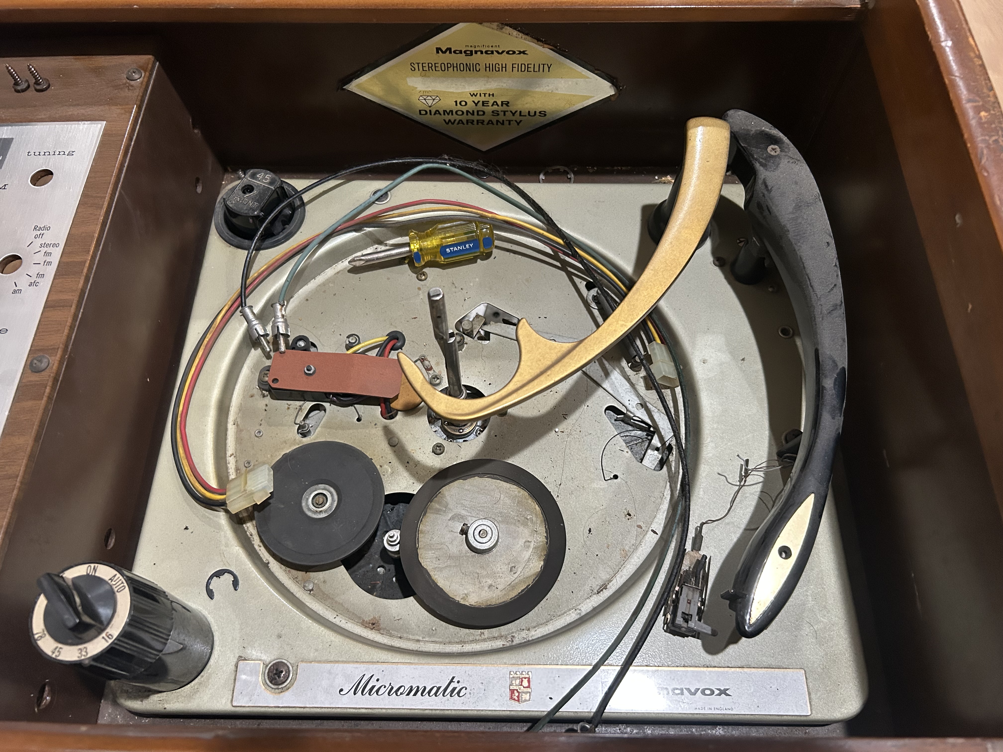

Record Changer: Micromatic G-600

A couple of interesting things in comparison to the catalog text. The cabinet I have is clearly the "Contemporary" model and it's labeled 1ST288G. There must be something in the G, because the catalog says Model 1-ST288 has an FM/AM Radio and the Model 1-ST289 has Stereo FM and FM/AM. The preamp faceplate on the model I have with the "G" has the following stops on the selector switch: Radio Off/Phono On, Stereo FM, FM, FM AFC, and AM. However, this unit does not have Stereo FM. The preamp chassis has unused RCA jacks for Stereo FM (CH1 and CH2) and TV (mono). Presumably, if you select Stereo FM, you get nothing, unless you plugged in an add-on Stereo multiplex circuit, which is clearly not included on this thing. Also, I have no idea (yet) which selection on the front dial corresponds to the TV audio input.
But this is all good news, because, of course, I'm planning to plug in a bluetooth unit to those Stereo FM input jacks, and get all modern with this thing.

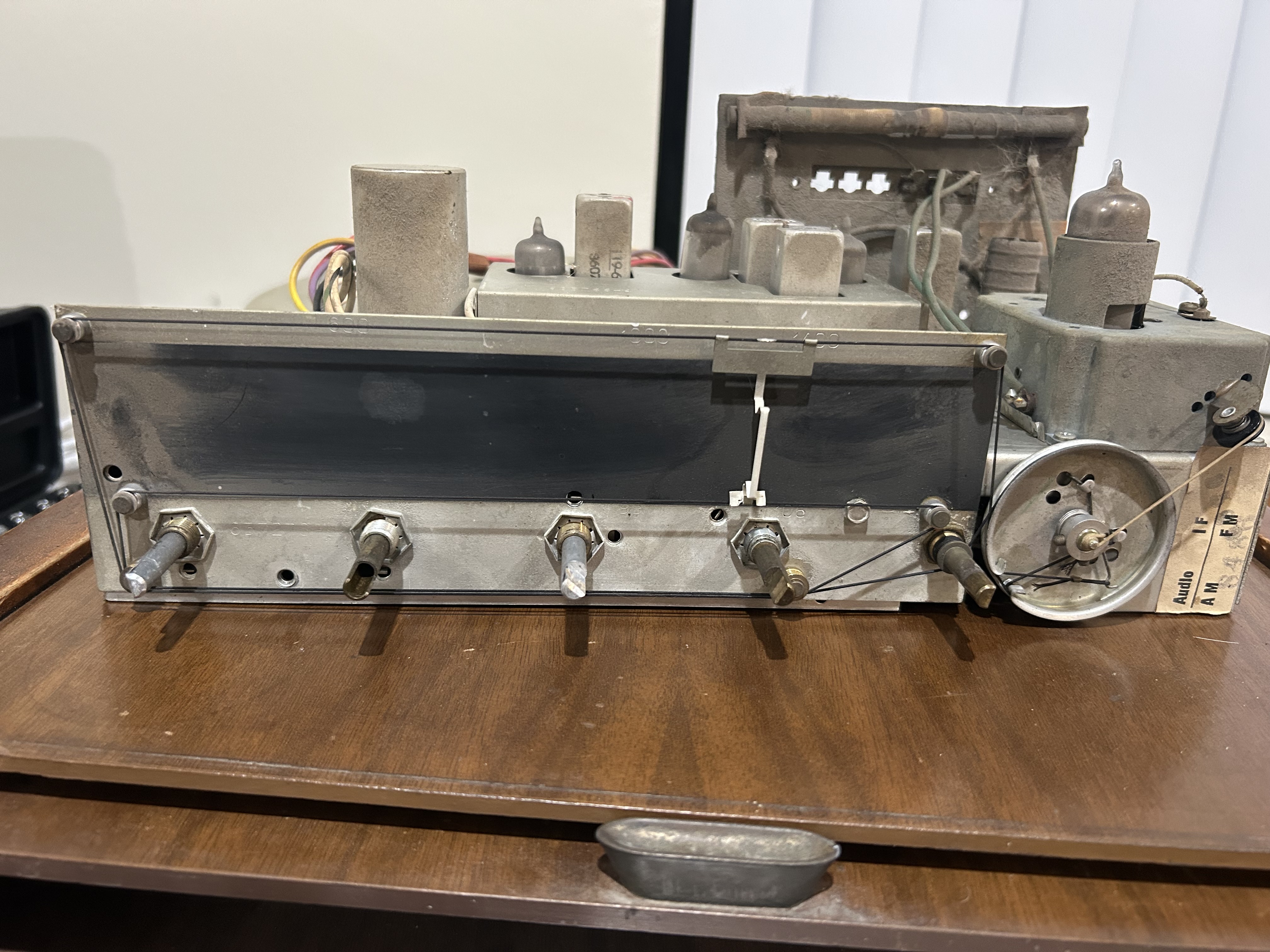

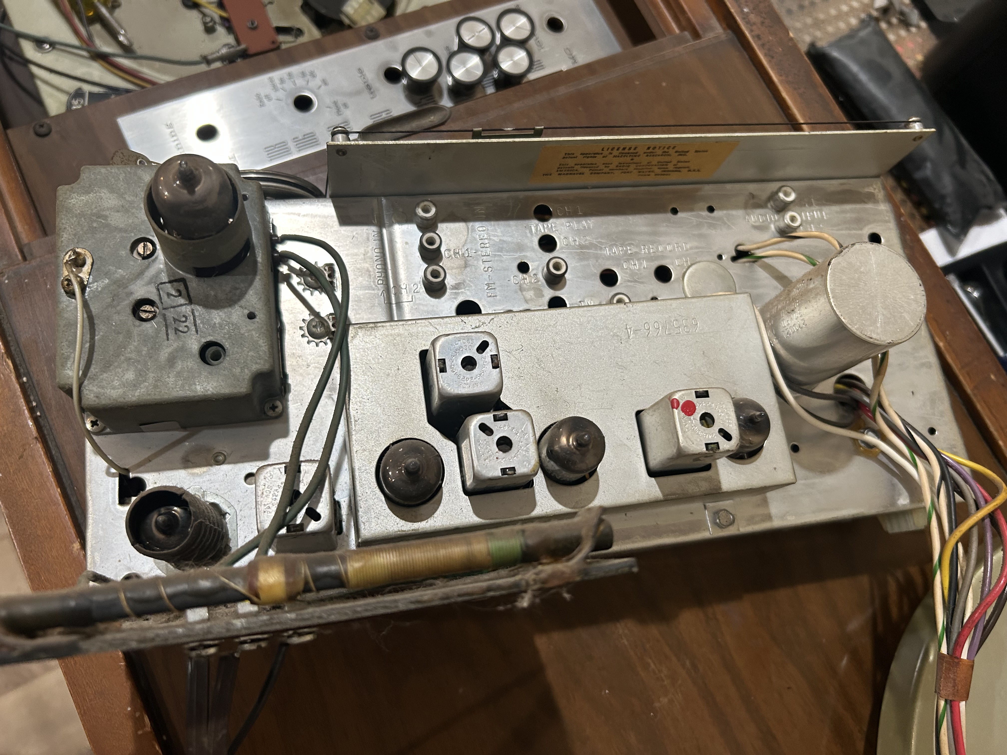

Here are the two chassis in “as-pulled” condition (minus an eighth-inch of dust):

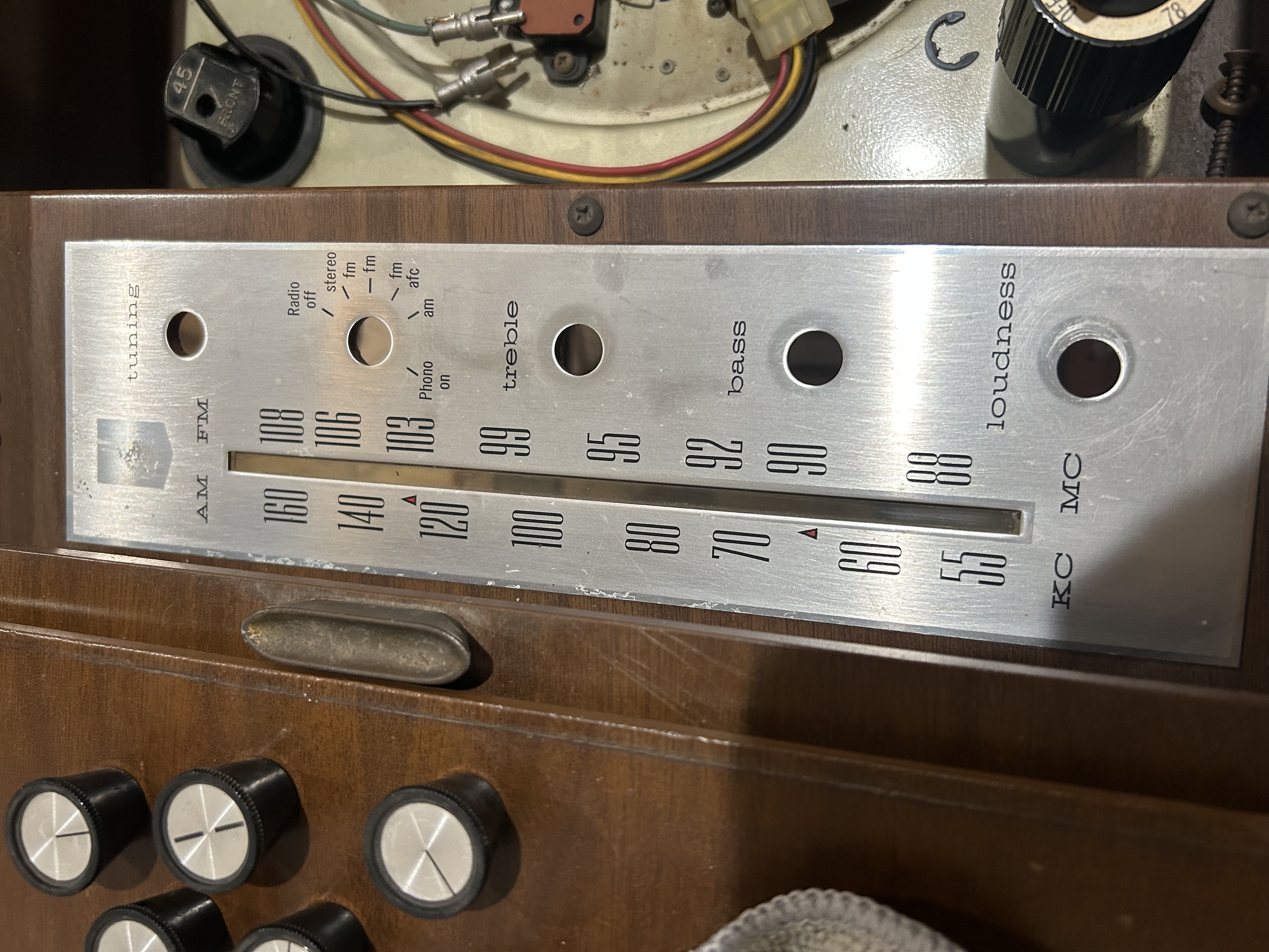

The 8601-20 amp: The 7907-00 preamp: The G-600 changer (minus the platter): And finally a photo of the faceplate. Note the apparently unused “stereo fm” position on the selector switch. Still unclear to me where the mono TV audio input goes, but I haven’t yet spent any time studying the schematics. Also I’m wondering why no L-R balance knob was included? Question: Is there a source for a Magnavox crest sticker to put on that faceplate where some kid likely peeled the original off? If not I have an idea how to re-create something there, but wondering what others may have done.

Aha! The 7907 does have a balance control! One of these control shafts is not like the other.
It’s the bass control, which is a 7 meg pot with a 50k pot on the back for balance control. Down inside that hollow shaft is a little screw head. There’s also a screw on the back of the control inside the chassis. One or both of those adjusts the balance. I’m hoping it’s just a matter of popping the knob off and inserting a skinny flat blade screwdriver down in there will adjust the balance. Seems really dumb to have to pull the chassis to do that. I do wish they had just used some kind of knob that pushed in slightly to adjust the balance instead of making you pop the knob off, but now I’m getting picky.

I was looking over Eric's post this morning and noticed the four holes meant for pots/controls. Curious, what other models was this amp chassis used in. Or, were the pots/controls installed in the amp when a tuner was not included with Eric's model and the whole amp chassis was mounted in the control panel. Also, Is that an EV cartridge laying on its back on the changer? If so, I sure hope it is in working order for him, I love they way EV cartridges sound with Maggie consoles.
You have a good eye. That is indeed an E-V cartridge dangling there. I was looking for parts for this changer, especially a good platter mat since mine is totally missing. I ended up finding a guy locally who had three Micromatic changers (out of long-gone consoles) that he needed to get rid of. Of course, I took them off his hands because two of them had 9-inch mats in decent shape, and I figured I would have just about any part I would need, when I get around to the changer on this console. So now, in addition to the G-600 that came with the console, I have two S-600s and a W-604 with the 11-inch platter. I'll decide later which one gets to reside in this console.

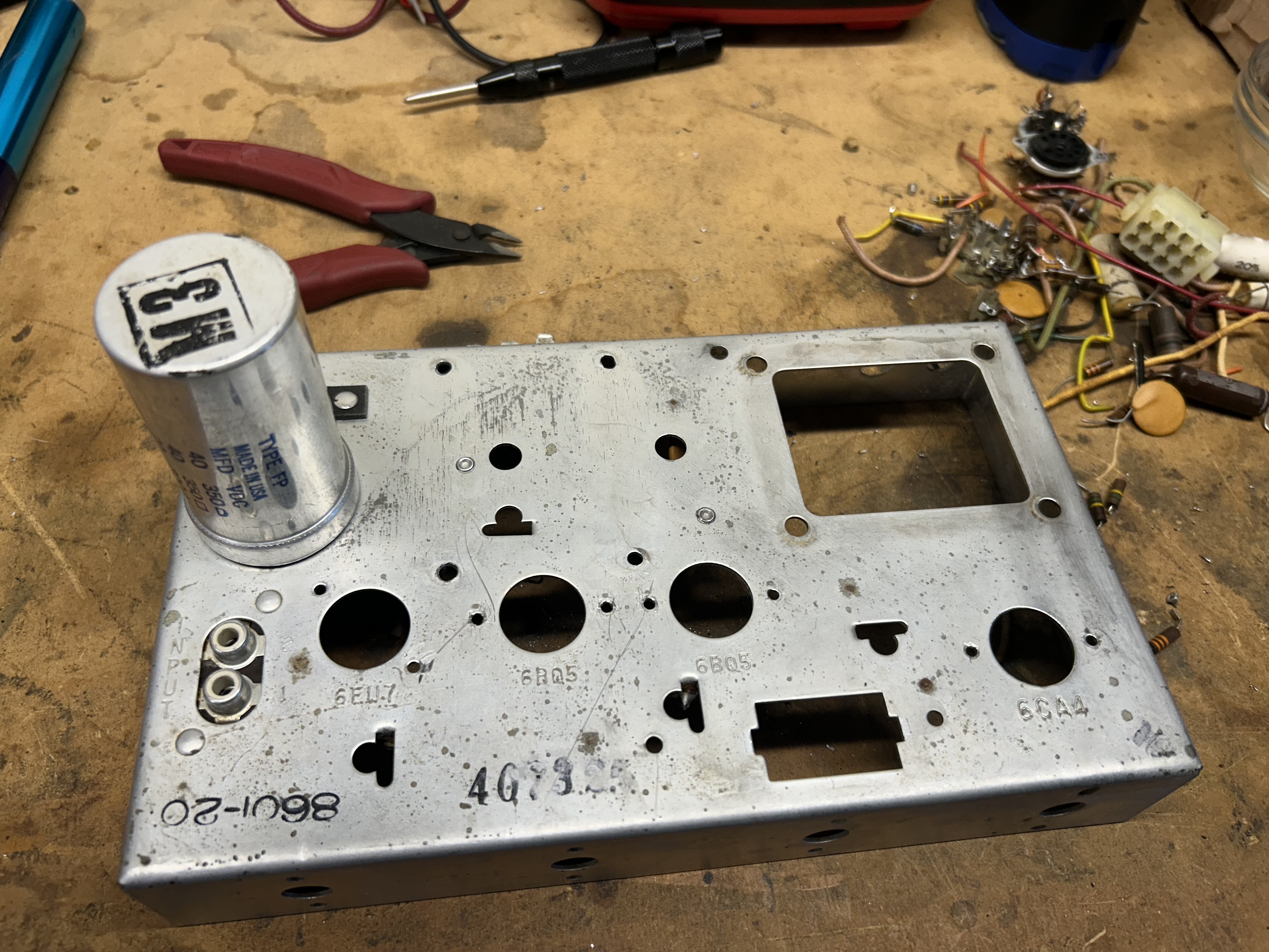

Progress so far: I decided to gut the 8601 amp. It was pretty grungy, and I was originally only going to remove the transformers, clean it up, re-cap, and replace drifted resistors. However, while prying the remains of a drilled out rivet holding one of the output x-formers, I slipped and put my screwdriver through the 6EU7 socket. That led to the decision to completely gut it and replace all the tube sockets. In for a penny, in for a pound.
Here’s the cleaned up chassis. The washing revealed more pitting of the cad plating than I originally thought, so I’m glad I did it this way. I will most likely paint it, although I haven’t ruled out a polish and wax job yet.

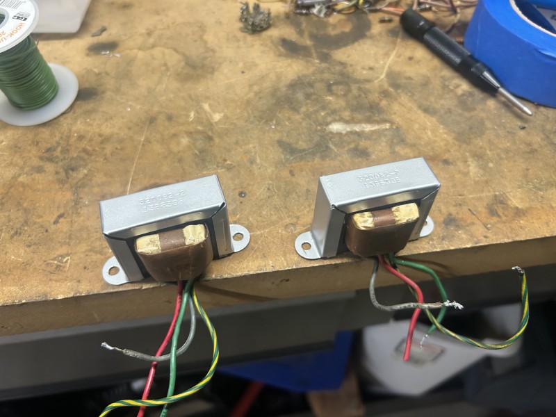

Sorry for the lack of updates on the old Magnetbox. Unfortunately, earning a living quite often gets in the way of hobbies, especially when it involves travel to just about the farthest place on the globe from home. Anyway, I did manage to refurbish the output transformers. Hope to make more substantial progress soon!

Curious about the OPTs--did they just need cleaning? And what is your technique?
