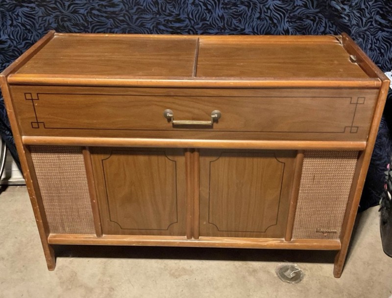

A little background: During COVID times, I picked up the vintage radio bug, after finding a late 40s Motorola AM/SW radio on Craigslist for $20. I re-capped, re-resistored, and re-wired that unit successfully after practicing on a similar vintage Packard Bell that they guy with the Motorola threw in for free when I went to pick it up. Recently, my early 90s Sony stereo receiver decided to blow something inside, rendering my ability to play my beloved LPs, so I decided to look for an AM/FM/Turntable console to restore, like so many units I remember seeing in older relative's homes growing up. So this weekend I found something cheap, after doing zero research, and I just picked it up. Now after having it a few days, I've pulled the amp and preamp and spent some time on the internet trying to see what I've got. The paper label on the cabinet reads 1ST288G. It looks exactly like the unit on the right, in this exerpt from the 1963 Magnavox catalog.
Here's what it looked like when I picked it up: Note that only one side of the top slides. Unlike earlier units, this model was cheapened by eliminating the record storage area.

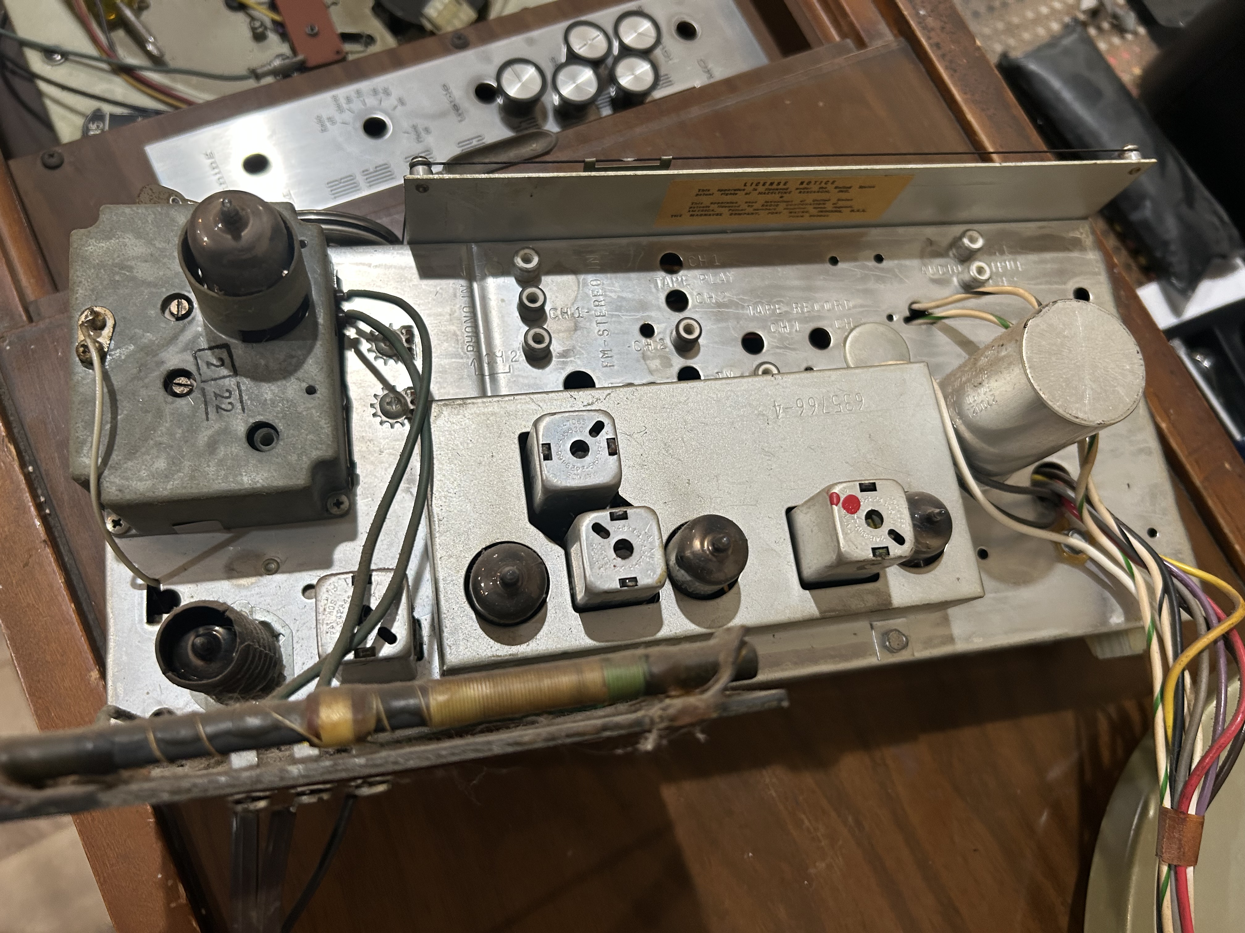

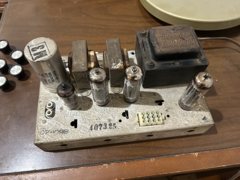

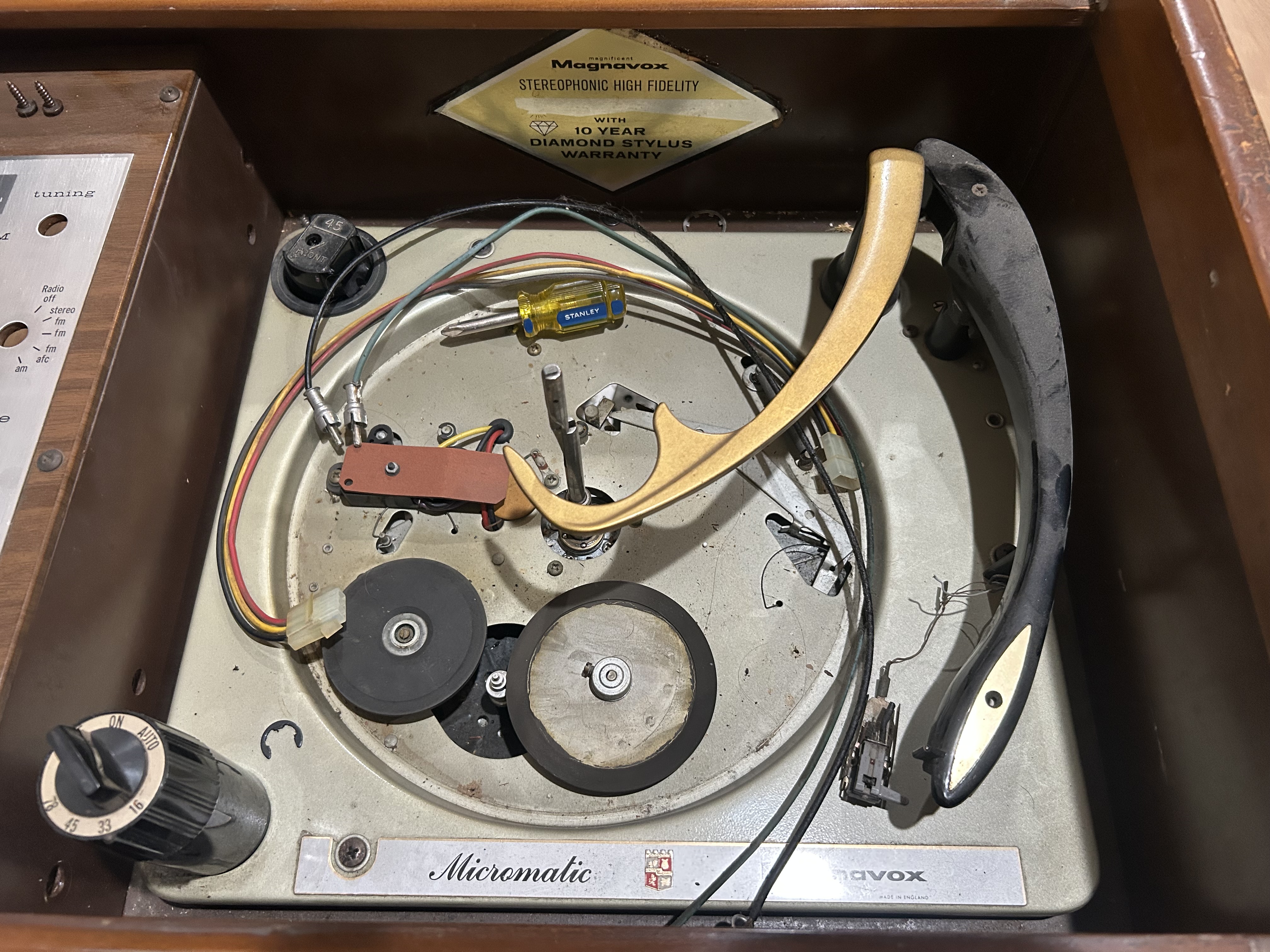

Here are the two chassis in “as-pulled” condition (minus an eighth-inch of dust):

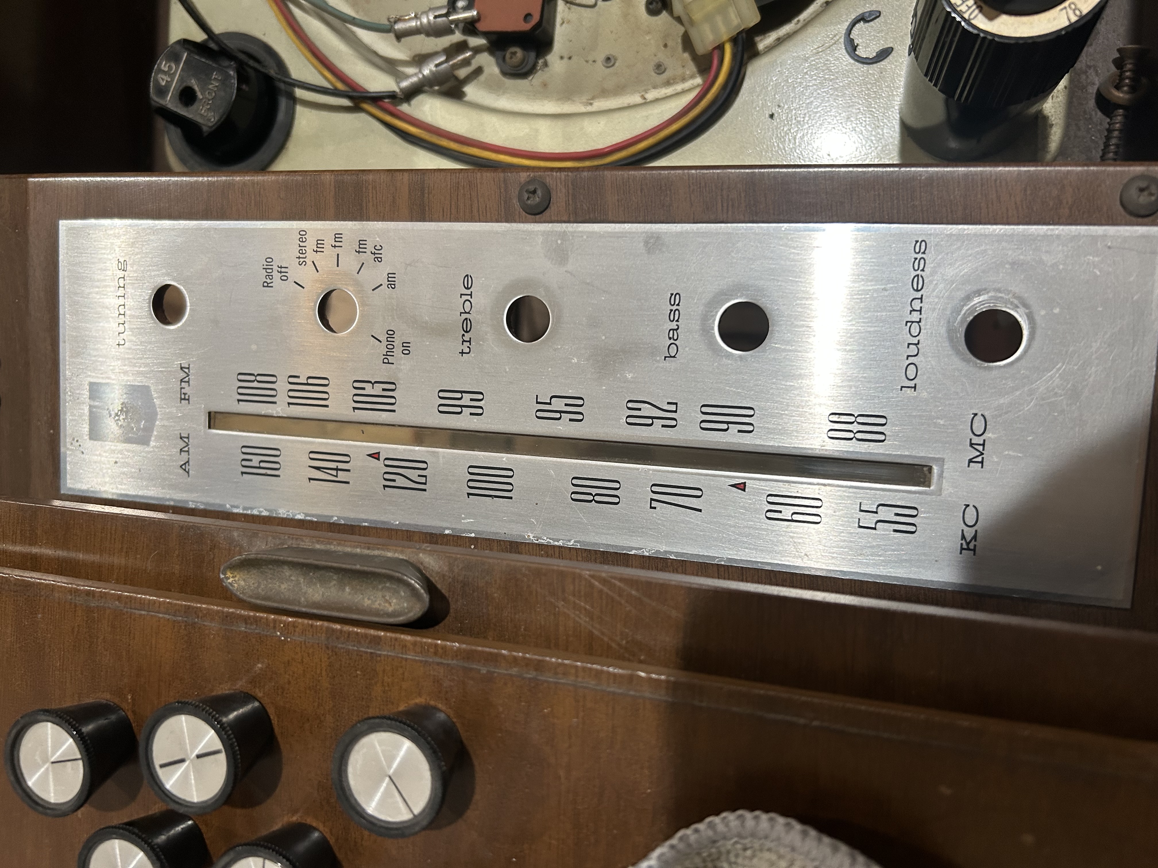

The 8601-20 amp: The 7907-00 preamp: The G-600 changer (minus the platter): And finally a photo of the faceplate. Note the apparently unused “stereo fm” position on the selector switch. Still unclear to me where the mono TV audio input goes, but I haven’t yet spent any time studying the schematics. Also I’m wondering why no L-R balance knob was included? Question: Is there a source for a Magnavox crest sticker to put on that faceplate where some kid likely peeled the original off? If not I have an idea how to re-create something there, but wondering what others may have done.

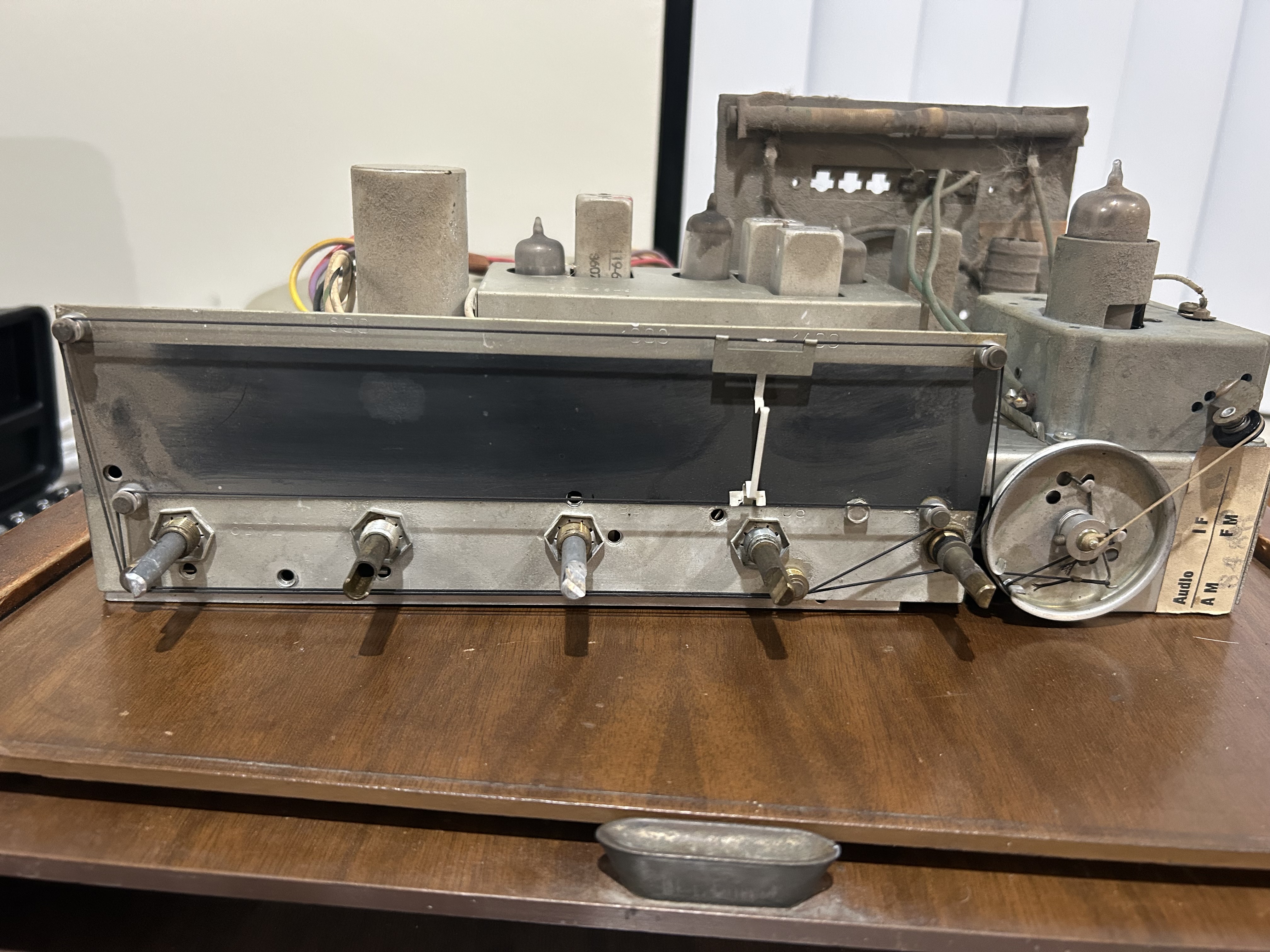

Aha! The 7907 does have a balance control! One of these control shafts is not like the other.
It’s the bass control, which is a 7 meg pot with a 50k pot on the back for balance control. Down inside that hollow shaft is a little screw head. There’s also a screw on the back of the control inside the chassis. One or both of those adjusts the balance. I’m hoping it’s just a matter of popping the knob off and inserting a skinny flat blade screwdriver down in there will adjust the balance. Seems really dumb to have to pull the chassis to do that. I do wish they had just used some kind of knob that pushed in slightly to adjust the balance instead of making you pop the knob off, but now I’m getting picky.

I have a thin screwdriver that I bought back when I was twisting wrenches to adjust the K-Jetronic fuel injection on European cars. Works like a charm to adjust the balance on Magnavox stereo amps. There is a procedure for adjusting the balance and I believe that procedure is in Downloads on this forum. Basically, the procedure involves using voltmeters on each channel speaker, using a known clean mono source, then adjust so the voltage is the same on both channels. And old 78 rpm record on a 45 that isn't stereo works pretty well. If you have a signal generator that generates a 1000 cycle audio note, that works well too. On the 88-and 93-series amps, you can't use the FM stereo position to run an audio source. It is designed to work with a Multiplex adapter. I don't know for sure about your amp, but assume the procedure would be similar. You might want to clean the balance, and other controls, before you make a lot of adjustments. They are known to be dirty, some even intermittent after cleaning.
On the 81-series amp in my Imperial, the balance control is in the hollow shaft of the bass control. On the 82-series amps in the Concert Grand, there is no balance control whatsoever. There is a phono balance control on the tuner chassis, but that's about it. As far as I know, Magnavox never put a separate balance control on any of their tube consoles. The 88-series mounted the power switch on the treble control, a horrible idea. The 93-series actually had a separate power switch, we called these tuners "6-knobbers". Your tuner would be a "5-knobber".
