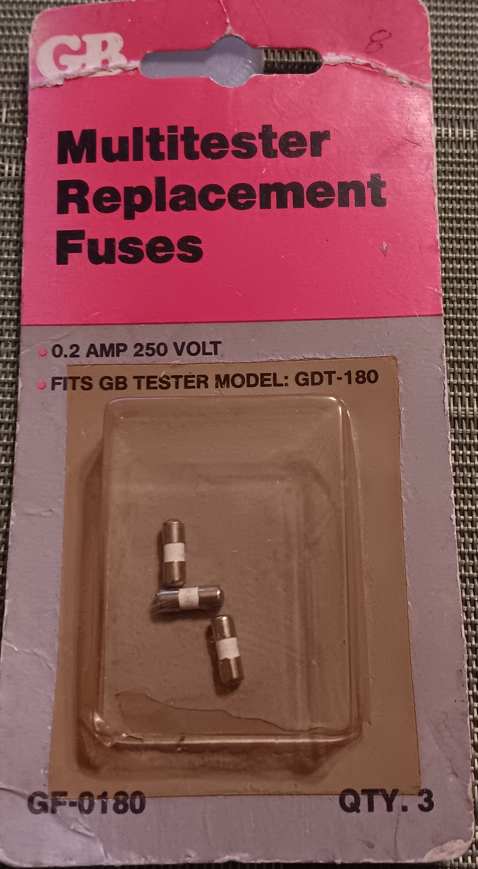

I checked some of my fuses and the small fuses measure .205" X .775". Any chance that they'll work?

So its 0.5 amp at 0.5 ohm
Maybe send info the littelfuse se if they made a sub
https://www.ebay.com/itm/126955997132

Gb uses simular physical size as pictured
