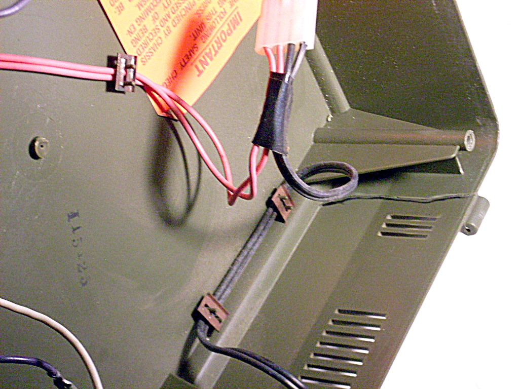

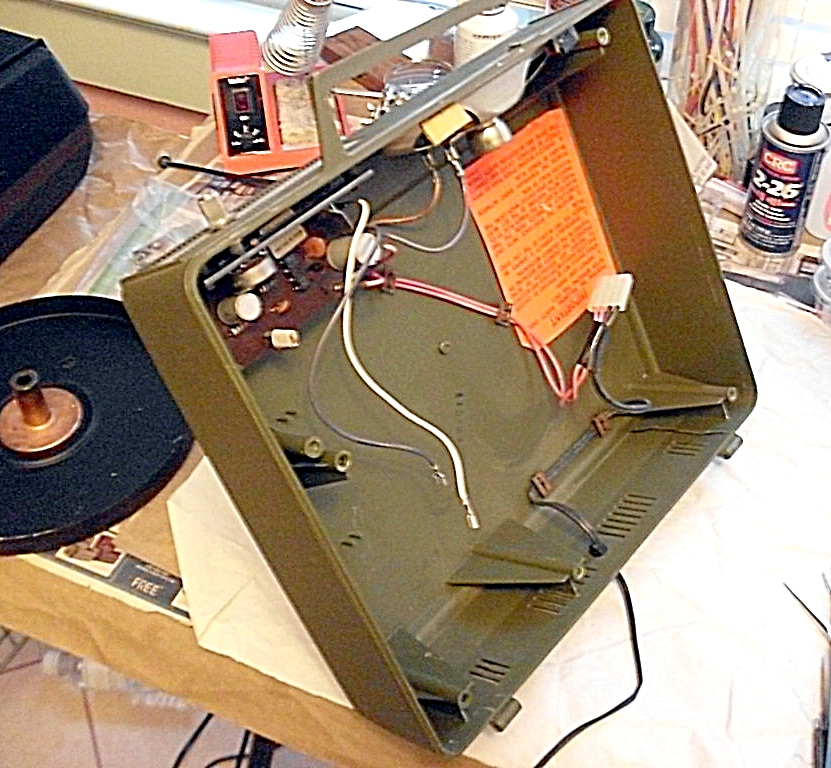

I picked up another of these little G.E. mono SS players.
This one has a good cartridge, and mechanically no problems,
other than the usual cleaning.
But, there is a bad crack in the bottom of the cabinet that
houses the amp and changer.
I marked the crack w/black to see it better.
Besides using epoxy on the crack, I want to make a
brace, also.
This is because the top lid exerts pressure on that hinge point,
and I need the crack really stable.
Other ideas ? I have some leftover strong press board from the
rear panel of a console I could drill through, epoxy,
and secure with small screws/nuts.
Or I could find a piece of plastic to do the same.
brace, also.

So, you're saying to do initial epoxy on the crack,
let dry, then place tape, and epoxy over the tape,
mutiple times if wanted ?
Thank you for the idea !

Use the tape as the first layer. It is sticky, so just cut a piece and put it on the crack, then epoxy over the whole thing. You can double or triple layer the tape if you want the stiffness for some reason. That crack you showed is not structural, just cosmetic. I'd probably use a single layer of tape, followed by epoxy. Use body filler on the outside if you want to, then sand, prime and paint.

Okay.
The crack though, is structural in the sense that when
the cabinet lid is up, it puts stress on the crack and opens it up.
I'll use several layers of the tape, for sure on this.
Do you have a favorite epoxy product ?

Appreciate all the input.
I modified Greg's idea, and I bought a Do It Right inexpensive
epoxy dual syringe.
It's a very good product, and more volume too !
I realized the trick to getting the epoxy out measured
easily is to apply pressure to one side at a time.
This dispenses a drop at a time, albeit a bit slowy.
But the viscosity of hardener and substrate are the
same, so it was easy to measure 1:1 ratio.
I glued the crack first, blocked the crack so it would
press together.
After that cured, I placed a piece of aluminum tape onto
the crack line, then epoxied a layer over the tape and
edges.
Now on to cleaning up that record changer, placing a
new stylus, adjust tracking force, and on to the
record shop with it !
epoxy dual syringe.
press together.
edges.
