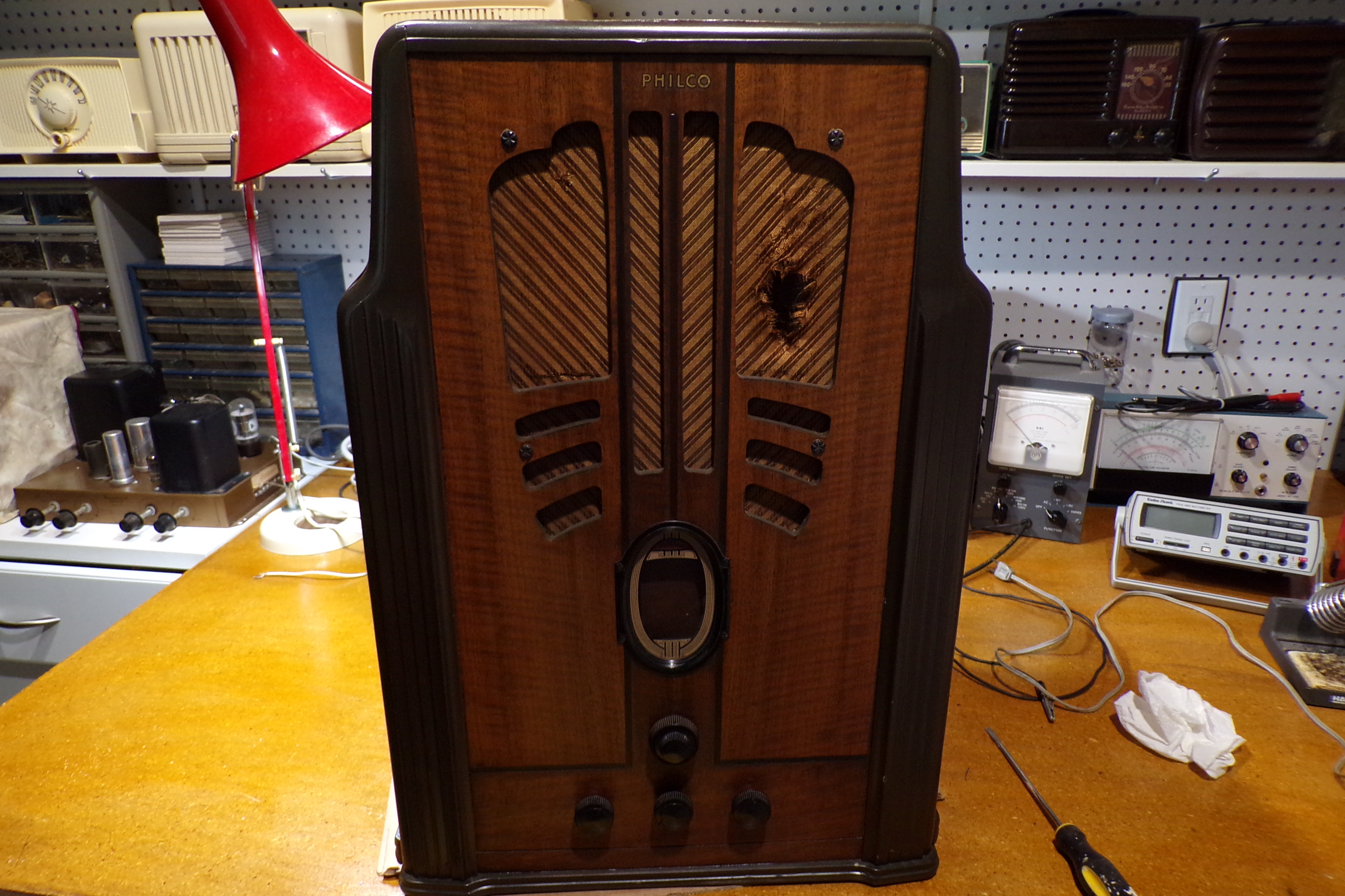

I got this radio out of a fell down chicken house. IT was in deplorable condition when I found it, but, oddly enough the original grille cloth was still there and was in one piece. I see somehow the grille cloth got a hole put into it during the move. This radio is a ten tube model with a 10" speaker. Basically a console radio guts in a huge table model radio. It is typically a robust performer. IT has developed a bug in the antenna somewhere. Reception is weak unless and until I put the antenna directly to the grid of the 78 RF amp, then it goes like a scalded dog. Something is amiss between the antenna terminals and the RF amp. I have a book on this chassis around here someplace. The search is on.....

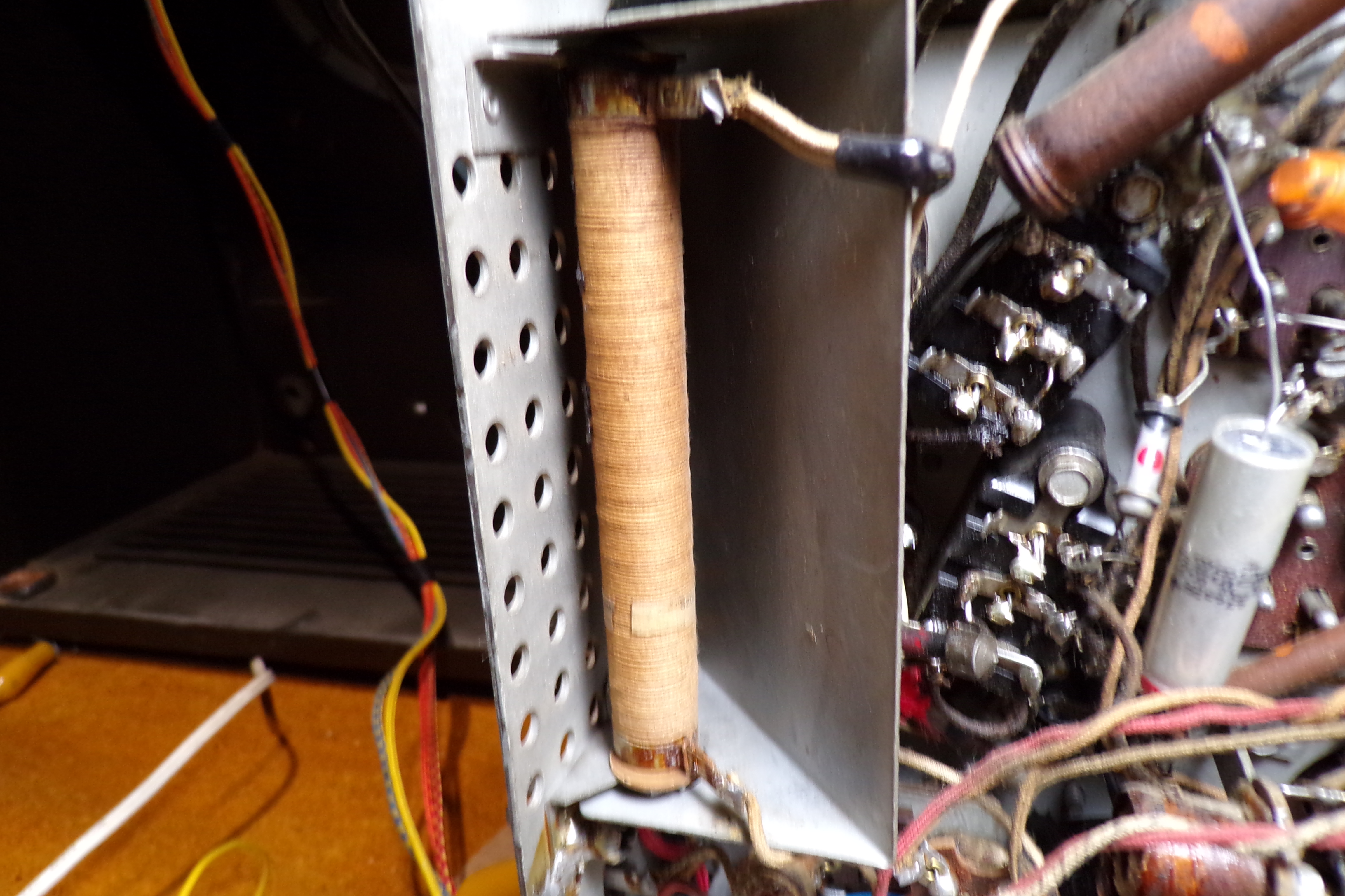

Philco was notorious for the coils to turn green and disintegrate... hopefully that is not your problem... but modern rf coils can replace them with a little tuning ...

I've run into the green crud before, usually in Zenith. That typically makes the coil open. I don't believe, at this point, that anything is open. The radio works, just really weak reception. There are a dozen padders in this chassis. When I restored it the first time, I had a padder really out of whach, with similar results.

I have found the green crud and been able to make repairs with very tiny wires and hyper-eutectic solder.

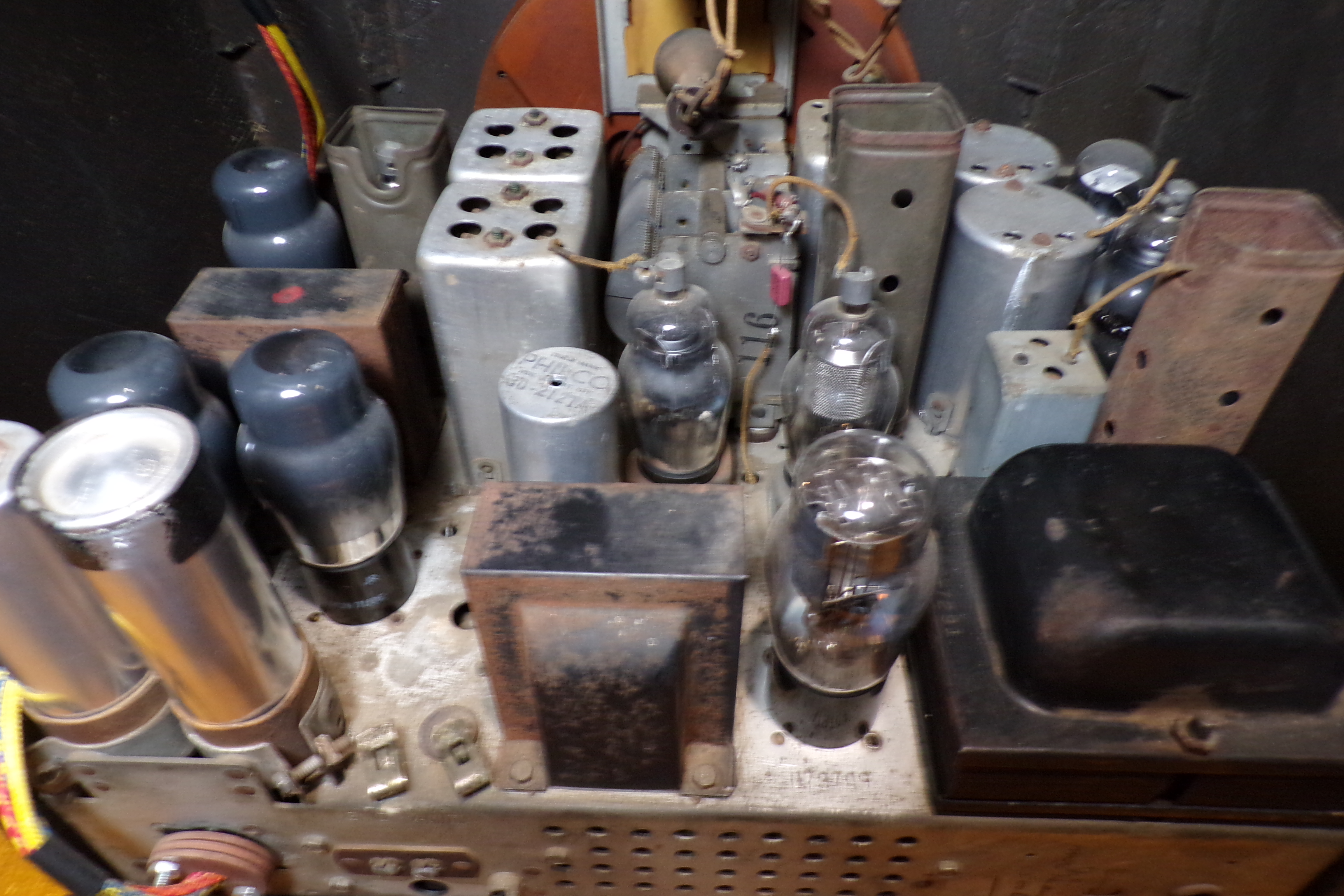

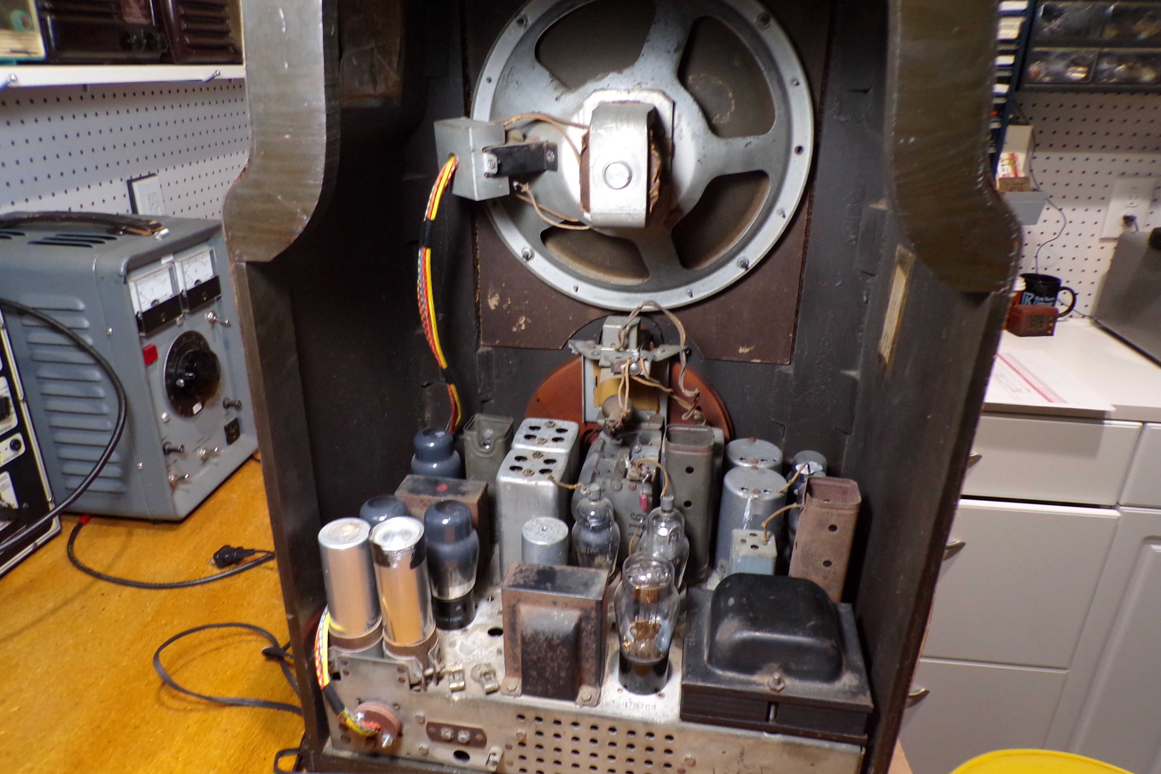

I've been doing some cleaning on the Philco chassis. Nasty is the only word I can come up with. Chicken house fresh. I'm going to do the alignment when I get another session in the shop. There is a 78 IF amp tube that is loose on its base. It is in a raised base for the tube shield Philco liked to use. The base is almost as high as the bakelite on the tube, so there's a good chance I'll destroy the tube removing it. I may try some navel jelly or something like that. Lots of black spots of corrosion on this chassis. If I can figure out some way to clean the chassis, I'll tape it off and paint the transformers. Then so something with the tube shields. Oh, yeah, I forgot. The radio snoots may have a stroke since I'll probably use black grille cloth in a vaunted 116-B until I can find something more appropriate. I posted pictures in my first post so maybe this will make more sense.

I may be in the market for some chevron grille cloth, Dave. If you look at the back of the speaker cone, you can see the outline of a mud dauber's nest. I left the nest on there for awhile, just for effect. IT was large enough it hit the basket of the speaker and made noise. I have no idea what damaged the admittedly delicate grille cloth. One of the rear feet on the cabinet is missing, always has been. I probably should make a new one some of these days.

I believe I have it as good as it's going to get. Truth be told, the trimmers in this chassis are all dirty. To fix it right, all those transformer padders and all the IF transformers should be disconnected and removed, then taken all apart, cleaned, then put back in the radio and hope for the best. I'm not going to go to that trouble. The worst issue with this radio seems to be two things. First, I was getting stingy with antenna. This radio needs a good antenna and a good ground. Second, the 1st IF transformer was badly out of alignment, the primary being the worst. You may notice in the picture of the chassis, there are two round IF cans, then a smaller square one. Somebody in the past replaced one of the IF transformers with a more modern replacement type. I have a set of IF transformers for this set, but I'm not sure which one is which. For the short term, performance is acceptable. I just need to rig up a better antenna. I've been putting that off.

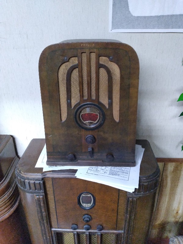

I knew the model number sounded familiar I had one , gave it to my in laws , they just wanted it for a shelf queen in their rec room.. I told them if it was just for looks to let me keep all the tubes , which I did ... I got a similar one but it is a 37-620 plays real good here is a pic of it
