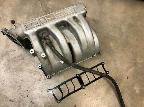

It's not for the rail, it's to go down into the left side of the intake plenum. It's the 6th bolt that holds it to the intake manifold. You can see the slot that the opening is in in this pic.
- intake plenum 5.0.jpg (65.08 KiB) Viewed 1630 times
Re: More Problems
Have you tried a T-40 3/8 drive bit with a 12" extension? Snap-On used to also make Torx bits in an extended version with 3/8 drive.
- Posts: 1975
Re: More Problems
A 3/8" drive won't fit the opening. It needs to be magnetic to place and remove the bolt.
