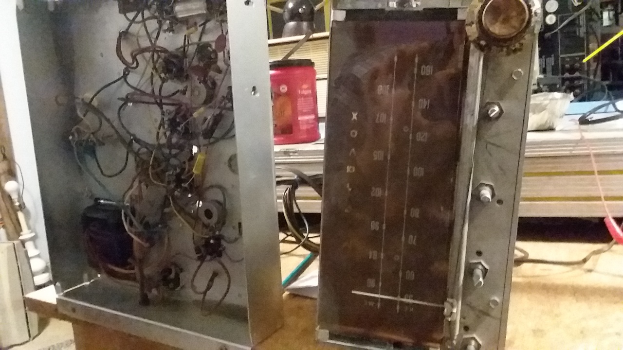

This is a thread related to 6EU7 subbed with a 12AX7. Because I have never seen one before, I was surprised to encounter three of these SE 6BQ5 models (!) last year. I paid $60 for the bottom one, assuming it had a 93-series amp- it didn't :roll: Another candidate for the (6EU7 conservation) conversion.
The other two pictured were brought by a customer. One blonde and one mahogany. I just finished the second one, so I figured a post was needed to identify these and the work needed for each. Ill just say that both had barely acceptable FM performance, even after alignment. But, even though there is no RF amp stage, the AM is on par with RCA - it seems to reject interference so well.

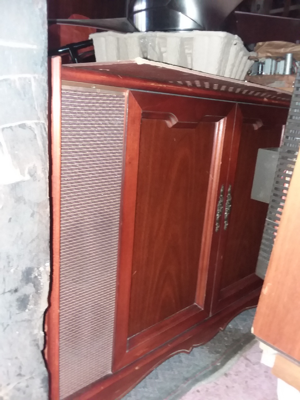

I would respectfully submit that the top two are 1960 models. "Concert Hall", model 1ST208F. I have not seen one in blonde before. The flat knobs and the Conquest changer are the giveaways. The bottom one is a 1960 Symphony with the AMP 175 amp. The 1961 models would have the S-600 changer and the 93 series amp.
Magnavox tube tuners without AFC, (middle of the 1961 model run) have variable FM performance. Some are fantastic, most are mediocre, and that is being charitable. They tend to not demodulate the FM stereo composite. Tuning to one end of the carrier or the other sometimes helps. A good FM oscillator, typically a 6EA8 is essential. Many times replacing the EA8 with a 6GH8A (note the suffix !) will help with FM drifting. A good antenna is essential as well. The definition of "good" varies depending on receiver location and station location. Tuner front end tube condition needs to be up to snuff. The AM side of the tuner, although basically an AA5 circuit with no RF amp, are typically good performers, loop antenna notwithstanding. You can add an external AM antenna to good advantage. I have three Magnavox stereos with AFC, all good FM performers. I have three Magnavox stereos without AFC. The CG is just okay. The Imperial is usually pretty good. The Symphony is not worth the trouble. I'm told tinkering with the discriminator improves performance in many cases, but such activity is above my pay grade. People who shelled out the big money for one of these things when they were new didn;t do so for radio performance. The record player was the big thing to Magnavox.

Yes, that 1ST228 looks like my1960 Symphony 1ST208 and I mistook it for one. Those "twins" are 2ST259.

I have to agree the record player and furniture sold the average Magnavox, so I make sure those changers are carefully detailed and cabinets clean. The amp and speakers are rarely an issue either, but the FM sure is and it seems not worth my time. The more I tinker, the less hope I have that any tiny improvement will be noticed.
How can the same tuner (yes, German made die cast FM tuner) used in a Motorola, Zenith or RCA perform so much better and with selectivity that matters most a with a dial ever more crowded. FM at the low end (below 92) seems affected disproportionately, which is where all the good stuff is :x .
The 6DT8/12DT8 or any dual triode; 6BQ7, 6AQ8, 6EA8 are all good FM tubes but IF stages may be where Magnavox lags the others.
While I do not advocate tweaking IF transformers by ear, the discriminator transformer may be the only one I do recommend you try a 1/2 turn excursion both ways. My experience is similar with my 1947 Berkeley and1960 Symphony where tuning "through" the strong (spread out) stations change clarity of audio , while the weaker adjacent stations are "swallowed up". If you adjust the ratio detector slug and tuner simultaneously, a sweet spot will be found.
