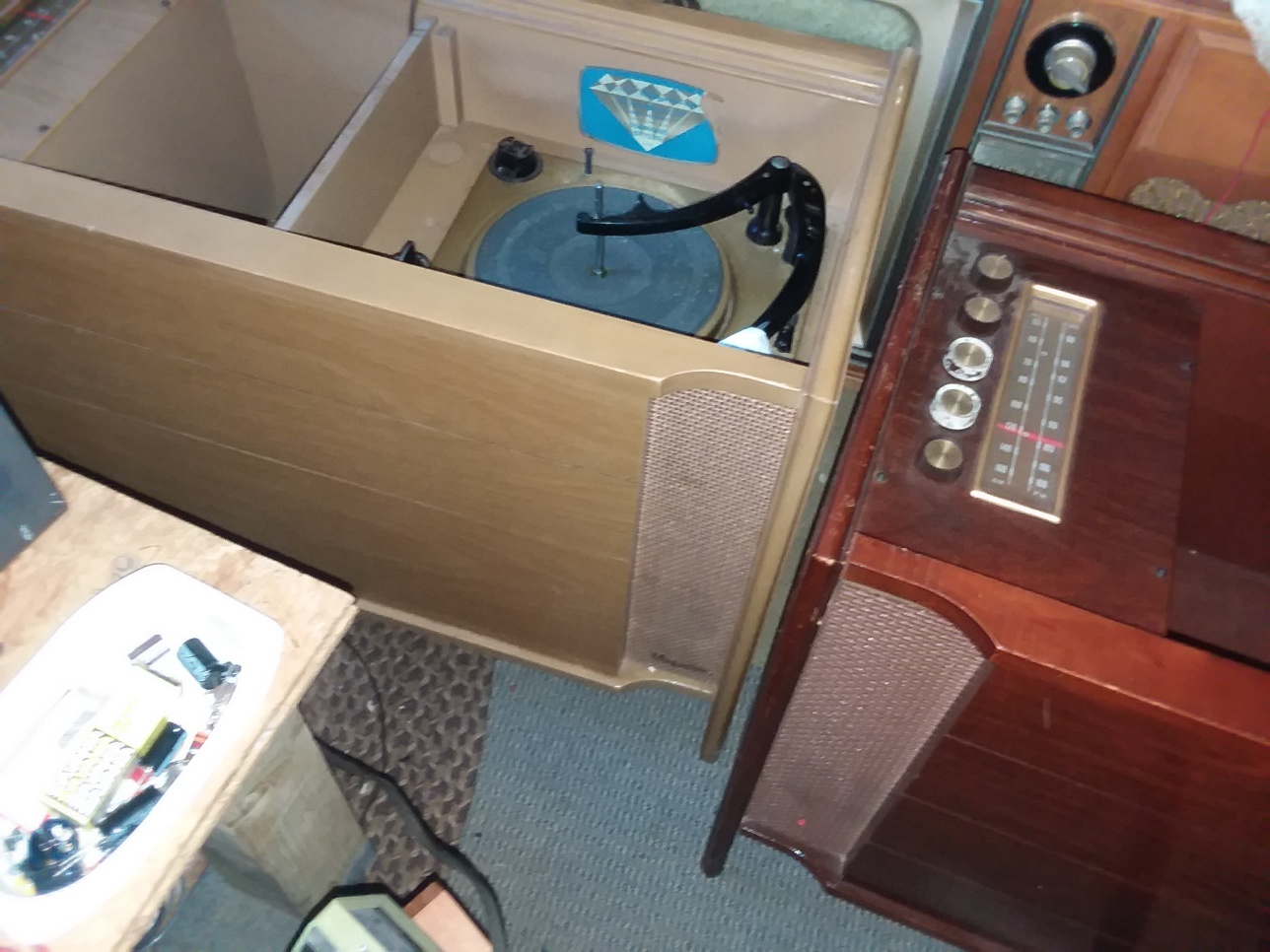

The other two pictured were brought by a customer. One blonde and one mahogany. I just finished the second one, so I figured a post was needed to identify these and the work needed for each. Ill just say that both had barely acceptable FM performance, even after alignment. But, even though there is no RF amp stage, the AM is on par with RCA - it seems to reject interference so well.
Magnavox 1961 smaller tube console

I would respectfully submit that the top two are 1960 models. "Concert Hall", model 1ST208F. I have not seen one in blonde before. The flat knobs and the Conquest changer are the giveaways. The bottom one is a 1960 Symphony with the AMP 175 amp. The 1961 models would have the S-600 changer and the 93 series amp.

Yes, that 1ST228 looks like my1960 Symphony 1ST208 and I mistook it for one. Those "twins" are 2ST259.

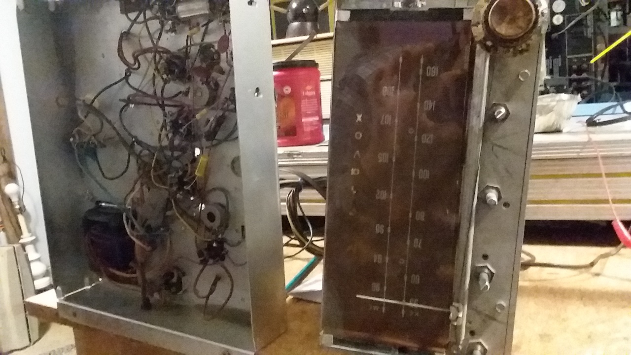

The 55-series tuner below needed almost no adjustments and tunes the full range 88-108, even though the scale is compressed below 94 MC. This tuner uses a 6CB6 RF amp and 6U8 oscillator/mixer.

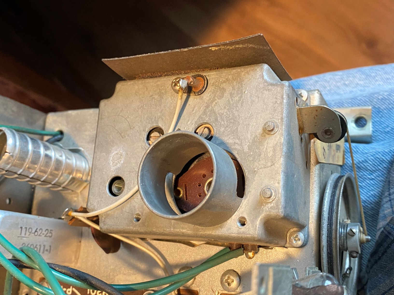

Inside those "pull string tuned" German tuners used by RCA and Magnavox, is a sloppy-soldered mini PC board and variable capacitors to align it. In most cases, these adjustments are at the end of their range, pointing to other issues.

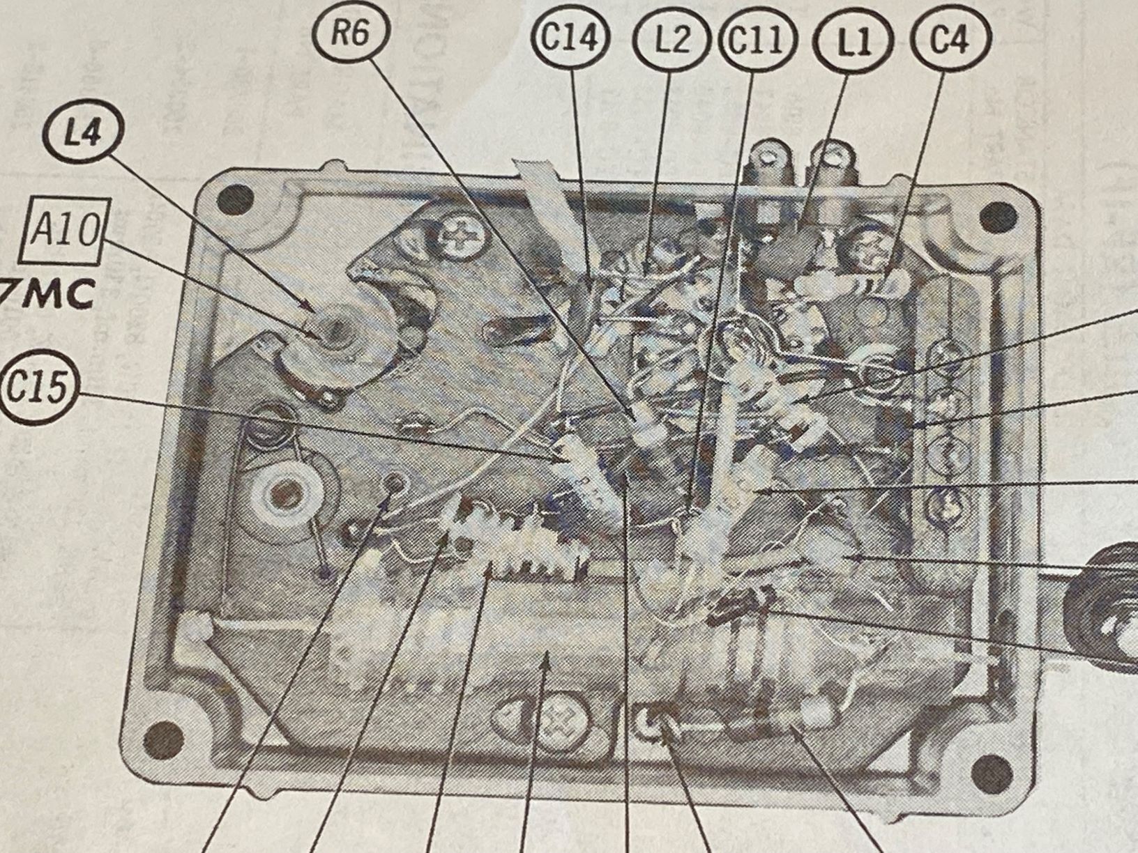

German-made FM tuner sub-chassis for 1961 is 59-series and with few changes, AFC was added to 79-series tuners (the 1962 version). Abandon all hope for that first picture, the second picture shows a 79 series exterior view, with AFC line to a feed thru cap on top. I do not recommend removal of this circuit board, unless a bad connection exists within that shell. I had to do that with a '61 RCA, same troublesome tuner
Comparing schematics, just the AFC diode, cap and resistor was added then a few surrounding cap values went down to compensate, twin-triode tube 6DT8. The diode allows a dc voltage sample from the discriminator* to "tweak" the oscillator. I just had to look these up, unsure of what I had posted earlier.
