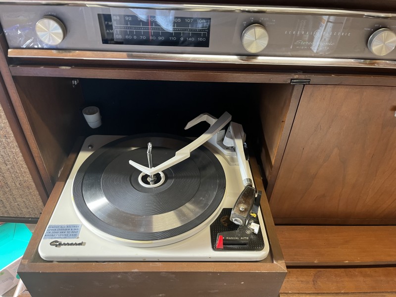

The Garrard changer appears to be an Autoslim-P model. It was sluggish but functional when I first brought it home, so I removed the changer and cleaned / lubed the pivots and bearings, and did a mild resurface on the drive wheel, and now it works as it should.

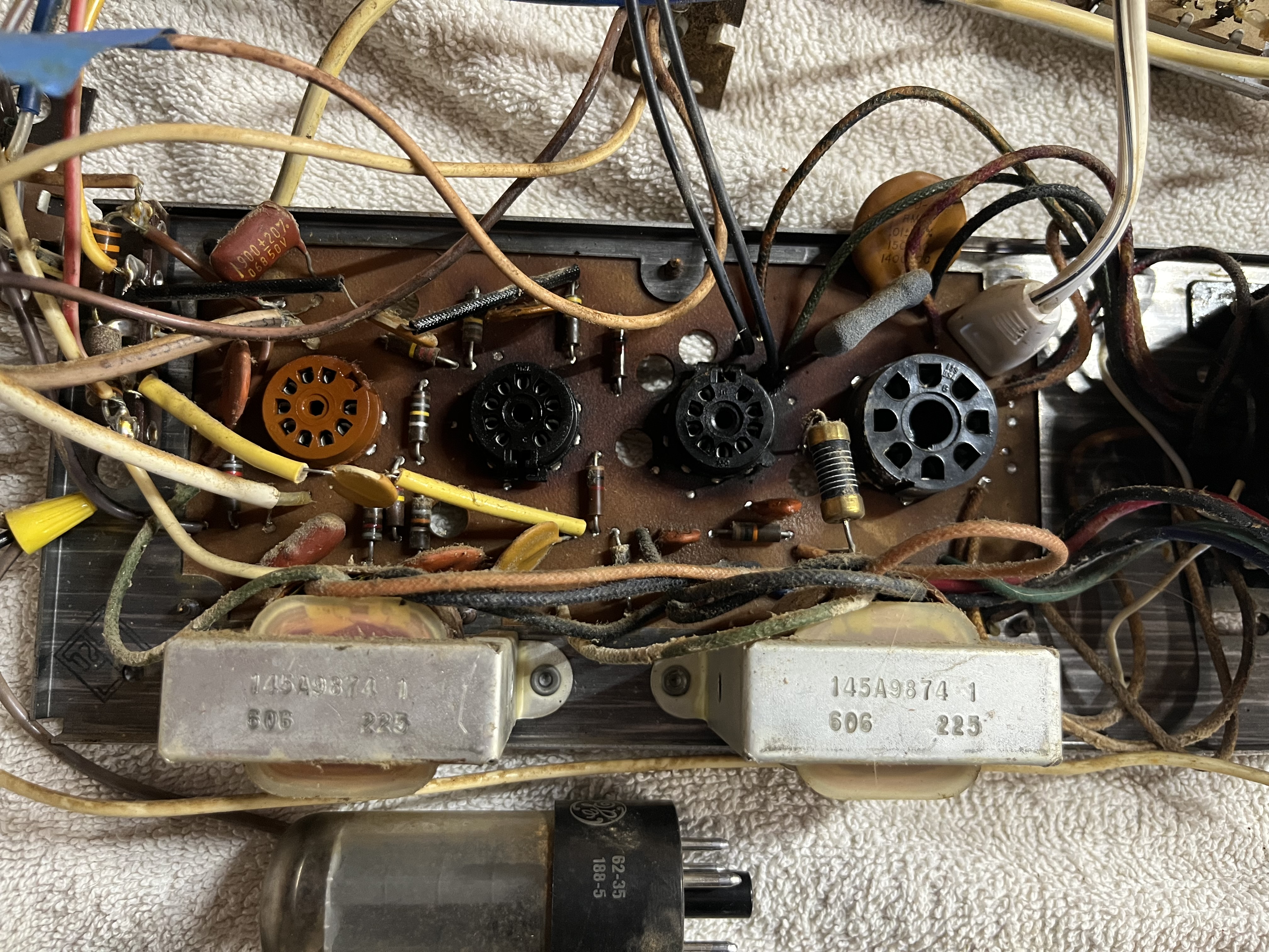

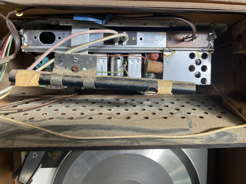

Here are a few photos of the inside. I've read the advice that the entire electronic assembly should be removed as one, due to the indiviual chassis being hardwired together. I'd appreciate any insight as to how to access the chassis mounting screws for the tuner. It appears to be screwed to the underside of the cabinet top, and the dial is screwed to the cabinet front. There is one screw hidden behind the tuner flywheel, looking in from the back. I'm not sure how to access that.
The amp board shows some darkening around the tube sockets. The board is also flexible enough to make me nervous about breaking traces while removing and installing tubes.

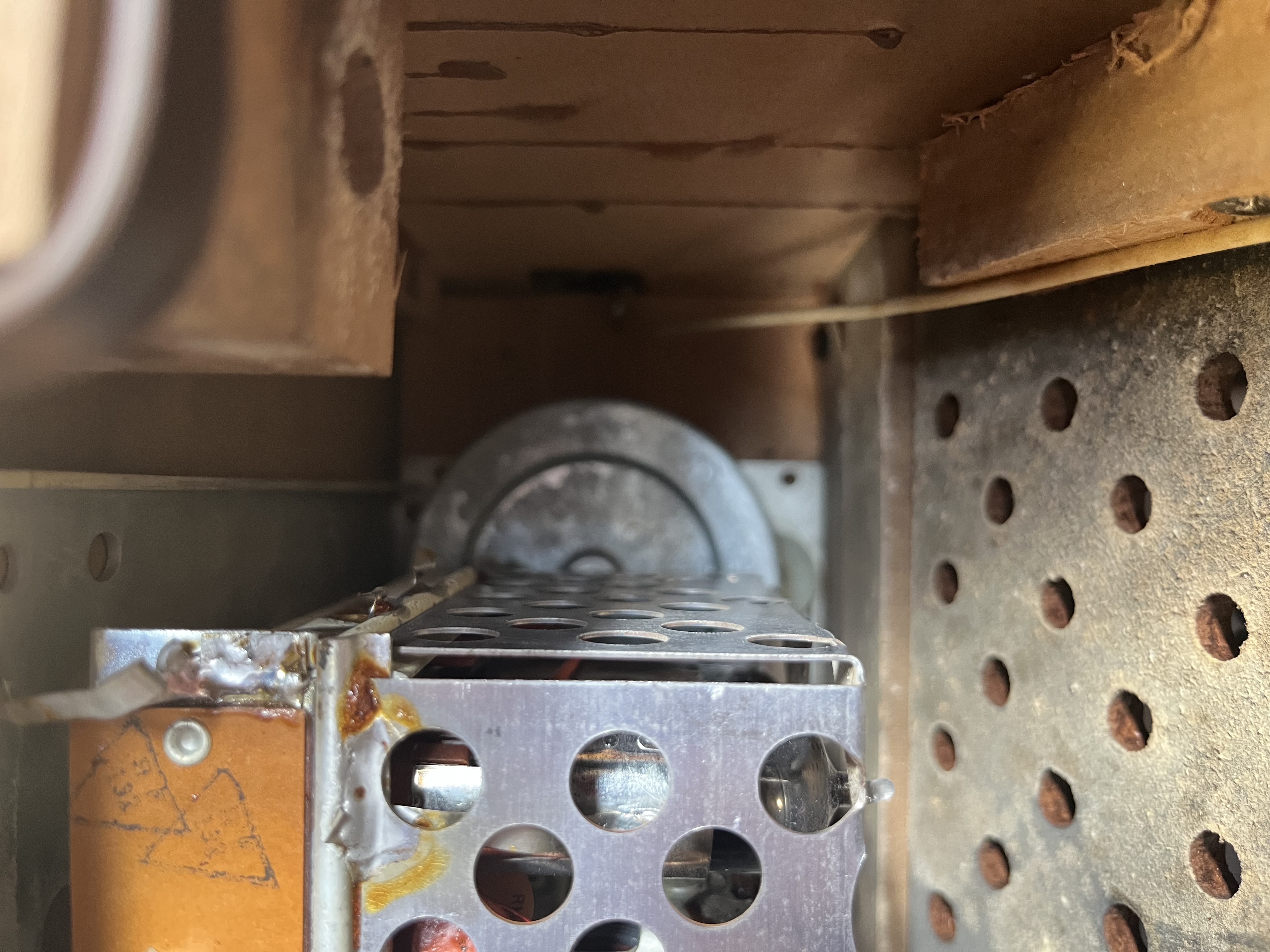

As it turns out, the screws that look like they secure the tuner dial to the faceplate are adjustable standoffs, so I removed two screws holding the tuner chassis to the top of the cabinet and the whole thing slid back. This after I (unnecessarily) removed a few cabinet screws and took the faceplate off.
d
Overall the tuner looks good visually. I'll post photos tomorrow and continue working to get the electronics out.

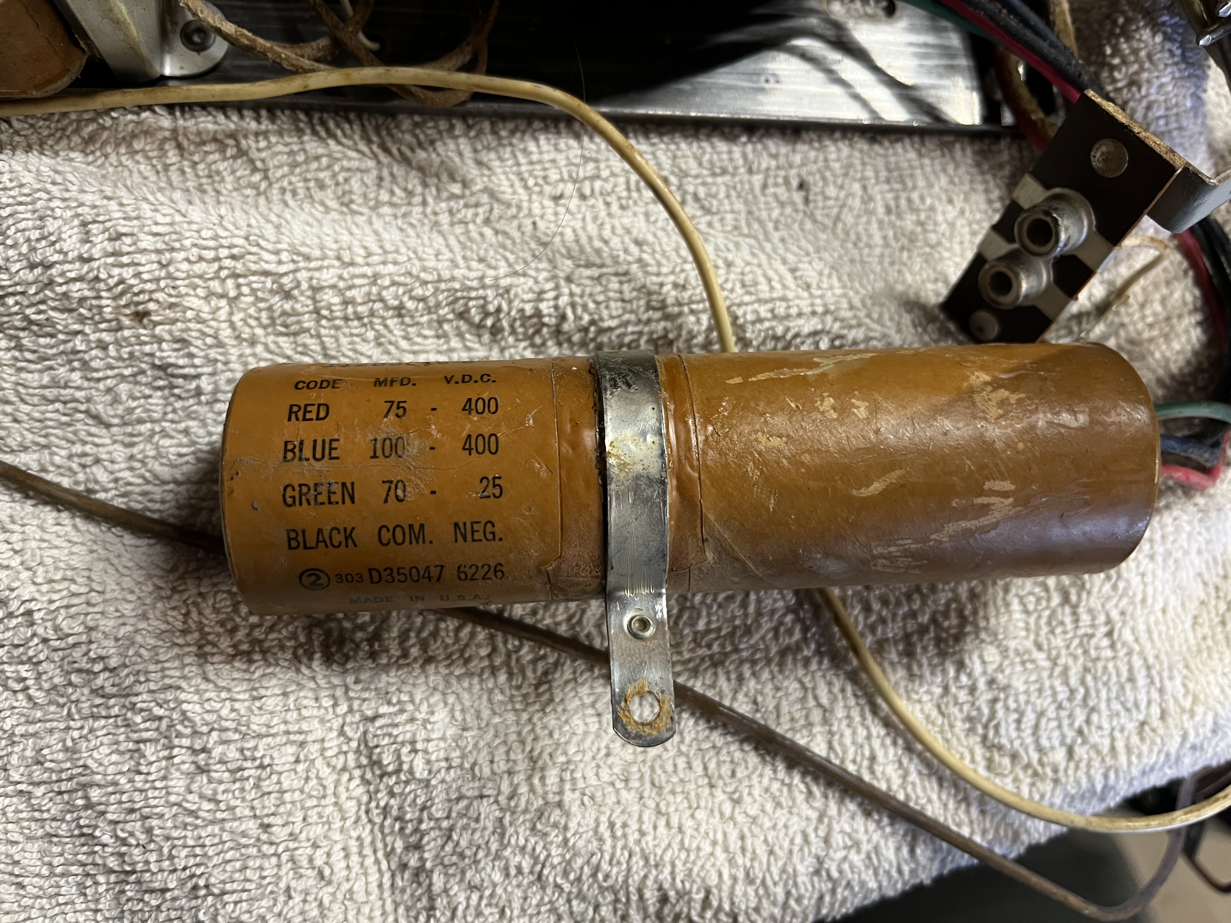

That big orange electrolytic capacitor that is beside the amp chassis is the first thing you need to replace. Like you, I fired up the one I was servicing for someone just to see what worked. Like you it fired up and played just fine, I did not have any sign of a hum which usually indicates the filter cap is bad. I turned my back for a couple of minutes and when I turned around the rectifier tube was bright red and the PT was so hot you could fry an egg on it. The PT survived but the rectifier tube did not. Be sure to add a fuse as you do your servicing. It will help prevent components from getting fried in case a capacitor shorts out.

Also, I do not plan to re-stuff the cardboard filter cap. Since it has long leads, my thought is to clip those close to the cap, then use them to connect to new Electrolytics, which I can mount on a terminal strip at the location where the bracket for the cardboard cap was. I know it won't look original, but are there other concerns with that arrangement?

The PC board around the output tube sockets looks typical for vintage PC boards. And, as far as I am concerned, and that is what I did on the one I serviced, use the long wires, terminal strip, and attach the new electrolytic capacitors. I would also do what is necessary for the can cap on the tuner and I believe the consensus is correct with the selenium rectifier. Check your resistors for drift and if there are any, I don't remember that there are, replace all paper caps. And, don't forget to install the fuse. You are making progress, and I hope you are having fun in the process.

You have a later model of that amp chassis, since it had bakelite or plastic tube sockets rather than the older phenolic ones that fried and caused trouble. That would have to be a plus. Have you measured B+ on the tuner chassis with the selenium in place? If B+ is low, that might be a cause for the drifting. I think I'd check that so I'd know where I was if the drift was still there after repair. I would also HIGHlY rocommend replacing both filter caps with 100uf @450 VDC and the cathode bypass cap with 100uf at whatever voltage you have handy above 50 volts. Increasing the output filter cap to 100uf will eliminate the engineered-in hum in that amp chassis. Increasing the capacity of the cathode bypass cap will help enhance bass. Bill's recommended method of mounting filter caps in that chassis is the preferred method. As a wise man once said, "don't forget the fuse"........
Those amp chassis are known for poor ventilation. When you test the tubes, let them get well warm before you test them. The 12AX7 is especially important. Those tubes run screeching hot, so testing them that was is the only accurate way.

You answered my next question...I'm having trouble sourcing a reasonably priced 70mfd cap for the cathode bypass on the 7189s, so I wondered if going up to 100 would have an adverse effect, other than increasing the frequency response range. Falling back on my guitar amp experience, a "fully bypassed" cathode isn't always a good thing, since the bass can get loose, but then guitar amps are intentionally pushed into distortion, which is not the goal with a hifi amp.

So far I have replaced the filter caps and the power tube cathode resistor bypass cap (the three that are combined in the cardboard tube), and added an inline fuse right behind the interlock.

I did clean the sockets and pins on all the tubes, and in spite of the browning around the tube sockets, I didn't see any cracks or other distress in the substrate or the traces. The old tubes seem to work fine, so i'm going to ride them until they quit.
