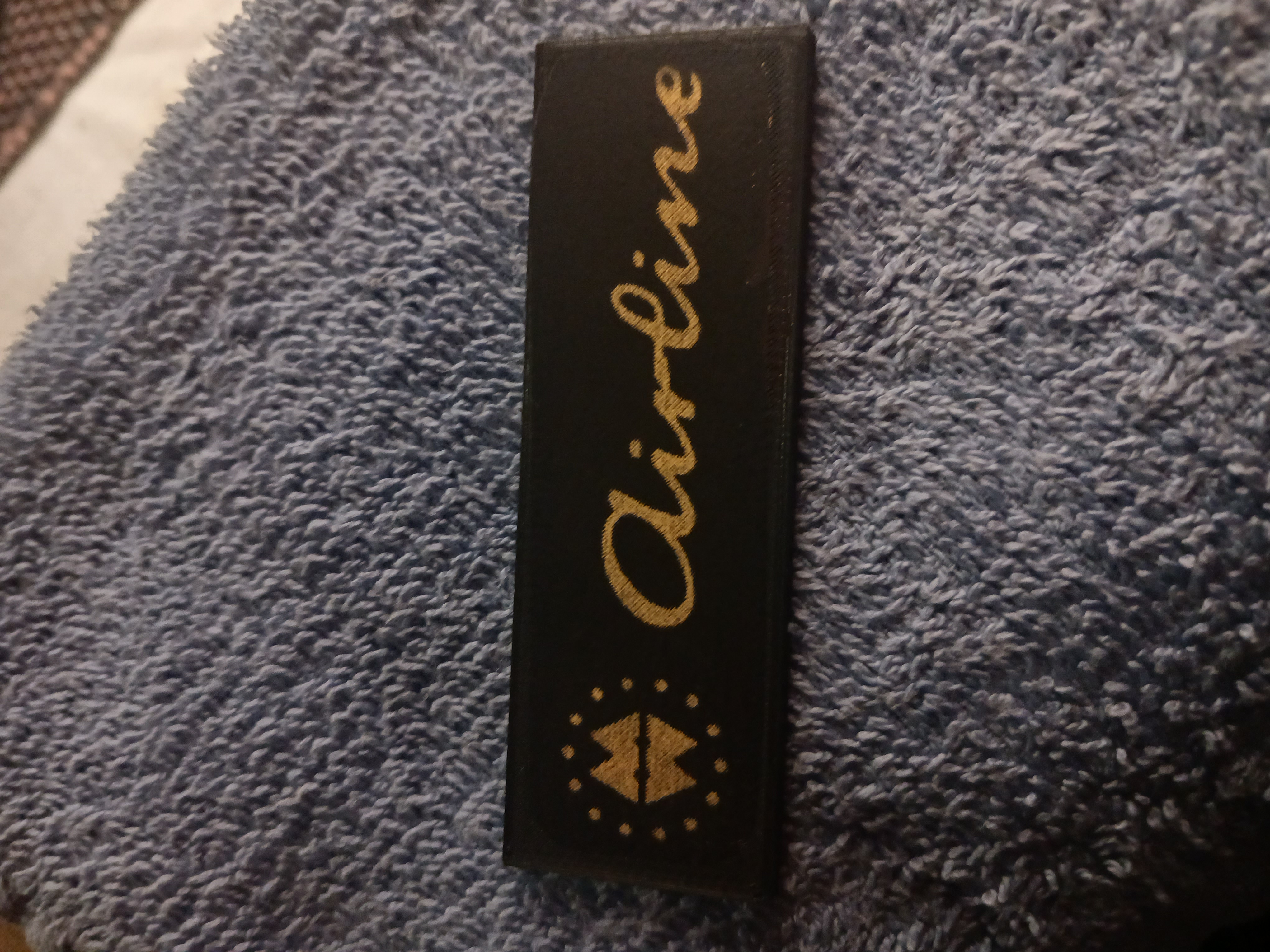

Post: # 23507Post hermitcrab »
Here is the finishing touch... I 3d printed the plate for the logo ,then I made a decal from the script on the radio bezel that I took a picture of , this will get glued to the speaker grille ... now it's done :)
Posts: 3742
Re: New project...
Post: # 23508Post TC Chris »
Nice finishing touch!
