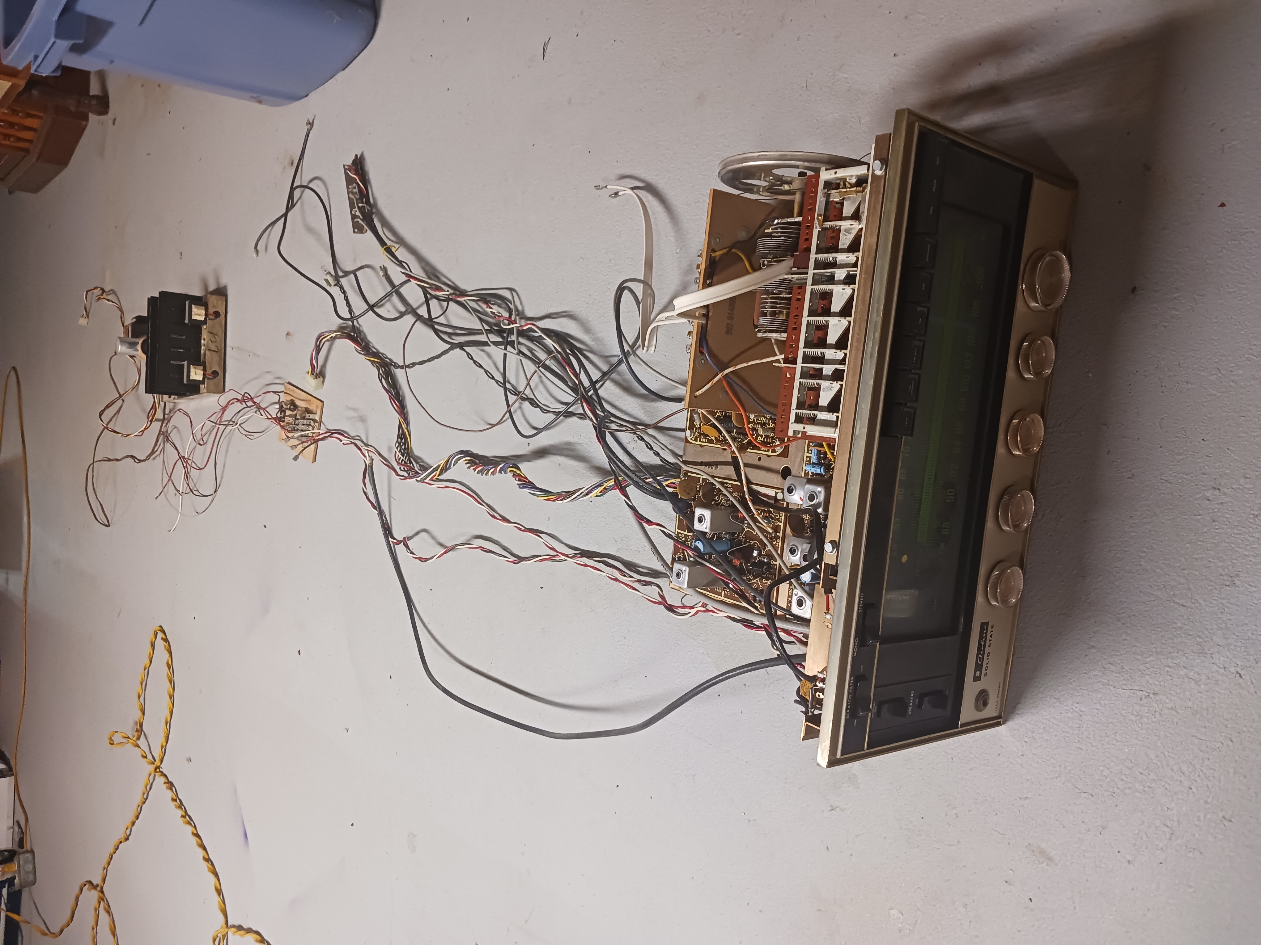

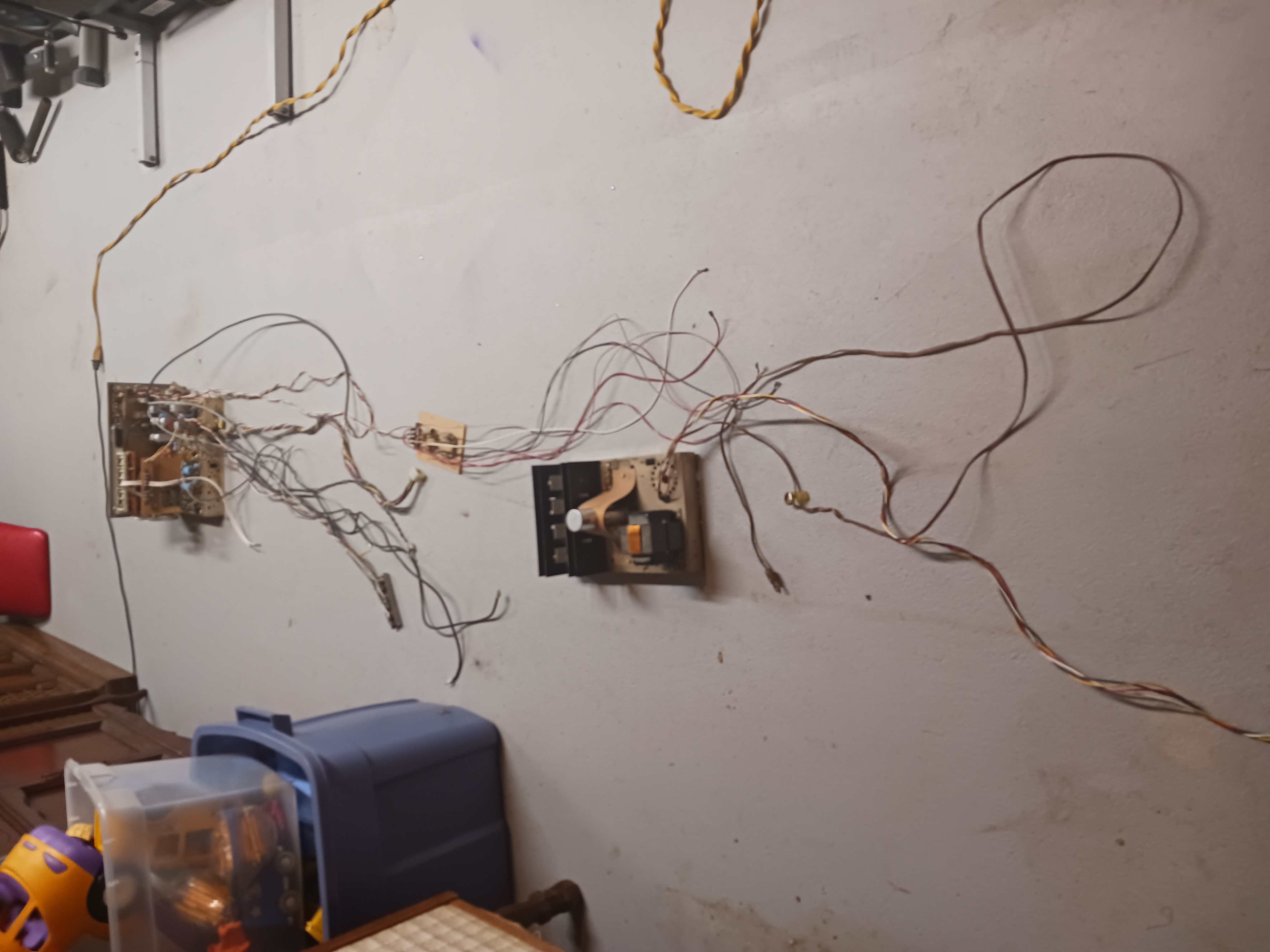

I got a line on some free oak and maple from a co-worker that has 40 acres of rough sawn planks of 5/4 ... so...I am going to try and build another console , this time out of the Montgomery Wards guts I picked up last year. All I have to do is figure out the spaghetti mess of wires and where they go and try it out first to make sure it works .... the guy I got it from claimed it did, and he meticulously removed all the wires and connections without cutting anything ...so I will attempt to interconnect the chassis on the floor and see if it is alive ...I will place everything on cardboard to insulate me since I am grounded in the basement ... then the fun starts ...

It will probably still be in working condition. It might need a tune-up. That sounds like a fun project and a worthwhile way to save a set of electronics. Make sure to share pictures as you go along. Good luck! :D :D

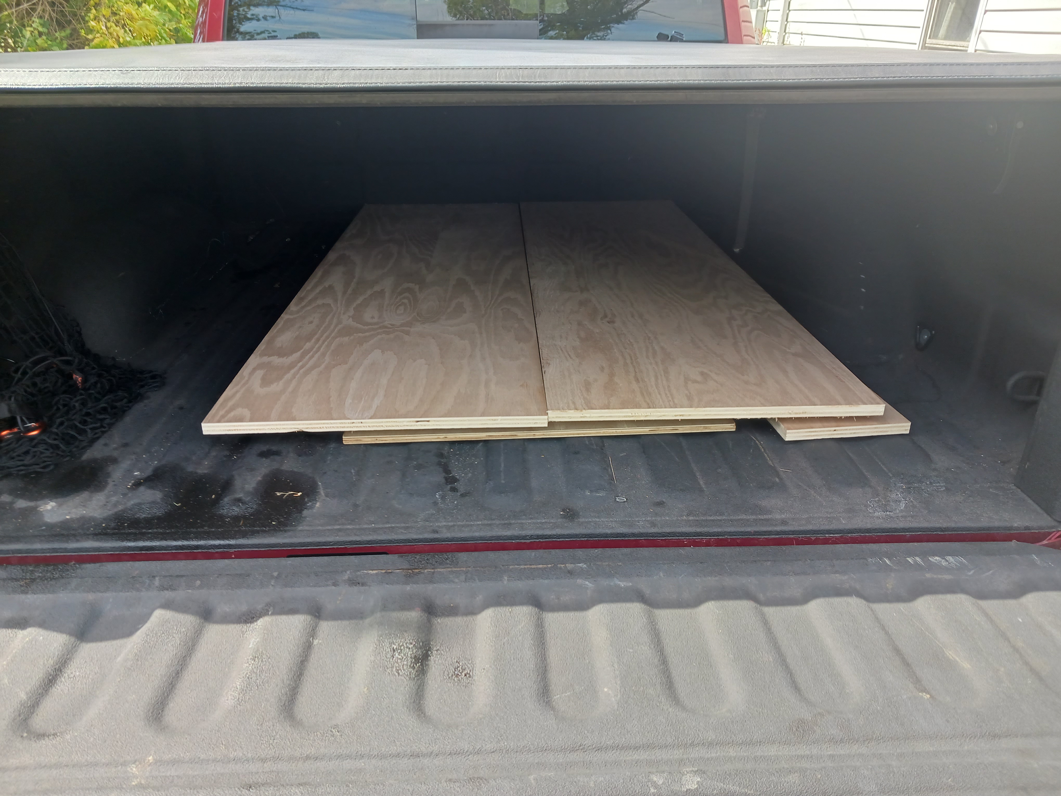

secured the wood ... now to make a bunch of sawdust... :D

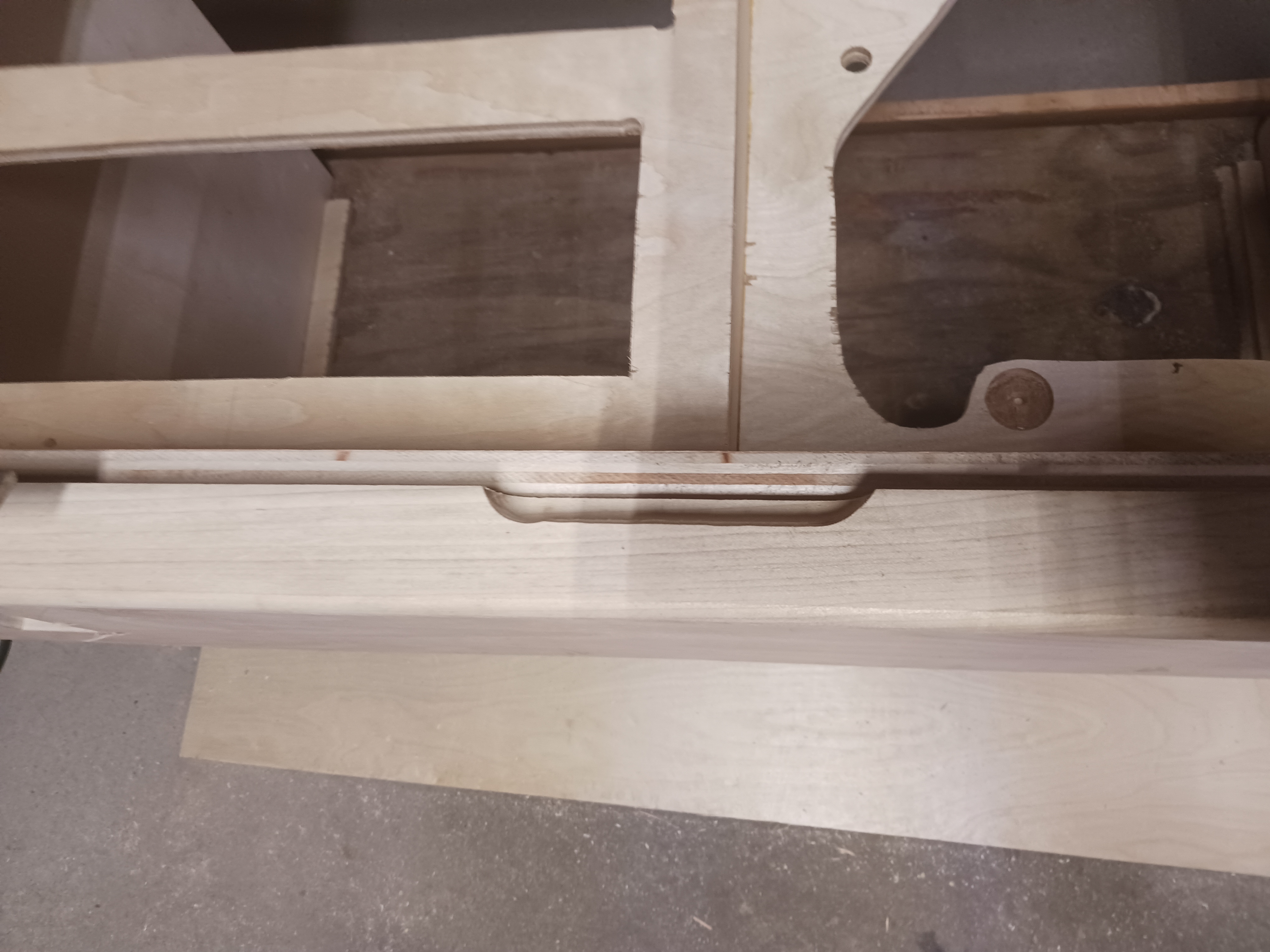

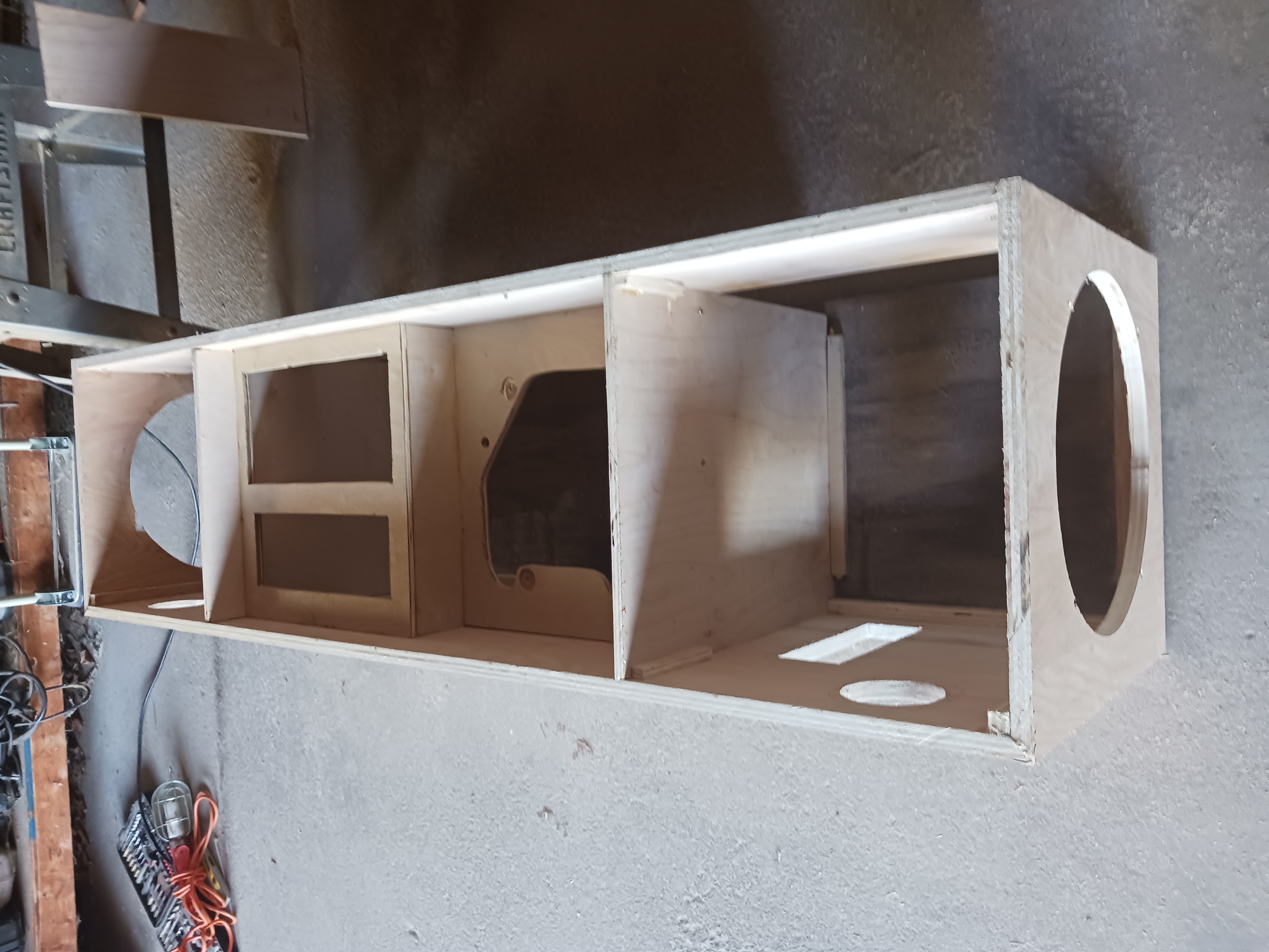

Post: # 23059Post hermitcrab »
William wrote: ↑Sun Sep 29, 2024 12:18 pm What cabinet style did you pick?

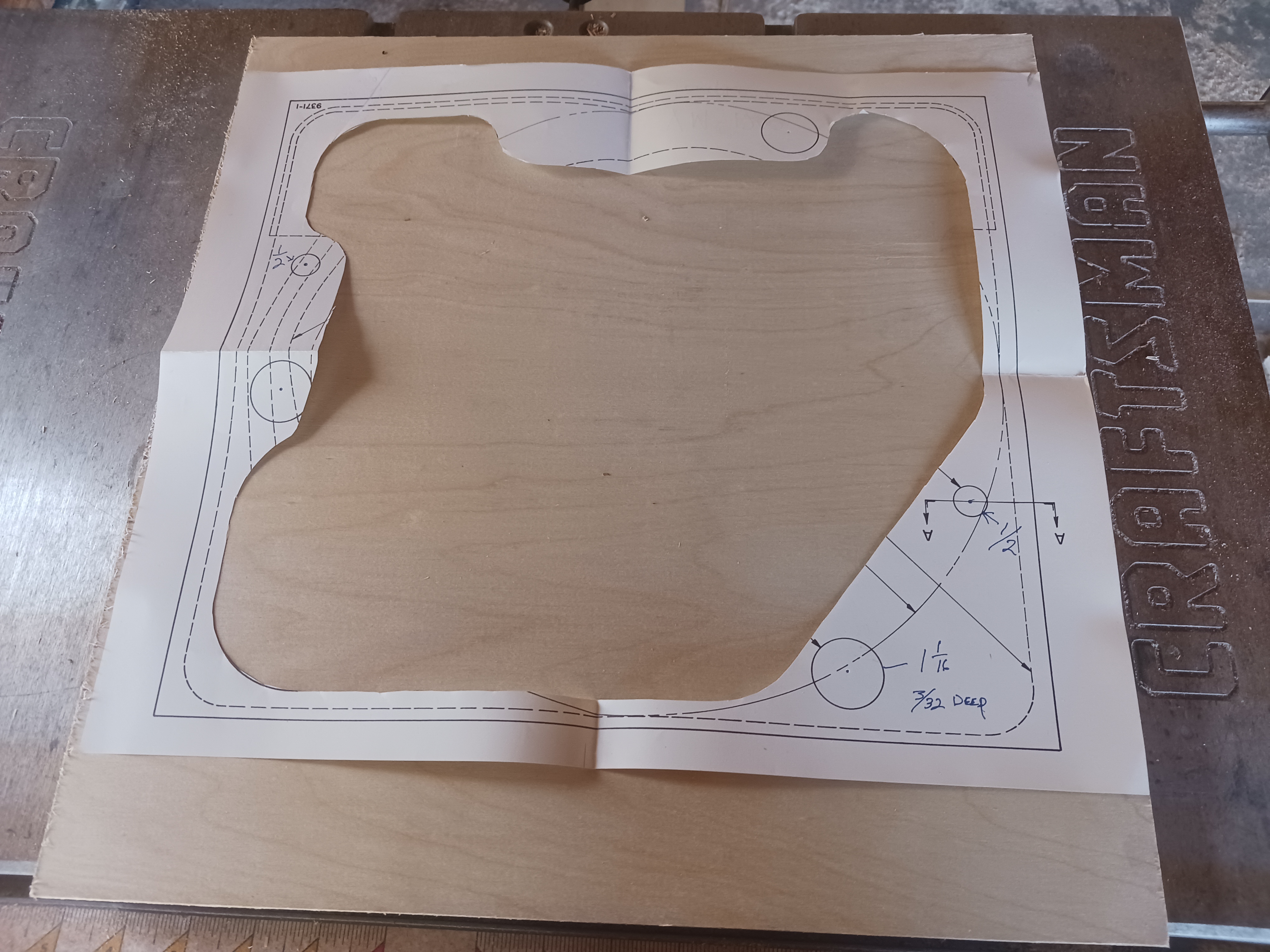

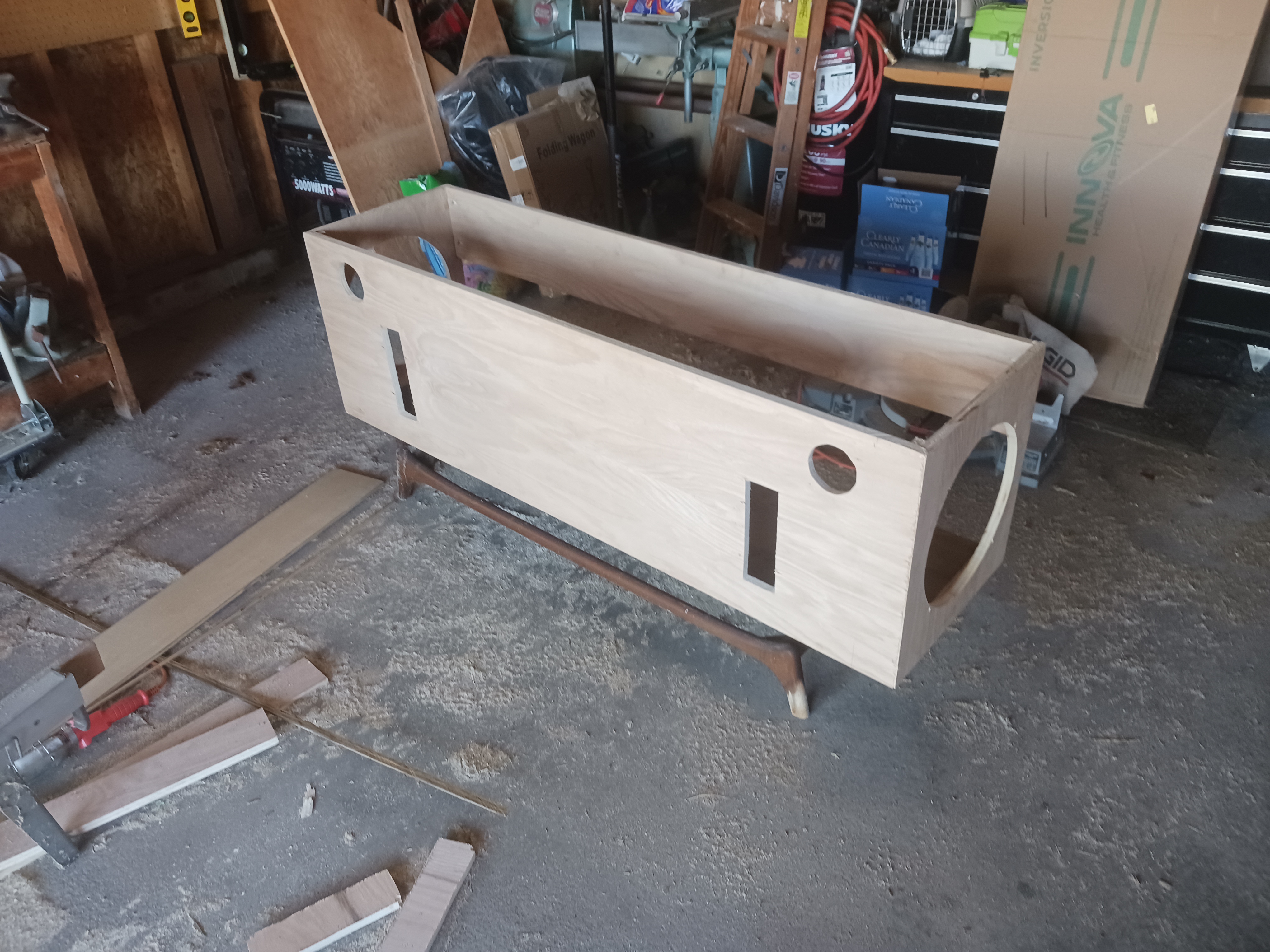

The carcass is glued up and screwed , cutting the template for the changer , and the radio head ...I went the normal cabinet route, I was thinking about replicating the Magnavox upright models , but this thing has 15" woofers so I wanted some separation... this will be a lowboy window seat style total height is only 28" and to shorten it up I did the woofers on the ends like Magnavox she is 65 " long , my plan is to make louvered grilles for the speakers ... that will take a lot of time ..the legs are from a gutted out RCA, I have had in the rafters for a few years

Looking good, Elton, and this must have 6 speakers?

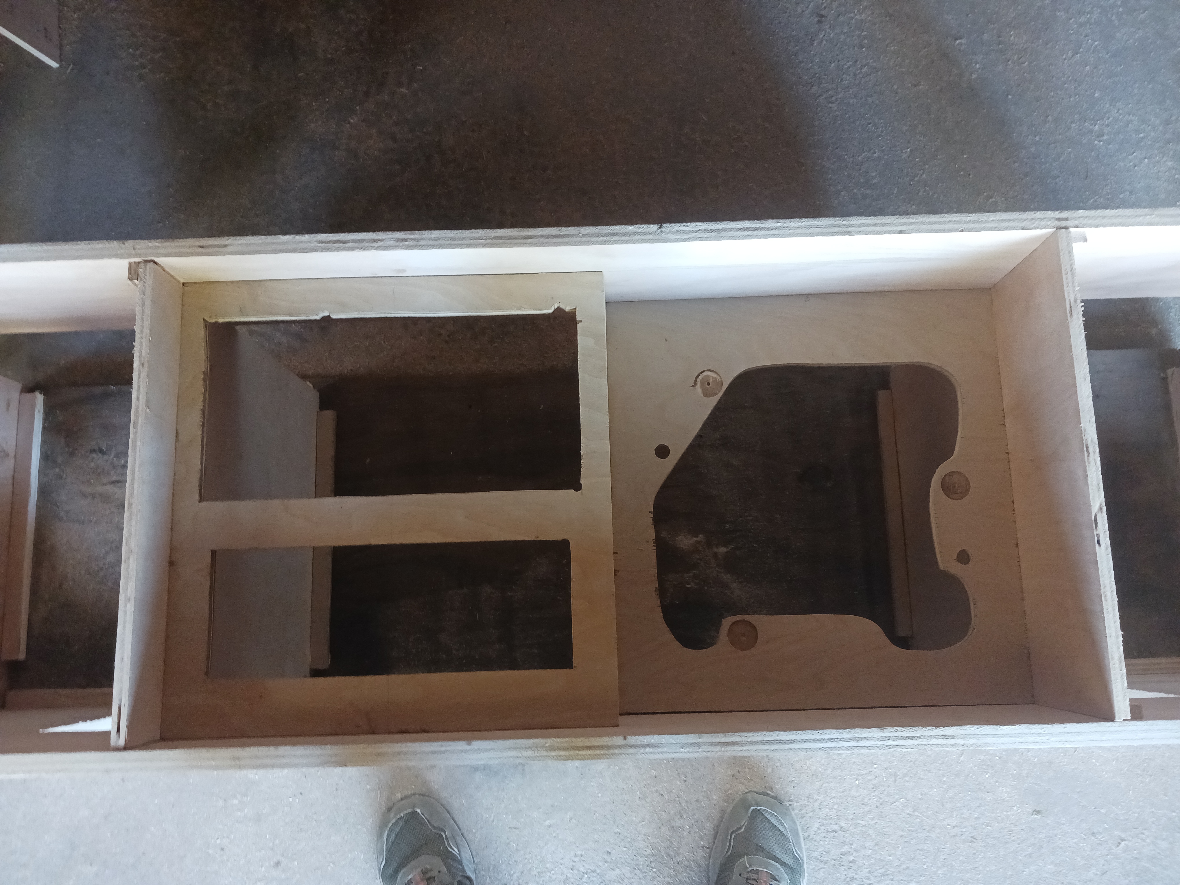

Post: # 23087Post hermitcrab »
William wrote: ↑Sun Sep 29, 2024 11:55 pm Looking good, Elton, and this must have 6 speakers?
Hi bill , yes 3 speakers per channel , sort of like a Magnavox 15' woofers, 4x10 mid horns, and 4" tweeters... and this as an additional driver stage , instead of 2 preamps then power amp this has 3 preamp stages ...I got the internal structure , plinth and radiohead mount installed... the radio was hard to cut... there is only like 1/4 clearance around the electronics and to leave enough for the benzel to sit on the wood... the other hole beneath it will be an album holder ...

You have done the one simple thing that Magnavox usually didn't--you have isolated the speakers from the record changer.

Magnavox used a Masonite shelf between the speakers and the record changer.

Elton, did you ever determine who built this unit for Monkey Wards? Looking at the chassis laying on the floor it was not a cheapy.

Bill, it was built by Wells Garner... but some of the individual PC boards in the chassis look like magnavox clones, the same type of PC boards and the stenciling on them and components used , almost looks like a Magnavox R-402 chassis ... but it could have been the standard of the day :?: I determined that the power amp was mounted on it's side as the mounting holes are on the bottom of the chassis... that would account for the big cardboard support around the main electrolytic cap being used

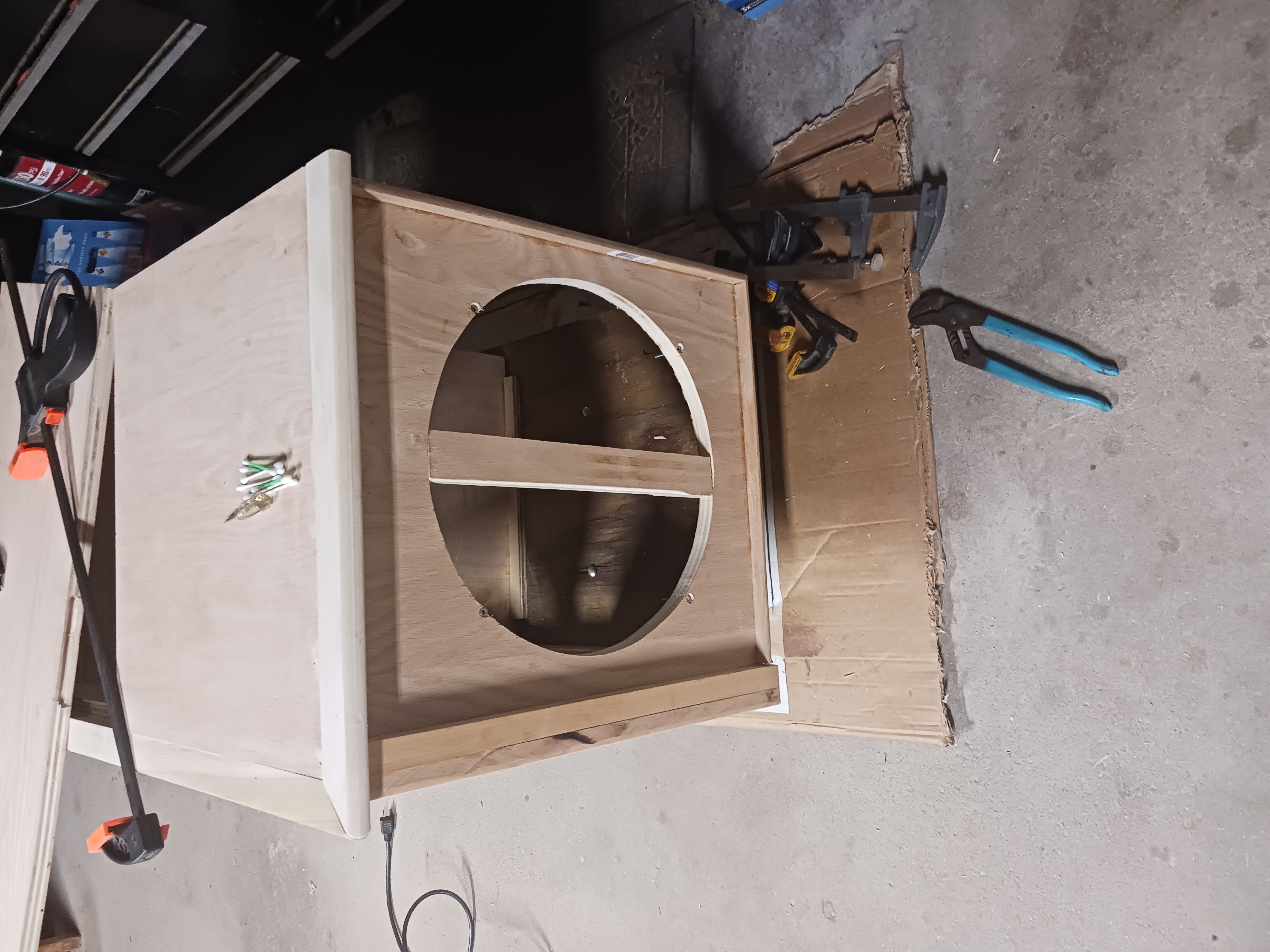

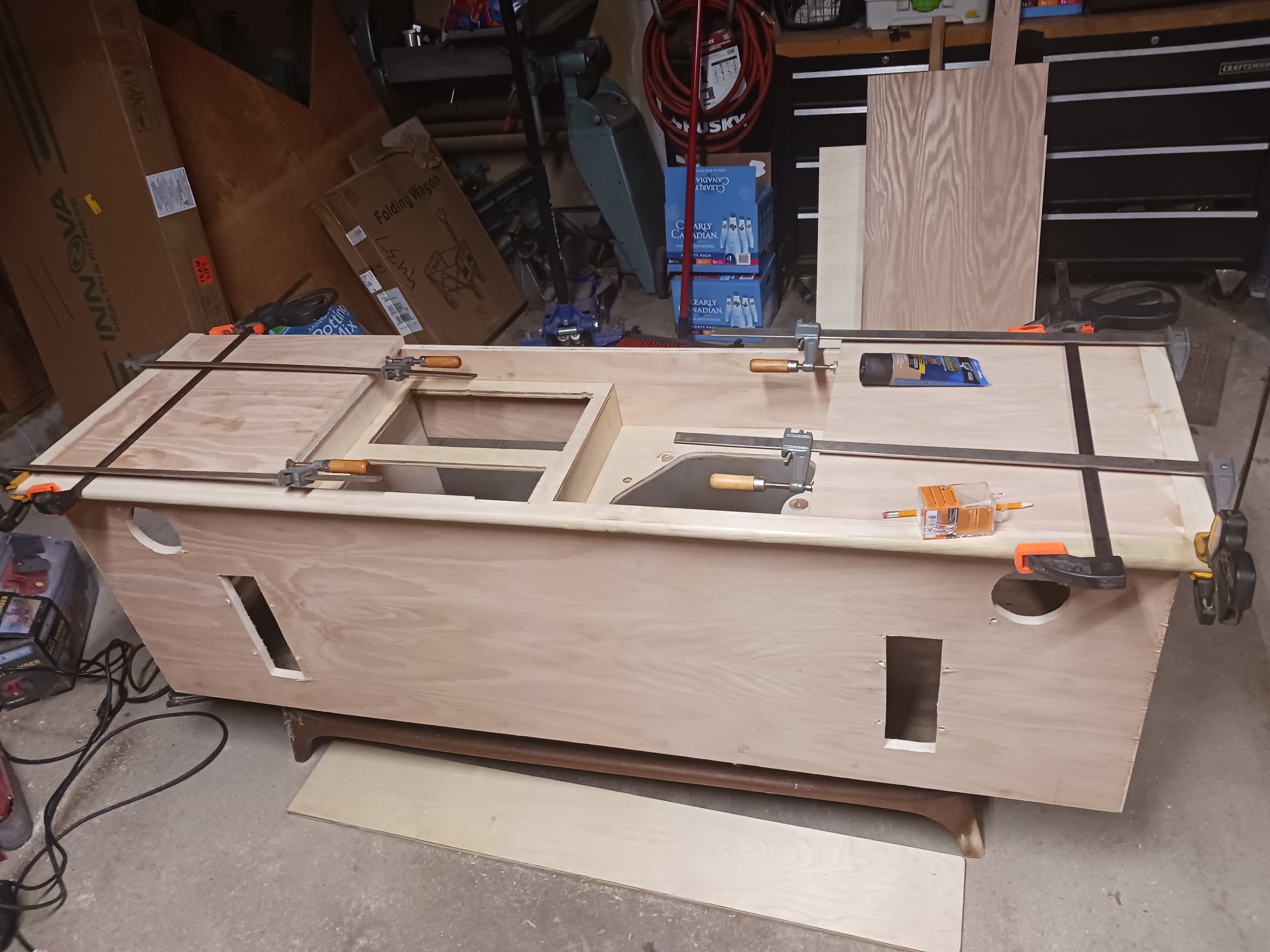

Post: # 23128Post hermitcrab »
The top is glued up... I went with a center open lid design like RCA/Motorola

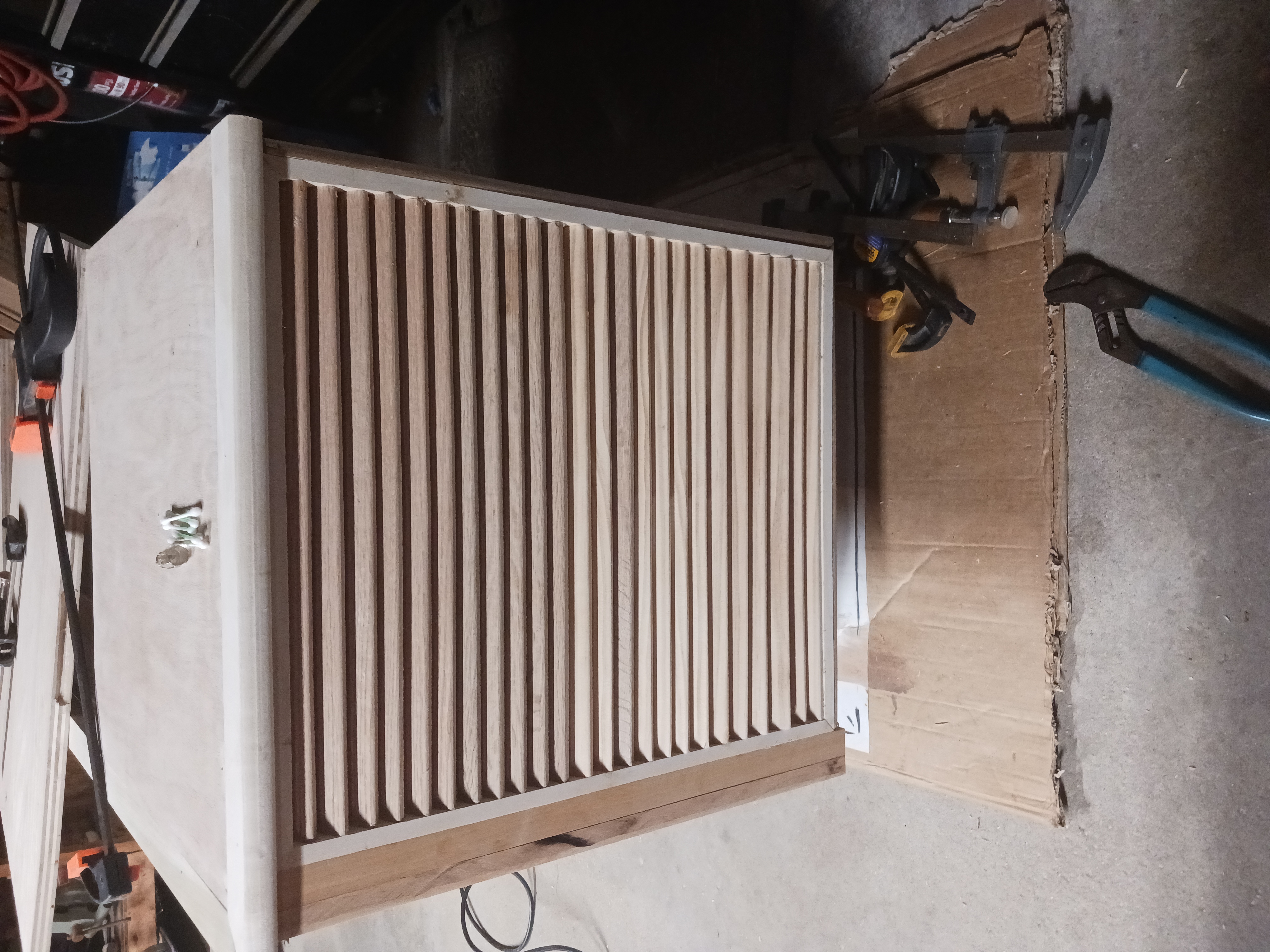

Post: # 23139Post hermitcrab »
Speaker grille... 3 more to go

Post: # 23140Post TC Chris »
Nice work so far. Lookin' good.
Posts: 5462
Re: New project...
Post: # 23142Post William »
Louvers, that is cool, Elton, nice job.
Posts: 9029
Re: New project...
Post: # 23144Post electra225 »
Nice work! The louvers are impressive! :D :D
