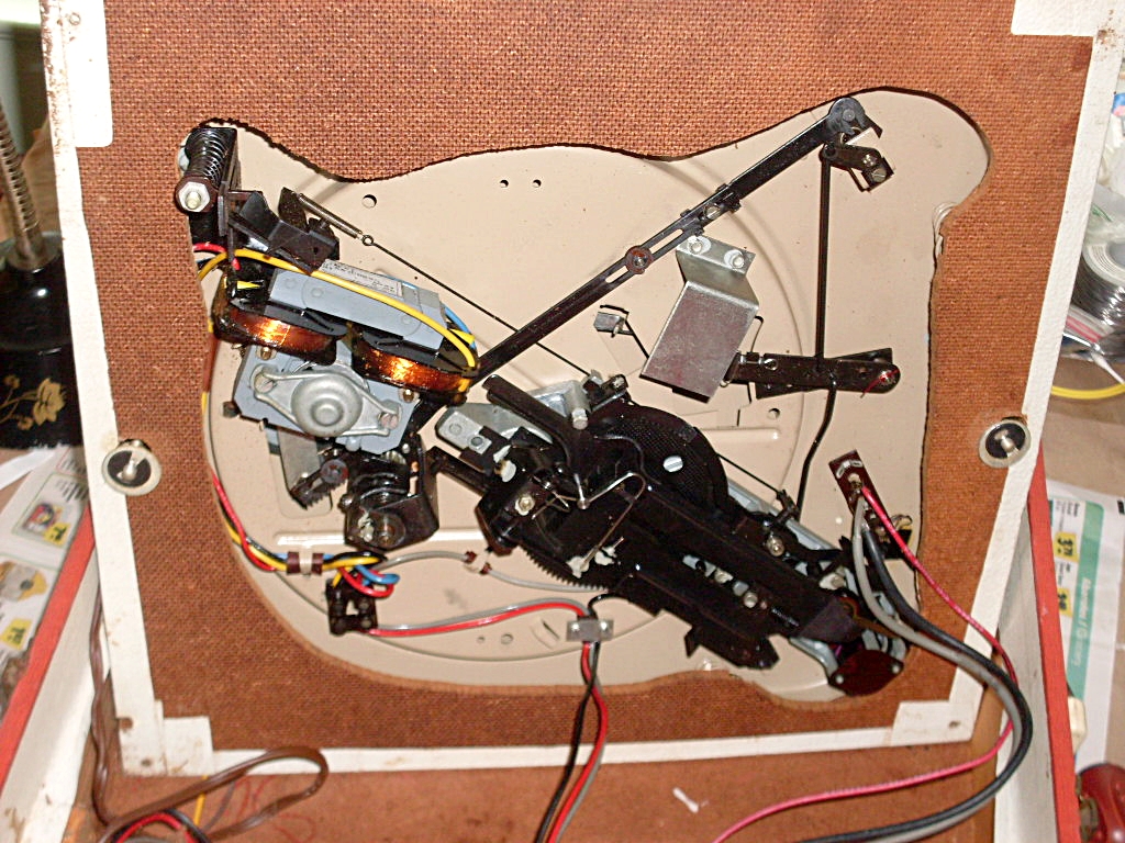

Yesterday, I removed the motor and cleaned it.
An easy process w/o any manual.

Is the motor European voltages and does it just look funny compared to American motors?
- Posts: 8921
Re: Telefunken TW501
To these untrained eyes, the mechanism of that changer looks substantially like a VM....
- Posts: 1345
This is a U.S. Sylvania stereo. Telefunken Motor is 120 VAC.
You can see the motor in the photo.
The windings are more exposed, but all else the same.
Telefunken, Perp-Ebner changers were also used in export models
of Grundig and Telefunken consoles to U.S. with dual 120/240 VAC.

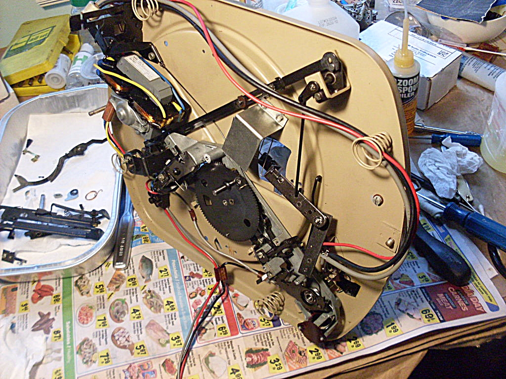

I was able to free up the control shaft assembly, using
solvents and butane lighter heat.
Again took much longer than anticipated.
The control shaft connects to a two piece shut-off rod.
This necessitated partial dis-assembly of the rod, so
I could hook the bottom rod into the control shaft's
connection opening.
You can see the rods before and after in photos.
On a V-M 950, the shut-off rod is one single piece, and you
can dis-connect it from the On/Off/Rej knob to
make it easier to re-connect to the control shaft.
Last night the cussing hung in the sky for some time !

- Posts: 8921
It looks like you are making good progress now. Thanks for sharing that project, Mr. Mogul....

One oddity I discovered is that apparently, this changer does not
play records manually.
When I turned the changer to "ON" position, it set about
going through the auto cycle.
I asked Gary at the V of Music, and his opinion was that
these models only played automatically.
- Posts: 8921
Interesting! Perhaps the "automatic play only" feature makes the mechanicals less complex? Thanks for sharing your project, Mr. Mogul. It takes time to document and post pictures. Your explanations are thorough and informative. I appreciate that....
