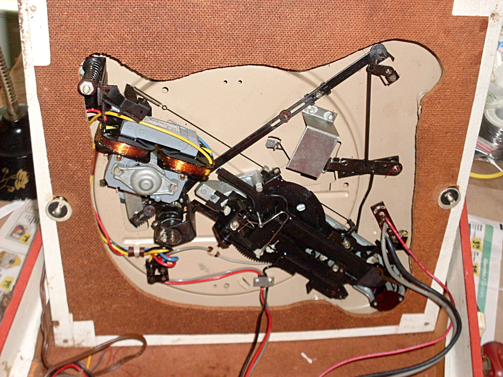

Yesterday, I removed the motor and cleaned it.
An easy process w/o any manual.

Is the motor European voltages and does it just look funny compared to American motors?
- Posts: 8921
Re: Telefunken TW501
To these untrained eyes, the mechanism of that changer looks substantially like a VM....
- Posts: 1345
This is a U.S. Sylvania stereo. Telefunken Motor is 120 VAC.
You can see the motor in the photo.
The windings are more exposed, but all else the same.
Telefunken, Perp-Ebner changers were also used in export models
of Grundig and Telefunken consoles to U.S. with dual 120/240 VAC.

One oddity I discovered is that apparently, this changer does not
play records manually.
When I turned the changer to "ON" position, it set about
going through the auto cycle.
I asked Gary at the V of Music, and his opinion was that
these models only played automatically.
- Posts: 8921
Interesting! Perhaps the "automatic play only" feature makes the mechanicals less complex? Thanks for sharing your project, Mr. Mogul. It takes time to document and post pictures. Your explanations are thorough and informative. I appreciate that....
