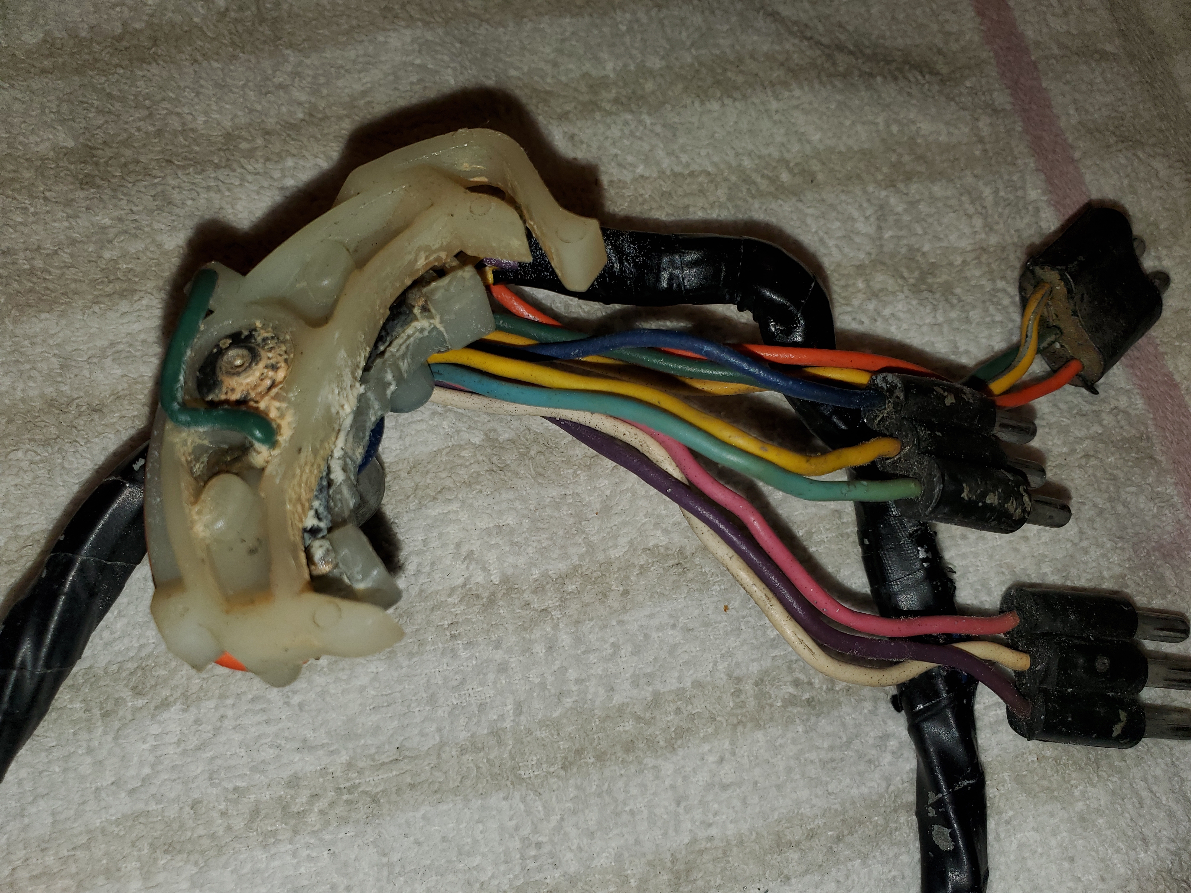

Post: # 17681Post electra225 »
This little episode reminds me of when I was restoring cars. Packard Torsion Bar ride may be the best example. Learning, in detail, about something I should already know.
I dug in my top-secret box of '63 Buick goodies left over from the restoration and found a correct, correctly coded R63 turn signal switch. It was all grubby and nasty, fresh from the junkyard. There is a series of nine terminals, six of which are arranged in a pyramid fashion, three of which are under the six in pyramid fashion. These three terminals are for the cornering lights. The six in pyramid fashion are arranged in three rows, one on the top, two under it, three under that. The top one is power from the stop light switch, the two under that is for the stop lights, left and right, the three under that are: the outer two are for the left and right turn signals, the middle one is power from the flasher. I tested the switch before I did any cleaning and found its operation to be intermittent, particularly the stop lights. I bought a can of cheap contact cleaner at a parts store and used about half of it getting the switch clean electrically. I gave it a spritz of WD-40 then retested. I have good operation with a good detent at "neutral", neither toward the left or right signals, but in the middle for stop light operation. I don't see why this switch won't work just fine, providing I can get it adjusted properly.

Nope. Not even close. The one you pictured would fit a '65 and newer Buick thru 1968. It would mount under the steering wheel. Mine mounts down further on the column, 15 1/2 inches from the steering wheel. I'll snap a picture of it. The switch that fits my Buick might fit your '62 Cadillac.

Post: # 17773Post electra225 »
Okay, guys, now we can add Buick turn signal switches to the list of crap I get involved with repairing. But, I have to honestly report success! YEA!!! It's only been ten years trying to get those stupid stop lights to work. It was a dirty turn signal switch. Simple as that. I have working stop lights and working turn signals, both sides, front and rear. The cornering lights don't work, so I need to troubleshoot that system. I know the switch is good. Either I don't have power or I have two bad bulbs, both possibilities. I don't have it adjusted 100% correctly, but they work and that's all that matters. I'm not going to mess with progress. It is a LOT tighter under the dash of that Buick than I remember it being, for some reason...... ;) :oops: :roll:
So, to all you Cadillac and Buick guys, the skinny is that the switches for Buick and Cadillac are the same and suffer from the same maladies. The guy who semi-sort-of did the troubleshooting on the Buick said that used or NOS switches would not work, that he had to custom-build switches and wanted $1200 to do that. Horse feathers! And he told me that the cornering light harness was missing. It was plugged into the turn signal switch just like it should have been. Where he got that, I'll never know. I put my spare switch into the car after I "rebuilt" it like we do for switches in electronics. As long as the cable is known good, and the switch is known good, it will work. Adjustment does not appear to be critical. Big Buicks, Riviera, and Cadillacs with the exception of the 75 series take the same switch. I'll bet Olds uses it starting in 1964.
Even a blind hog will find an acorn eventually....... ;) ;) :oops: :oops: :roll: :roll: :lol:

Post: # 17958Post electra225 »
I like trivia, but I also like to get bogged down investigating things that I have already fixed. The shop that worked on the Buick told me that they have to custom-make turn signal switches for 1963-'64 Cadillacs and Buicks with tilt wheel because OEM, whether NOS or used, will not work. This presents two questions that I needed answers to.
First, these are GM production cars. It seems to me that every turn signal switch should work with every car produced that specified that specific switch. And, second, what did that shop do to turn signal switches that turned them into a "custom-built" $1200 turn signal switch. They won't give up their "secret"...... ;)
The first thing I learned is that the cable-operated turn signal switch for the early tilt column cars was a typical GM kluge. GM introduced Comfortilt steering before it was fully developed, like many other GM "innovations". "CCC" computer controlled carburetors, front wheel drive, active fuel management, diesel automobile engines, are examples of GM introducing "good ideas" before they had ironed all the bugs out.
Another thing I learned is that the cable I received from the junkyard in Texas is wrong. Wrong size, wrong specs. GM never made an all-metal turn signal cable for the two years of cars we are talking about. Buicks used a 15 1/2 inch long cable. So the information I got to the contrary was bogus. I have no idea what the cable I got actually fits.
Next, the turn signal switch has a two-piece body, connected by a spring. The Riviera guys recommend removing this spring so it doesn't put tension on the cable, hastening its demise. This is a fool's errand. The purpose of that spring is to center the switch so it functions correctly in all modes, regardless of the position of the steering column. Flexing the steering column and pulling against this spring is what breaks the plastic housing on the cable. If you remove the spring, the switch will not stay positioned so either the stop lights or the turn signals will work, or both. Adjustment of the switch with the spring still attached is not uber-critical. As long as the switch is good, not electrically dirty or broken, the lights will work as they should.
My next investigation is to find out the size of cables that work in Chevy cars with tilt wheel. I still find it hard to believe that GM didn't use the same part across their product lines. Something about this still doesn't make sense to me.
