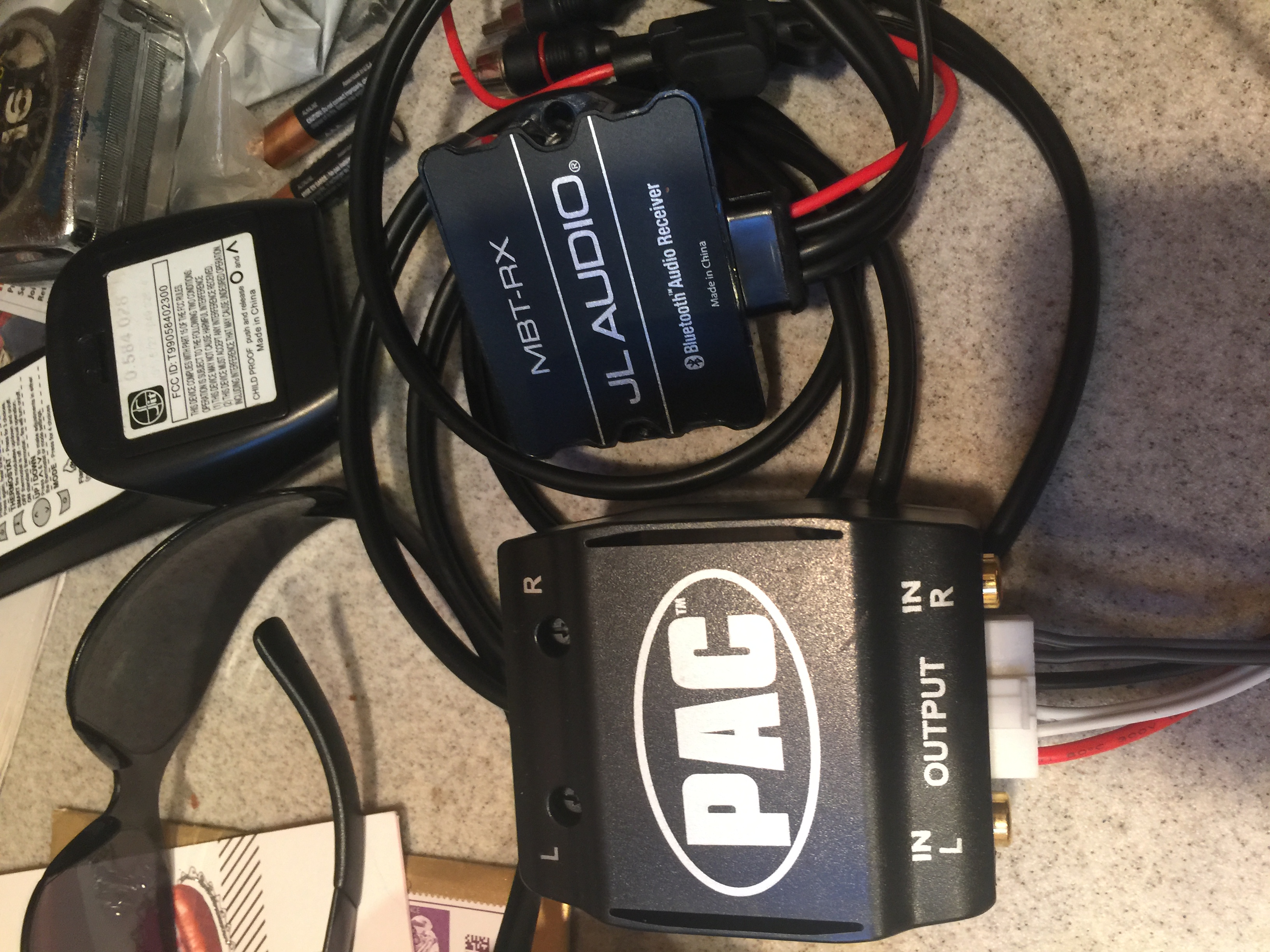

Hello, I may be the least qualified guy to answer this since I have blown up two amps so far and I think a speaker as I have been learning about the biamped (amp182BA) and the non biamped amplifiers (Amp 175) but this is about inputs and not outputs.

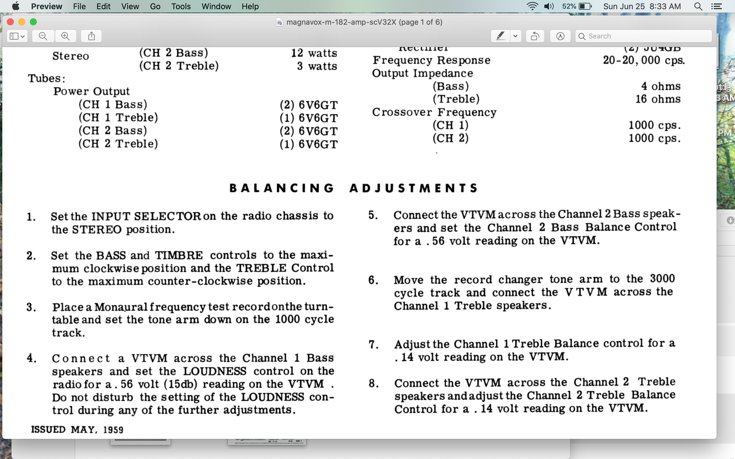

On both units when I hooked up the bluetooth adapters (two different brands adapters) to the tape inputs I noticed the volume was quite low compared to the radio or phono when you switched over the selector switch also the bass was quite subdued. Then tried a input line amp (two different ones ) and what I found with that is mixed results. The one brand doesn't sound as good and is much more sensitive to how its set. The other one sounds better (mostly in bass)(photo). I think it has to do with input line voltage and I found that for the Amp 182 that the input is sensitive to this. There is a sweet spot where the stereo has bass and treble and the timbre is very noticeable in range. I also like the fact that the line amp L and R channels can be adjusted independently so in effect is a balance adjustment. The good line amp is meant for car radio so it needs a 12V wall transformer to make it work but also I found it has to be the right one as some don't rectify the ac correctly and it won't work ( ask me how I know ) so it has more setup and wiring. I was very pleased with it as far as the sound though. I also have found this in the SAMS for the amp 182 which may help but I am not sure if input voltage effects output voltage. But I would think the the line voltage would be similar for the separate 82 series amps. I have not had a way to test any of the consoles as all the turntables I have run slow. but I did get a test record for the day I am able to test it. I may be way off base here let me know. Hydro

Hello again, I also adjusted the level on the line amp so when I turned the selector switch to radio or turntable the volume is close to the same. Hydro
