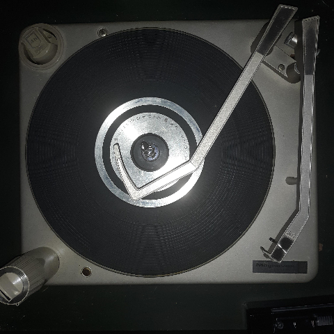

When did Magnavox switch over from the older black arm to the grey arm changers?... my astrosonic imperial has the newer grey arm TT. but if you look at the number underneath it says it is a 600 series changer... it does have the separate idler for the changing operation .. I thought only the older black arm changers were in the 600 series? And another question, how does the tone arm come off on the newer changer?, I see a screw on the inside but hesitate to touch it as it looks like it has been tampered with as the screw head looks stripped... the cartridge has become intermittent and needs to be changed , but the arm barely lifts 3 or 4 " above the platter .
Thanks
Elton

I believe the change to the gray tone started about 1966. The early Astro-Sonic models had 600 series changers with a larger platter than the one in your post.

Post: # 438Post hermitcrab »
the small one is out of my imperial tube set from 63.... the grey is in my SS imperial astro sonic...

Post: # 552Post hermitcrab »
That would be nice the models confuse me as well... like my pictures show both, changers are 600 series models but look completely different on top...

Generally, the 600 series Collaro like pictured above, the bottom one, started with the 1961 models. The late-1958 stereo and the 1959-''60 stereo changers were the F-200 series "Conquest" changers. Mechanically, the Conquest and the 600 series were very similar. The earlier mono series was called the 56 series, IIRC. Bill is lots more up on the mono Collaros than I am, since he owns some of them. Maybe he'll put in his two cents and help you out with those. The Conquest and the 600 series were generally equipped with Electro-Voice ceramic, .5 volt cartridges, both the model 26 and the model 132. The EV 26 may be one of the best early stereo cartridges there was. Euphonics E-1 and U-1 cartridges were also used, but they aren't anywhere near as good as the EV cartridges were. The bridge in the Euphonics would turn to goo so you couldn't change the needle.
