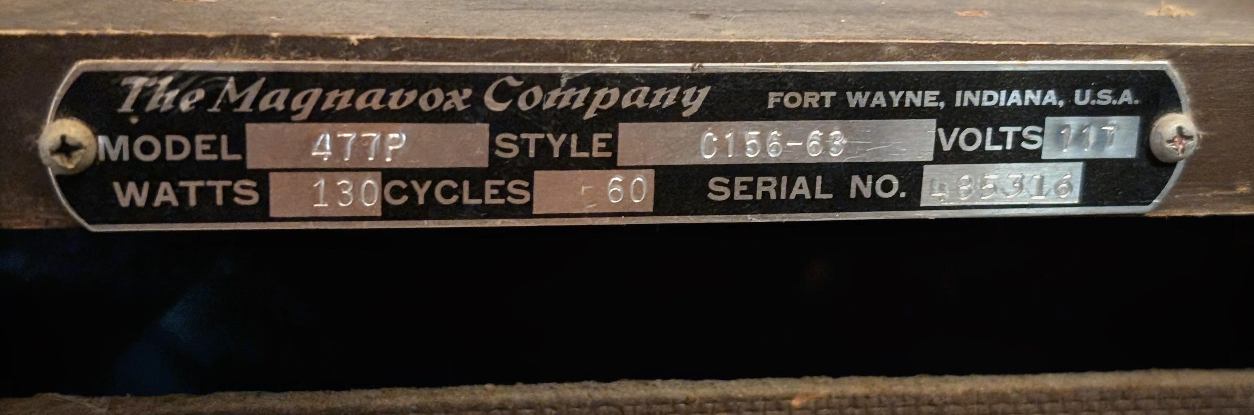

- Posts: 3713
Re: Magnavox 477P
ID plate:
