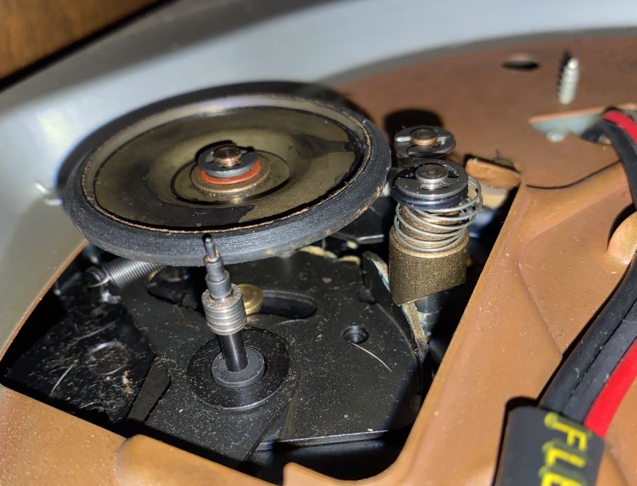

RP-215/216 have pulley height adjustable by a threaded shaft with 3/8" nut but I don't see one on mine :shock: :?
Maybe what you see below is the same and, if so, it may be adjustable only by adding thin spacer washers under the pulley.
Ill pull it out later to check but I think motor mount grommets are gone, there is a lot of play and no cushion holding up motor to mitigate vibration transmission onto motor board.
SO...motor shaft has dropped a bit as pulley rides too high on 33 step. Ill attempt to run and see if speed is even close

Post: # 25335Post Motorola minion »
Looks as if I need to take that suggestion, second from top is the 33.3 rpm turret, which looks pretty crusty.
