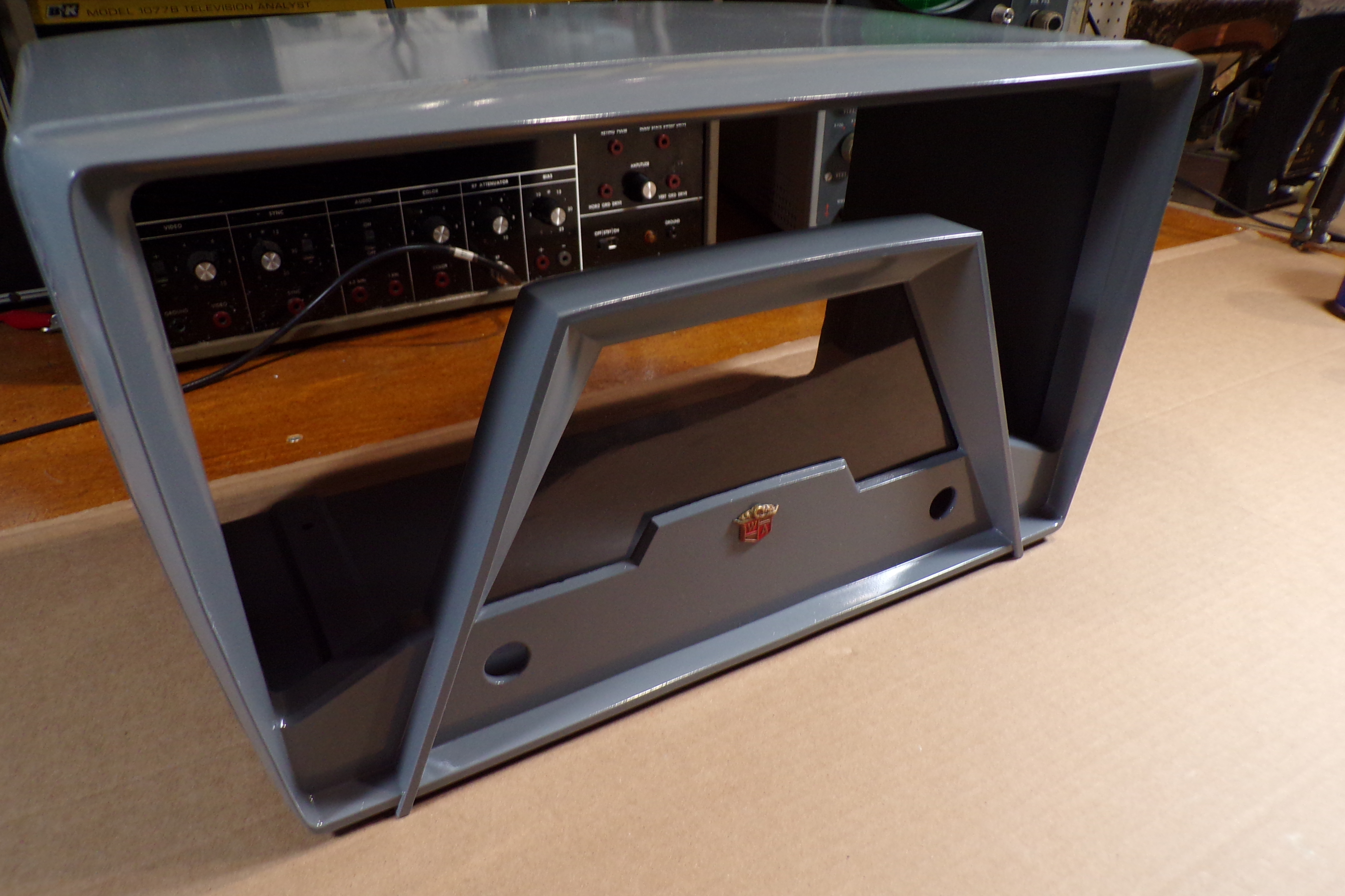

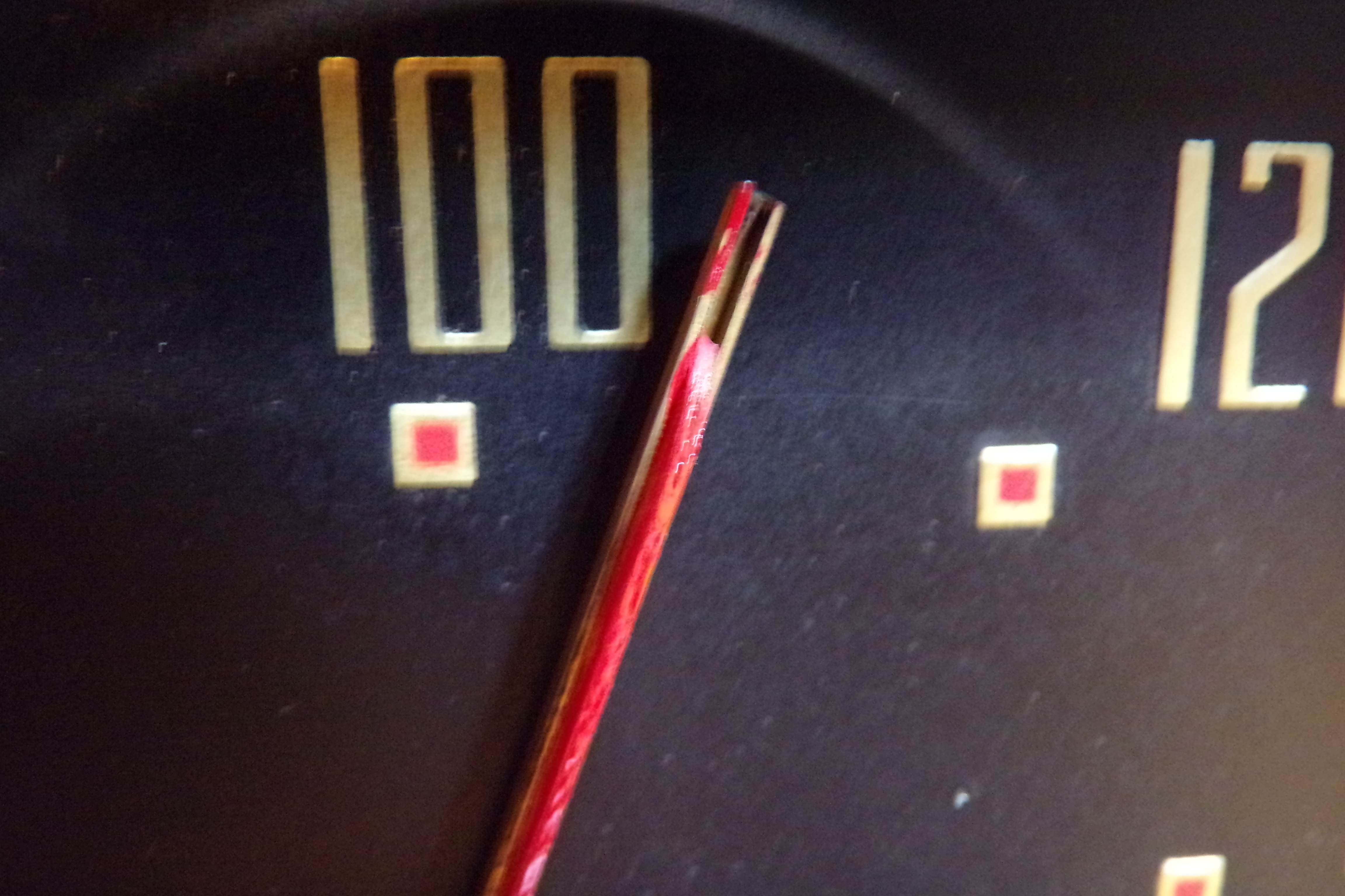

This is another ugly radio that is a dandy performer. Built by the incomparable Wells-Gardner, it is an AA6 chassis with tuned RF. I have gone thru the chassis in the past, so it doesn't need anything. The dial pointer is askew and the paint is coming off the cabinet. Two colors were available from the factory. Gray and burgundy. The gray is mud ugly. I don't know what color I am going to use, but I will use black grille cloth, since I have plenty on hand, left over from the Stereo Theater project. There is a red background "WA" emblem on the front of the cabinet that I hope comes off. If not, I'll have to tape it off and hope for the best. I have a can of aqua marine paint left over from another project, but I'm not "feeling it" with that color. Maybe burgundy headed toward candy apple red? The cabinet is in beautiful condition, no cracks or chips. This one is plastic, loaded with an extra does of "ugly".... ;)
The little "WA" badge does come off. The grille cloth is made behind the paper dial. I haven't developed the plan to replace the cloth yet.....

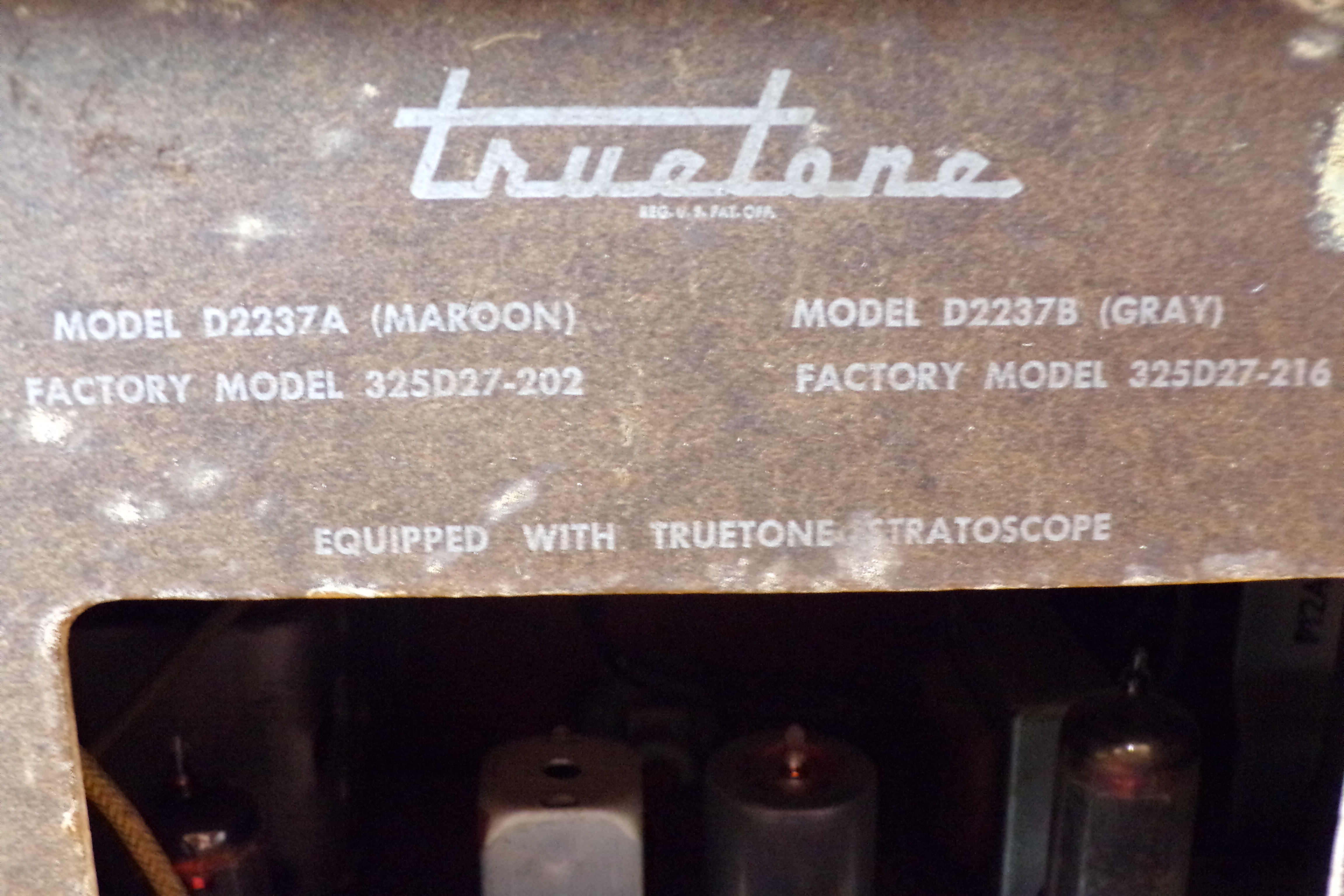

Is the "Stratoscope" their name for a built-in antenna? Zenith seems to have started a trend with their "Wavemagnet" appellation.

It is. This is one of the radios I bought in Pittsburg, MO, in a pouring down rain. We were at an auction and there was a pile of radios. I paid $3 for the pile. IIRC, I got 37 radios in that pile, all real junk. The only dud in that pile, ultimately, was a Philips German radio, which was unrepairable. This radio is a real gem, but it has always been ugly. All the radios I got at that auction, including this one, were full of water. Had water running out of them, soaked speakers, the works. This radio has a five-inch speaker, but has surprisingly rich sound, being that there is no tone control.

I found a brand new spray can of Rustoleum "Smokey Gray" that I'll use on this cabinet. I figured out a plan to replace the grille cloth. I may also do some cleaning on the chassis, although I won't spend much time on that. I think it's going to look find, and will be fairly close to how it was painted when it was built.

I used a razor blade to scrape all the paint off the top of the cabinet. I really shouldn't be around lacquer thinner when I don't have good cross ventilation, so the old scrape and alcohol treatment was successfully employed. Next step is to wash the cabinet in dishwashing soap, then wet sand with 400 grit. Then I'll prime the top again, wet sand after dry, then shoot another coat of paint. I have the grille cloth changed to black. I cut a dial cover from flat plastic that I have had on hand for maybe 25 years. I haven't used any for eons, so I had to clean and polish it with Simichrome to take the scuffs off. I believe everything is ready to assemble once I sort the paint situation on the cabinet.

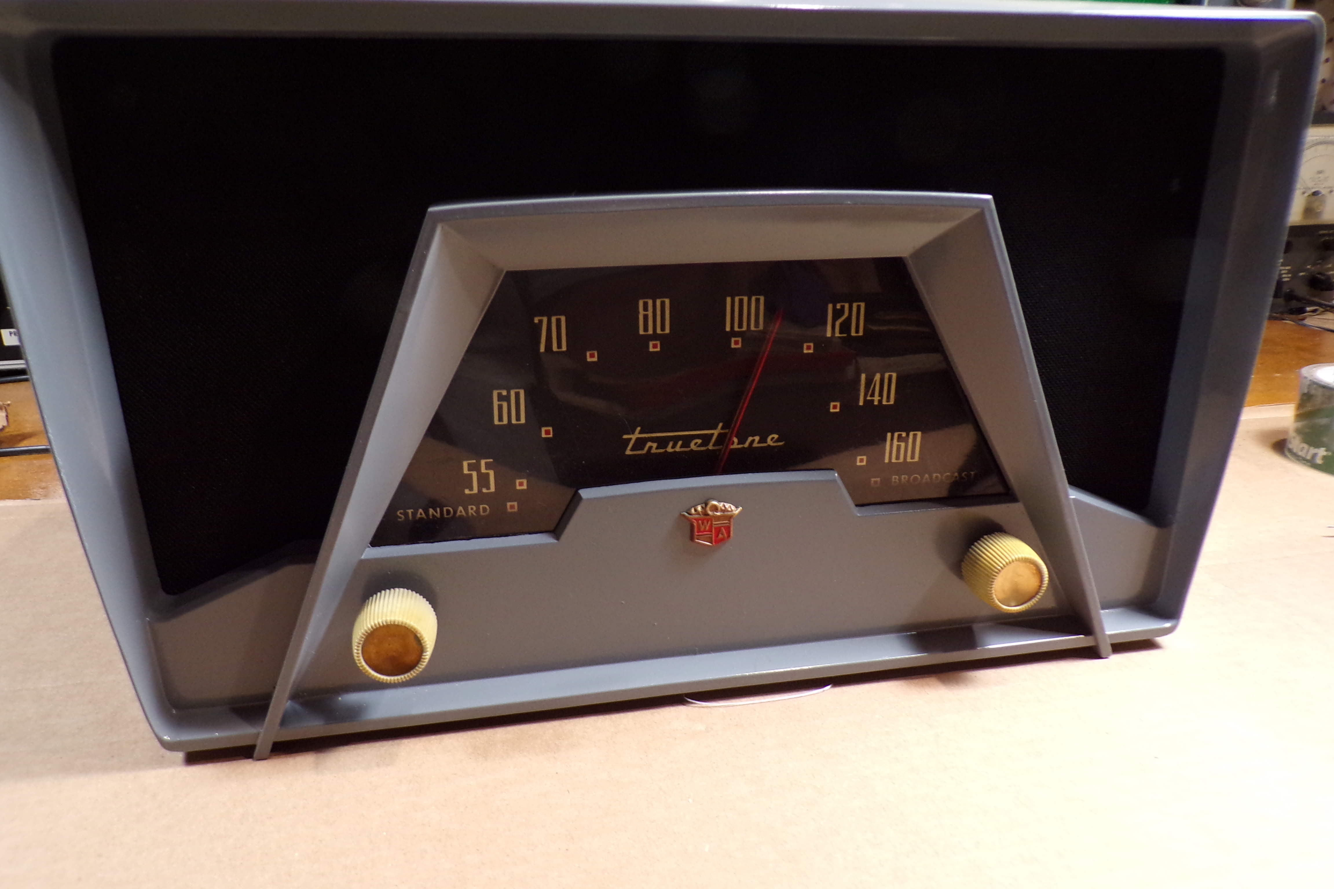

I taped off the front panel of the cabinet. That was how I wanted it and didn't want to overspray it. I shot a good heavy coat of primer on the top and sides, then, after waiting the recommended 15 minutes, shot another coat of color over the primer. It seems okay at this point. I'm going to quit while I'm ahead. I'll put the emblem on, put my homemade dial cover on, then slide the chassis into the cabinet. And, I'll get some pictures posted. I think it will be fine, certainly better than it was..... ;)

Post: # 23616Post electra225 »
Here is is. Done. It turned out better than I had hoped.

Post: # 23622Post electra225 »
It has a five-inch speaker above the volume knob in that picture. The speaker is mounted to the chassis. The board that the grille cloth is on is then attached to the front of the chassis. Rather a convoluted setup, but it works okay when everything is tight. There is no tone control, but the audio quality of the radio is quite good.
