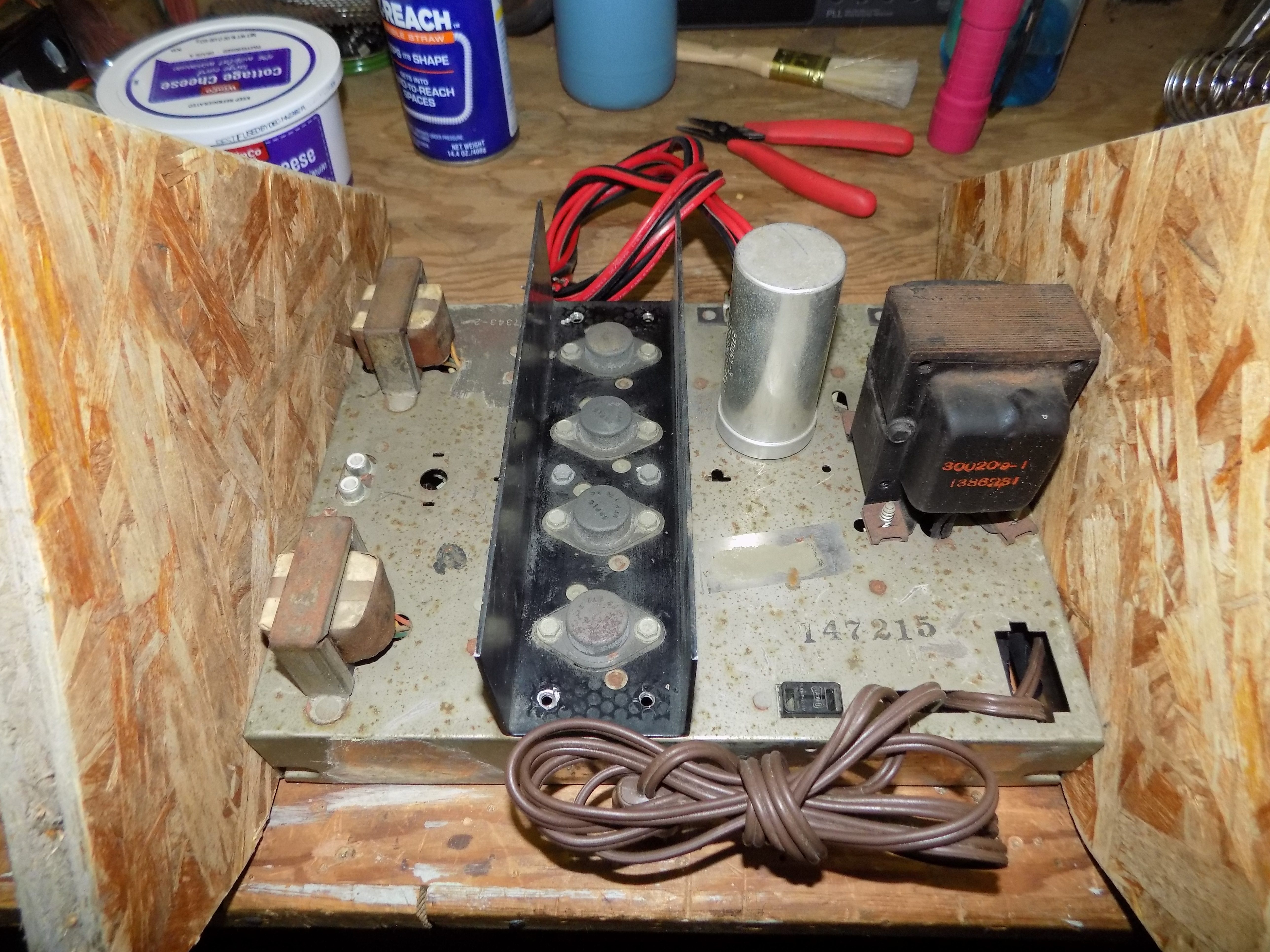

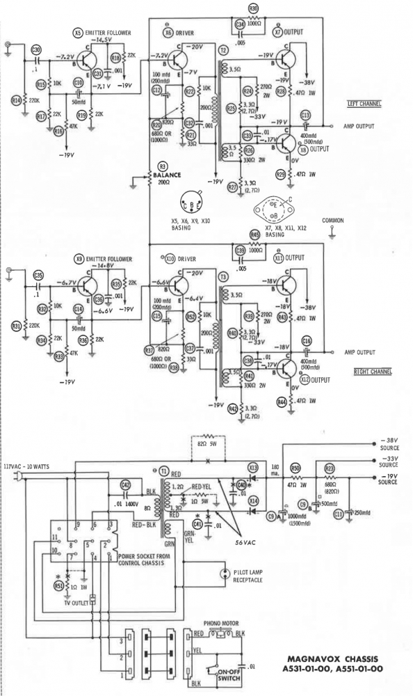

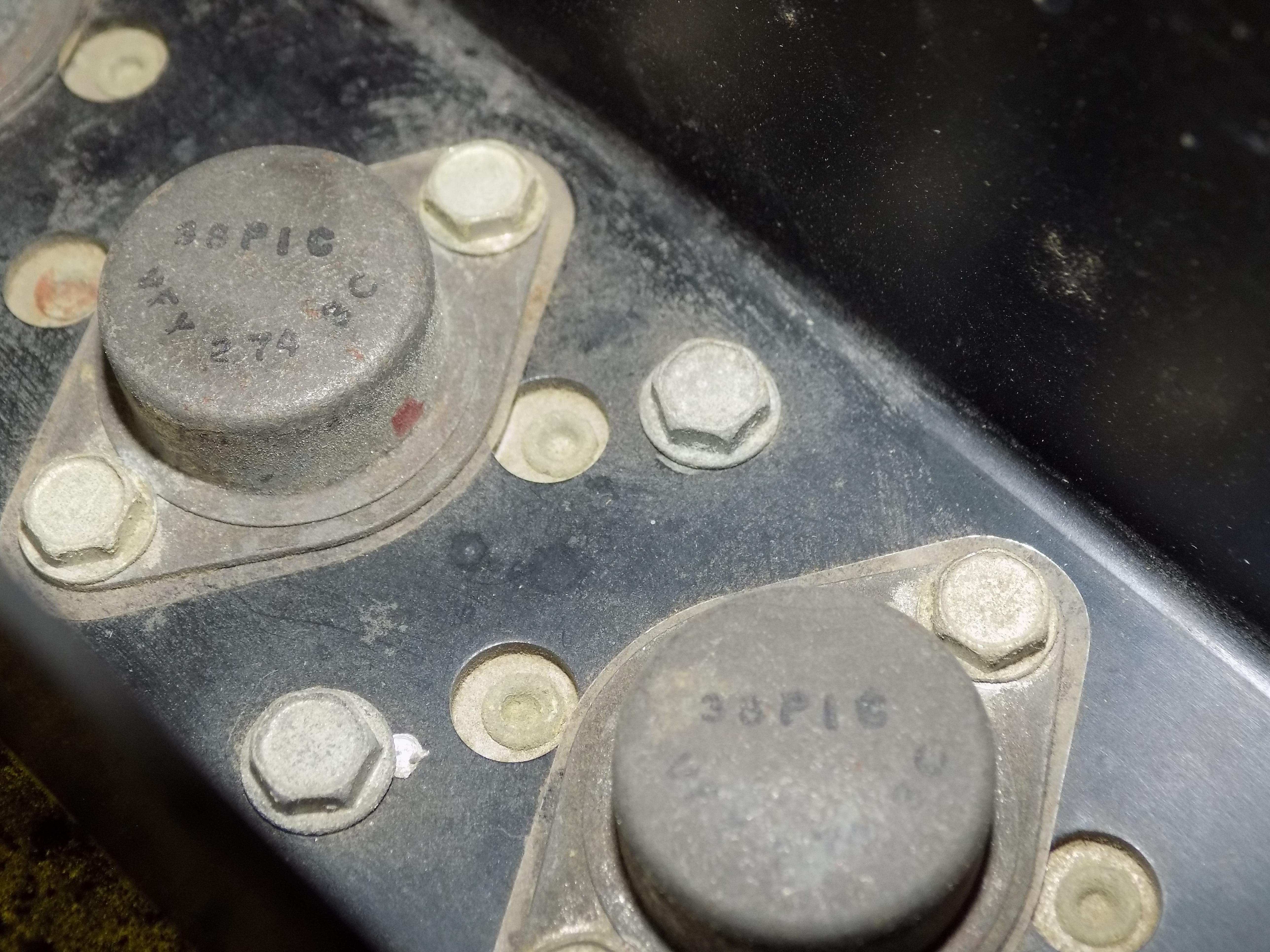

This posting on the 1965 Astrosonic 50 console with the A531 amplifier is one of the posts that brought me to this forum. I had an A531 that I purchased as a stand alone amplifier from ebay for $25, and is my current obsession/project. I would like to do a more detailed write up and post service information and photographs.
The listing: https://www.ebay.com/itm/145755373859
I have been doing a dive into germanium lately, really started with the garage sale purchase of two 70's automotive 8-track decks for $5, both of which had 12V class AB germanium amplifiers of Japanese design and manufacture with Sanyo transistors. After hand drawing out the schematics for the pre and power amplifier stages, researching other similar schematics, and understanding thoroughly the biasing design and thermal concerns, I rebuilt them into stand-alone cabinets and have been enjoying listening to them. I have found them to have surprisingly good fidelity and a wonderful tonality, once divorced from the awful 8-track source and given decent speakers to drive. Only about 1Wpc, they are great for desktop near field listening.
I wanted something germanium that was bigger to fill the room with my larger vintage 3-way speakers, so was looking for something in the 25W per channel range, and found this A531 on ebay for a song. I'm cleaning it up and reworking it to be a stand alone amplifier component. The transformers have date codes from 1962. The PNP Germanium output transistors, (38PIC or 38P1C) have a source code of 274 indicating RCA manufacture. I have figured out that Magnavox seems to have been big enough to get manufacturers to print Magnavox proprietary numbers on their transistors instead of the common part numbers to confound repair techs working without the Magnavox literature, or to give Magnavox licensed techs more business. (Does anyone here have more information on that?) Anyway, SAMS typically list a table of equivalent replacements, which might give clues as to what actual part numbers these should have been printed with. I would love to learn more about this.
The amplifier seems to have come in two versions using the same chassis. The larger, the A551 is listed as 25 Watts per channel, has a larger power transformer, and different transistors (47PIC or 47P1C) than the A531. Other minor differences include a main supply of -44V vs. -39V, half-again bigger input coupling, power filter and output caps, and some slightly different bias and gain values. I have found much less information on the A531 version except for one of the schematics I will attach here that shows the A531 component values with the values for the A551 next to them in parenthesis. I am not sure what the rated power output of the A531 is, but as Motorola minion posted it's probably comparable to the Magnavox 9300 series 6BQ5 push-pull tube amp (which I also will do a write-up on) that is around 15 watts per channel. I have not purchased the SAMS (669 folder 8) for the A531/A551 yet, but will and post it in the downloads section soon.
Attached are views of a good clean condition A551, My dirty A531 in a support frame, 38PIC output transistors, and two schematics.

Interesting that the output transistors are transformer-coupled to their drivers. My Heathkit AA-22 has the same scheme. What was it about early transistor amplifier design that required interstage transformers?
Re: 1965 Astrosonic 50
Hi Chris-
I have noticed that just about every germanium output transistor amplifier design I have looked at uses interstage transformers. I'll take my best crack at why this is, and welcome more educated input on this because I am a newbie at analog design and don't have much historical knowledge in early transistors.
Most typical class AB output designs using silicon transistors will use complementary drivers- a PNP and an NPN that are well matched. Because they are opposite polarity devices (a rising base signal turns the NPN on, and PNP off, and vice versa), both bases are driven with the same phase input signal (with different DC bias points) so the predriver output is either directly or capacitively coupled. From what I have read, it was more difficult and expensive to manufacture NPN germanium transistors. With PNP devices being prevalent, the output stage was most typically totem pole (two same polarity devices) so the predriver output had to be phase inverted for the two bases. Tube AB output stages had the same problem (there is no PNP analog in tubes) so a wide variety of phase inverter circuits were designed to present opposite phase input signals to the two totem drivers. Tube designs typically did not use interstage transformers, so why do germanium designs?
I believe the best answer is because of the low input impedance of the totem pole germanium output devices. Vacuum tubes have an extremely high input impedance, which can be easily driven by even the relatively high output impedance of a tube predriver circuit. For a germanium power transistor however, the current gain (hfe) was typically quite low, maybe 20-50 or so, so a relatively high base current would need to be driven for any kind of output power. The hfe of the transistors used in the predriver circuits were not much better, so several different stages would be required for voltage amplification, then creation of the inverted signals, then a current buffer (like emitter follower) to provide the necessary drive current. I believe a transformer was a cheaper, more reliable and elegant solution than the 5-6 transistors and supporting components required otherwise. The transformer could generate identical secondary outputs that were perfectly inverted, and the turns ratio between the primary and secondaries chosen to give a good impedance match- the primary was typically 200-400 Ohms (AC impedance, not DC ohms) while the base driving secondaries was around 3-8 ohms. The primary could be driven by a simple high gain common emitter circuit that incorporated the negative feedback signal from the amplifier output, and the secondaries had the low impedance to drive the output bases directly with ease.
In my opinion, the interstage transformer is most of the magic that provides the tonality or color (for better or worse) of the germanium amplifier circuit, just as the output transformers do for vacuum tube amplifiers. I really like this color, and I am working to make a germanium power amplifier part of my audiophile pallet.
Took a glance at the schematic for the AA-22 output stage- interesting that they use a germanium "compensating diode" to establish the bias point of the output drivers- you see that all the time in silicon, with silicon diodes, but in germanium I frequently see "thermisters" used in the bias circuit that can adjust the bias point down as the cabinet warms up and the germanium output transtors start to conduct more to avoid thermal runaway. A germanium diode would be subject to the same effects of heating, so is a nice method to use.
