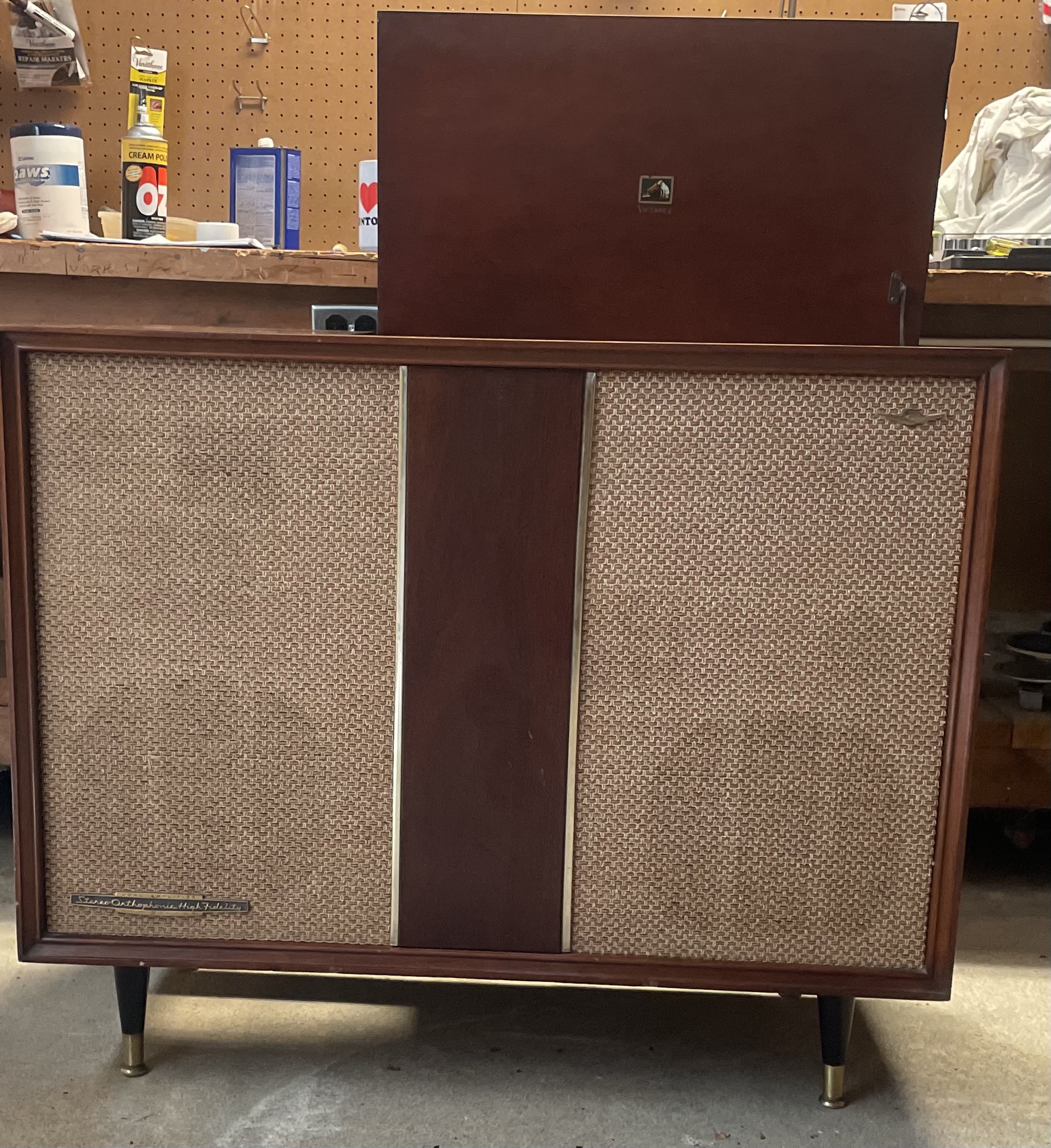

Here is a unit I picked up which looked and sounded great after a routine recap, it sold right away. Despite a photo-finish mahogany cabinet and plastic legs - yes it had appeal! RCA mark down model wins over more expensive provincial models LOL!
My customer had it in his antique booth when it stopped after a blown fuse. I replaced it with a 3 amp slo blow version of the fast-acting 3 amp and got a very cheap fireworks show.
One of the two 16-watt audio-output transformers started smoking and lit up enough flame to light a Lonsdale cigar before I pulled the plug. Fuses blow for a reason, fast acting may blow due to fast-on-off-on cycles due to line fluctuations or monkeying with the power switch. I made that- particular assumption when I changed it, lesson learned. Tubes tested OK on unaffected side but weakened considerably on the affected side.

What caused the output transformer to smoke?
Re: RCA stereo TPM12 - 1960
When I went to look at this unit, it was playing fine on FM but a mild red plate spot on the one output tube. The player was in dire need of a cartridge, there was no testing that.
There was no back cover so I could clearly see what I was getting; it was not recapped and I can only guess how often and long it was operated with a tube partly melting down..
