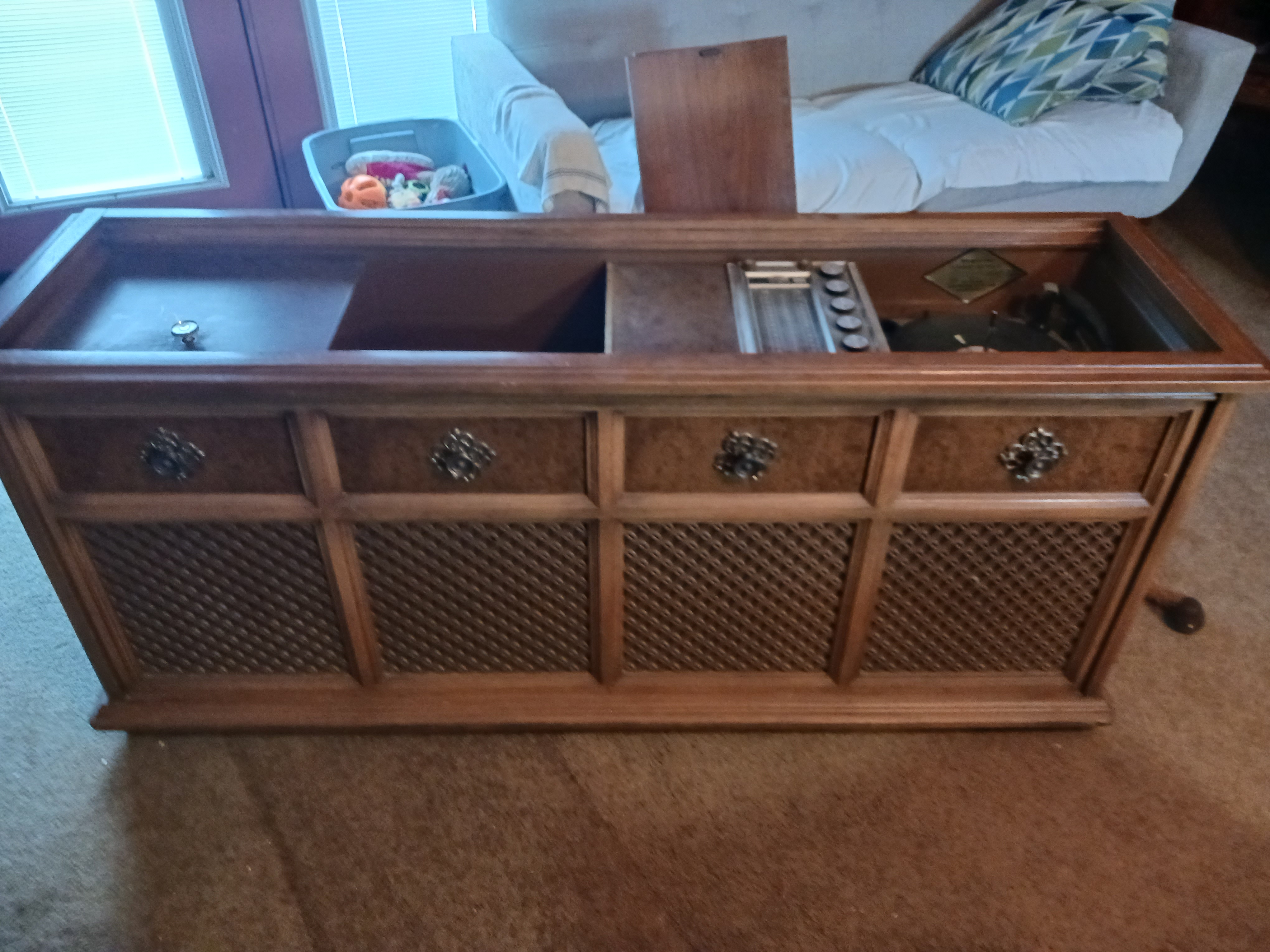

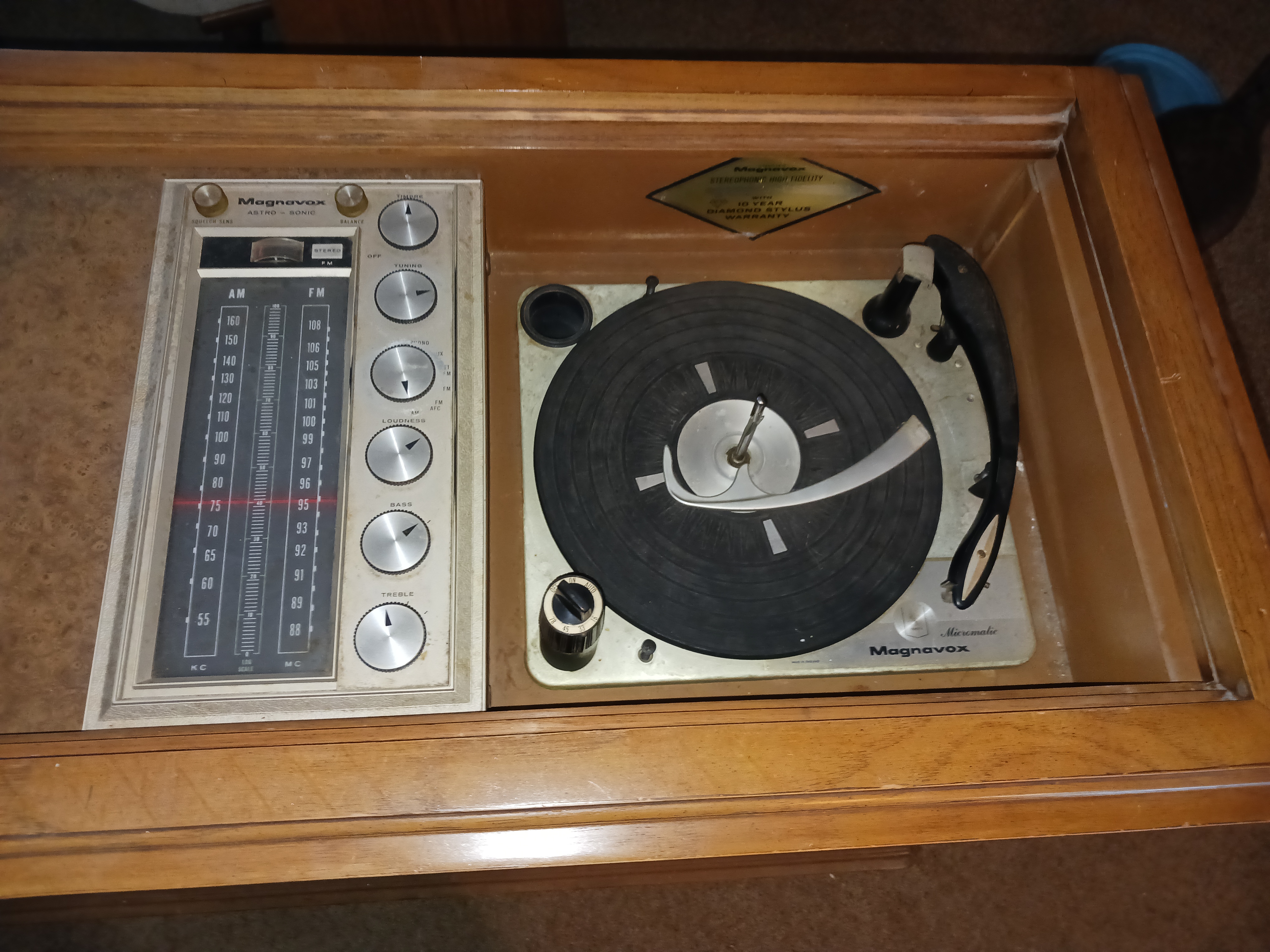

Here it is out of the truck... unfortunately no tags on the back to confirm the model # except what the sales receipt says ... in good shape overall except the record arm being broken ... will try to braze it or put a request in the wanted to buy section .... also shows the paperwork for the new needle ordered in 72.

well I believe the sales receipt is wrong on the paperwork....inside the speaker housing I found model 2ST690... which should be a 64 model , but since the download section is blocked to me , I can't tell for sure , that would align with why it has the early changer instead of the narrow grey tone arm changer...

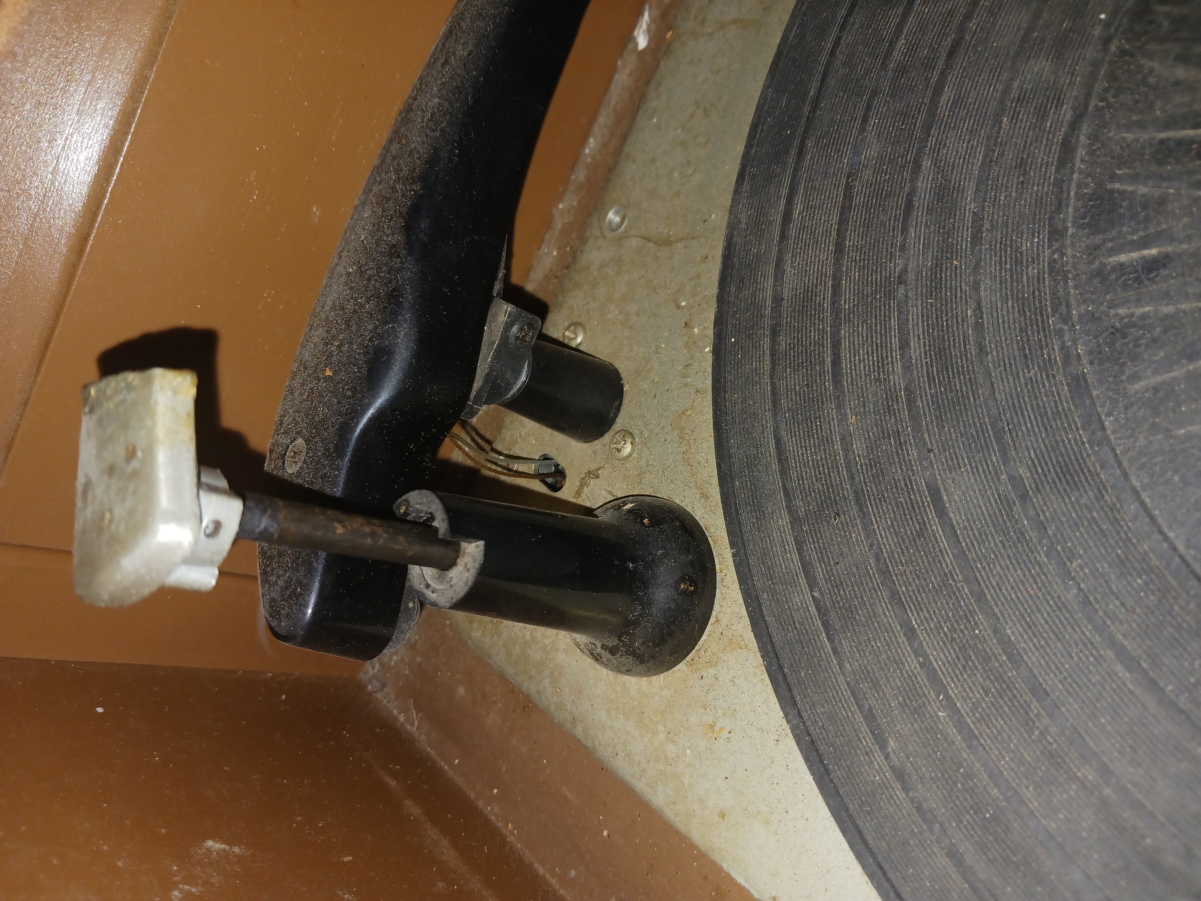

If you can't find a replacement, a repair ought to be easy. Use an epoxy like JB Weld on the underside where it cannot be seen anyway. Rough up the plastic a bit; wave a propane torch flame lightly over the glue-up area, and then apply epoxy.

Are these held on with a roll pin, or a tiny allen head screw?....

Looks like you'll have to use a allen wrench set as a detector.

the pin requires a 3/32 punch to remove it...I hope the JB weld can handle me pounding the pin back in the arm

Can you push it back in with a small C-clamp?

On the same vein as Chris's suggestion, you could also use Vise-Grips or even a medium sized pair of water pump pliers to squeeze it back in, you wouldn't have to pound on it.

as predicted the JB did not hold , it came apart on its own just by gravity on the changer, and as suggested putting metal underneath as reinforcement just interferes with any 12 in record you put on it , if it comes down to it , my son's 3d printer can handle something that size ... but no rush now.... as I discovered the power transformer is kaput on this beast ...when I got it, the power cord was cut off, so I wired one on and tried it... nothing.... pulled the chassis and jumpered the primary and no output on the secondary... so now I need to look for one of those , fortunately it is a simple center tapped 48 volt secondary with a 6.3 for the pilot lights... should be an easy find as long as the current capabilities are there so as it stands this one is a beached whale for now...

If you want to try again.... If it's a metal arm, make sure the underside where you are applying the epoxy is brushed clean of paint. Gluing over paint gives a bond that is only as strong as the paint. If it's plastic, use the Gougeon Bros. recommendation about passing a propane torch briefly over your roughened plastic surface. From one of their manuals:
"Typically, epoxies don’t adhere well to many plastics. But, with
WEST SYSTEM G/flex® Epoxy and proper preparation, you can
achieve excellent adhesion to most plastics.
Sand ABS, PVC and polycarbonate plastics with 80-grit sandpaper
to provide texture for improved adhesion. Some plastics like
HDPE and LDPE (high-density and low-density polyethylene)
benefit from flame treating. First wipe the bonding surface with a
solvent to remove contamination and dry with a clean paper
towel. Pass the flame of a propane torch across the surface quicky.
Allow the flame to touch the surface, but keep it moving—about
12 to 16 inches per second. The flame oxidizes the surface and
dramatically improves adhesion with adhesives and coatings ap-
plied over it.""
Try their G-Flex epoxy:
https://www.westsystem.com/products/g-f ... ned-epoxy/
They are a great, innovative, employee-owned Michigan company.

TC Chris wrote: ↑Mon Dec 11, 2023 11:41 pm If you want to try again.... If it's a metal arm, make sure the underside where you are applying the epoxy is brushed clean of paint. Gluing over paint gives a bond that is only as strong as the paint.
The arm is metal... pot metal I think, I used a mini grinder on the bottom to roughen it up, and used a 1in" thin strip of 22 ga to help reinforce the joint ... it held for about 4 days , The problem is the break is right at the post , so the weight of the arm is always pulling on the joint ... I think it has to be replaced with a donor , or as stated I will have my son 3D print one out ...it is only needed if you stack LP's... it is not needed on a micromatic for 45's
