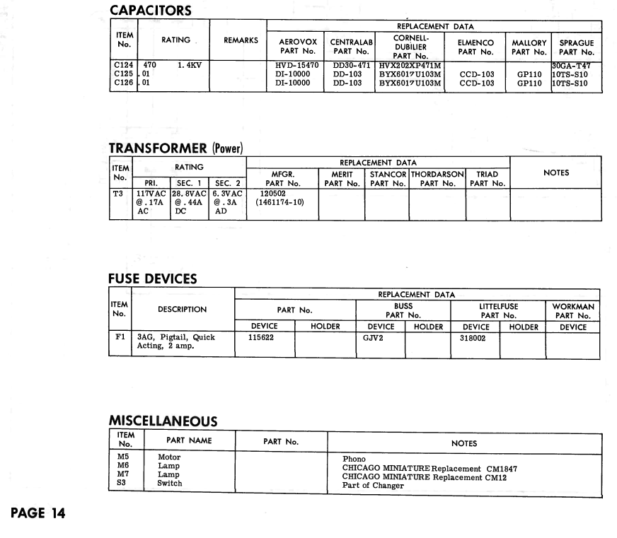

Good evening,
Looking for the bulb replacement size(s) for an RCA VLT51W stereo console. Can anyone provide me with this information. Thank you for your assistance in this matter.

which bulb are you replacing?... if it is the dial light .... most are 6.3 volts , so I would say it is a #47,... stereo light? never replaced one on a RCA, but someone on the forum should know. I have a VLT62W the Villanova... its a decent player... welcome to the forum.

Steve,
Here is a partial parts list from Sams 1015-7 with 2 lamps noted.
The 1847 should be a standard #47
The CM12 appears to come in 2 different bases.
https://www.alldatasheet.com/datasheet- ... /CM12.html
