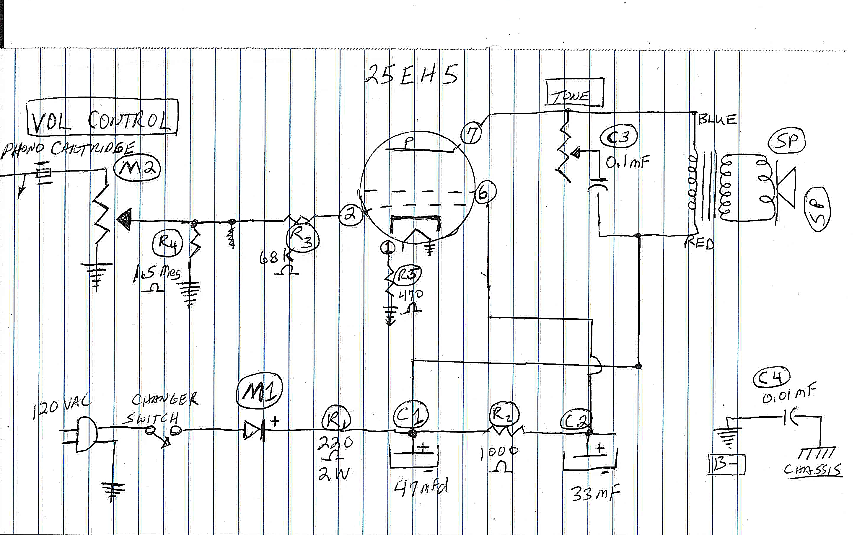

Upon opening up the cabinet, I was surprised to see it had a
one tube 25EH5 amp, with selenium rectifier.
I've got it all re-capped, but some questions remain.
I had to draw out the schematic, since there is none.
1. According to 25EH5 tube data, the plate and Grid2 voltages are pretty low.
Both 80 VDC.
2. Rectified DC voltage is 104 VDC, which also seems low.
2.a. The 220 Ohm 2watt resistor is VERY hot, could not touch for
more than 1 second.
It tests at 240 Ohms.
3. Tube tested very good.
4. Resistors are good except for R4 1.5 MEG, which is 0.95 MEG.

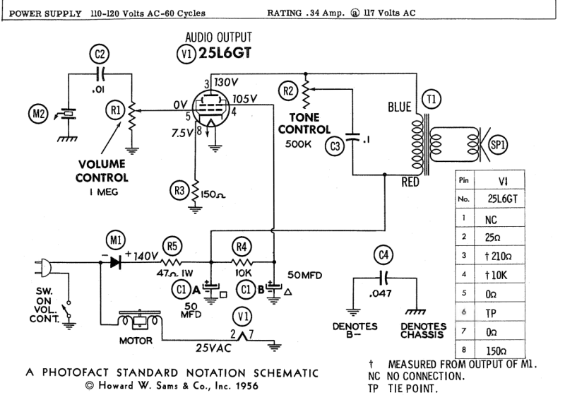

I'm posting a 1 tube RCA schematic whose wiring is
very similar to this Bradford.
I used it to help guide me in diagramming the circuit.

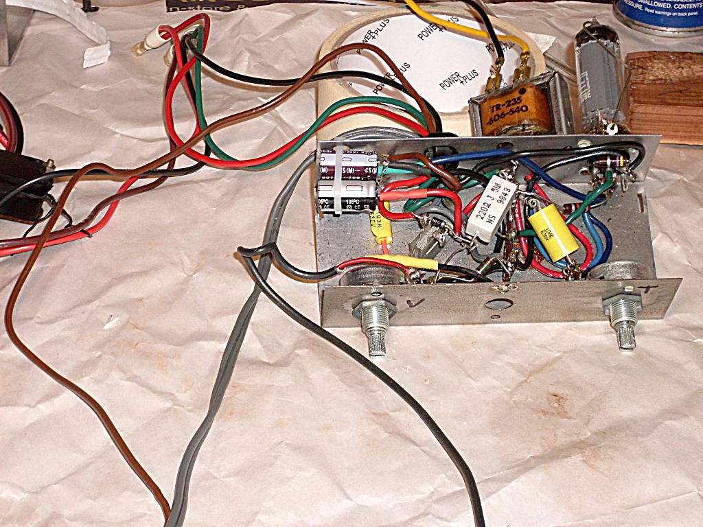

Re: WT Grant Bradford 1-tube Amp Questions
Anode voltage 122 VAC, house line voltage.
You can see the 1N4007 in the photo fairly clearly.
The red wire on its left is incoming AC 122 VAC.
So, if the 1N4007 is bad, is there any other tests to do
for that ?
Or just replace it with another ?
for that ?

If you have 122 volts on the anode and only 56 on the unloaded cathode, that doesn't sound right. It should be close to 150 volts if the rectifier is good. Many of the radio guys, when they replace a selenium with a 1N4007, put a resistor in B+ so B+ won't be too high. You have the opposite problem. I think you did right replacing the selenium as they are usually found bad, or will soon fail if they test good while you are working with them. 1N4007's are pretty cheap, so I would test and try another one. Let us know how it goes.....
Did you bridge the selenium rectifier with the 1N4007? I can't see well enough, but it looks like the selenium is still there, used as a terminal strip, maybe? You should have the selenium completely out of the circuit if it isn't already. Replace it with a terminal strip to make the connections. If the selenium is bridged, it may be dragging down B+. Pardon my poor eyesight if I'm seeing wrong....
