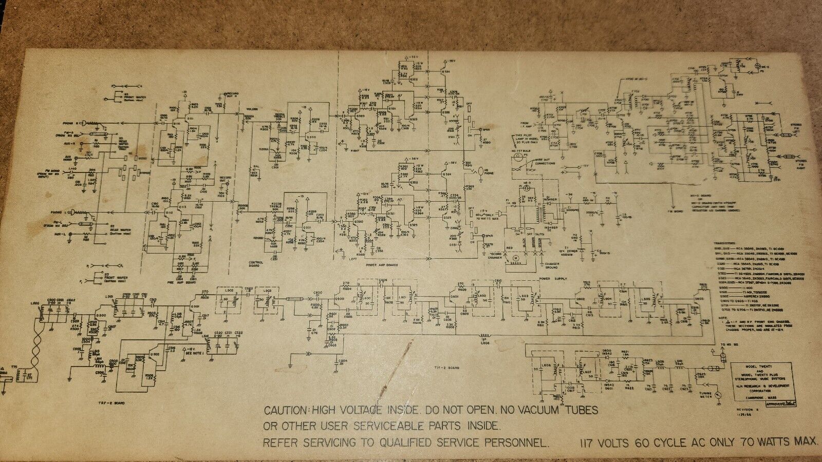

Long story short, I recapped and coaxed the amp into working without overheating outputs after a quest for knowledge and trial and error, not to mention disassembly and reassembly, not easy. KLH marched to beat of their own drummer. I saw brilliant design features considering the state of SS units made domestically. I will credit a thread on AudioKarma for giving teh procedure to properly adjust bias and balance pots, one of which was bad, the original problem. No tuner work per owner who plays LPs only. The transistor designs were all different between all three sets in my shop, I needed parts from the 19 to fix this one, including the entire record changer, also Garrard.
No manual or clear/accurate schematic was found. Just this one attached, least i can do if you ever encounter one.
