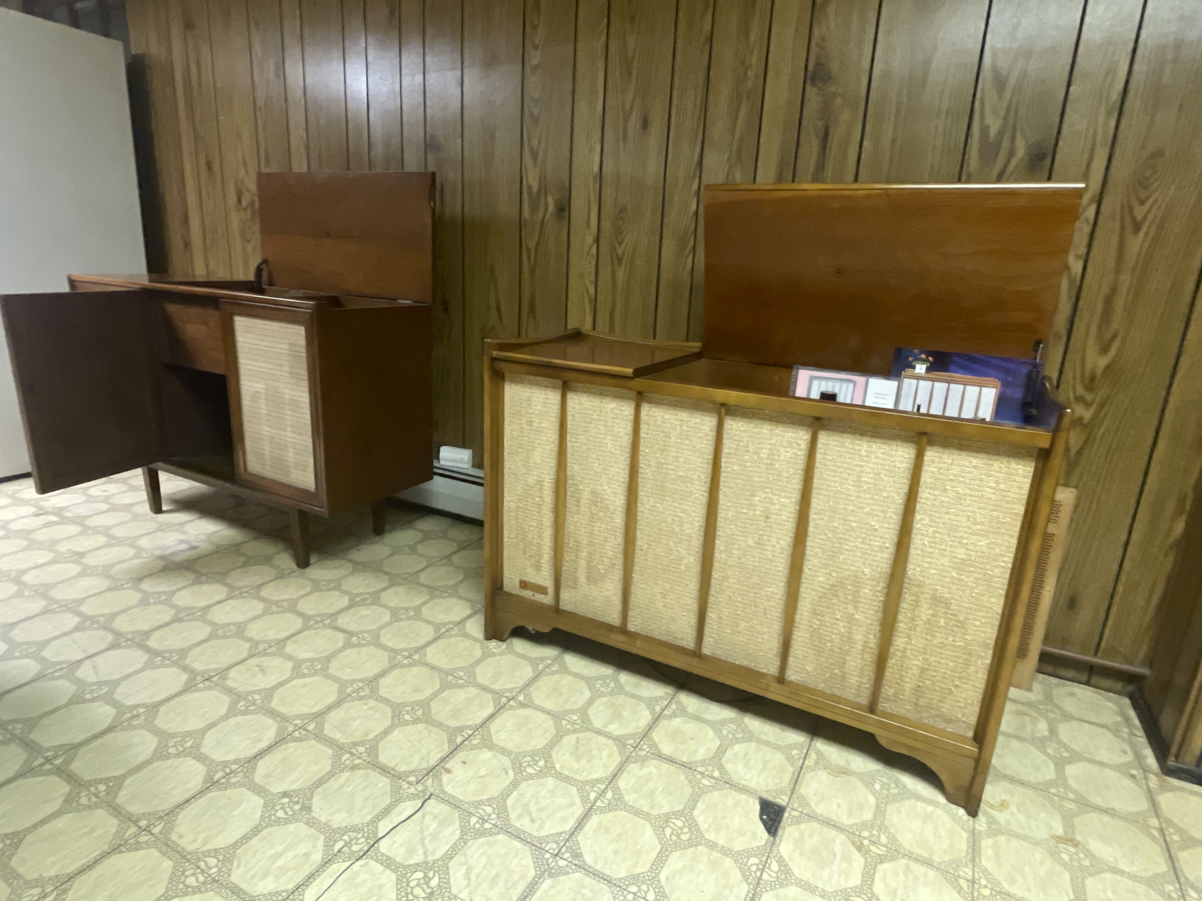

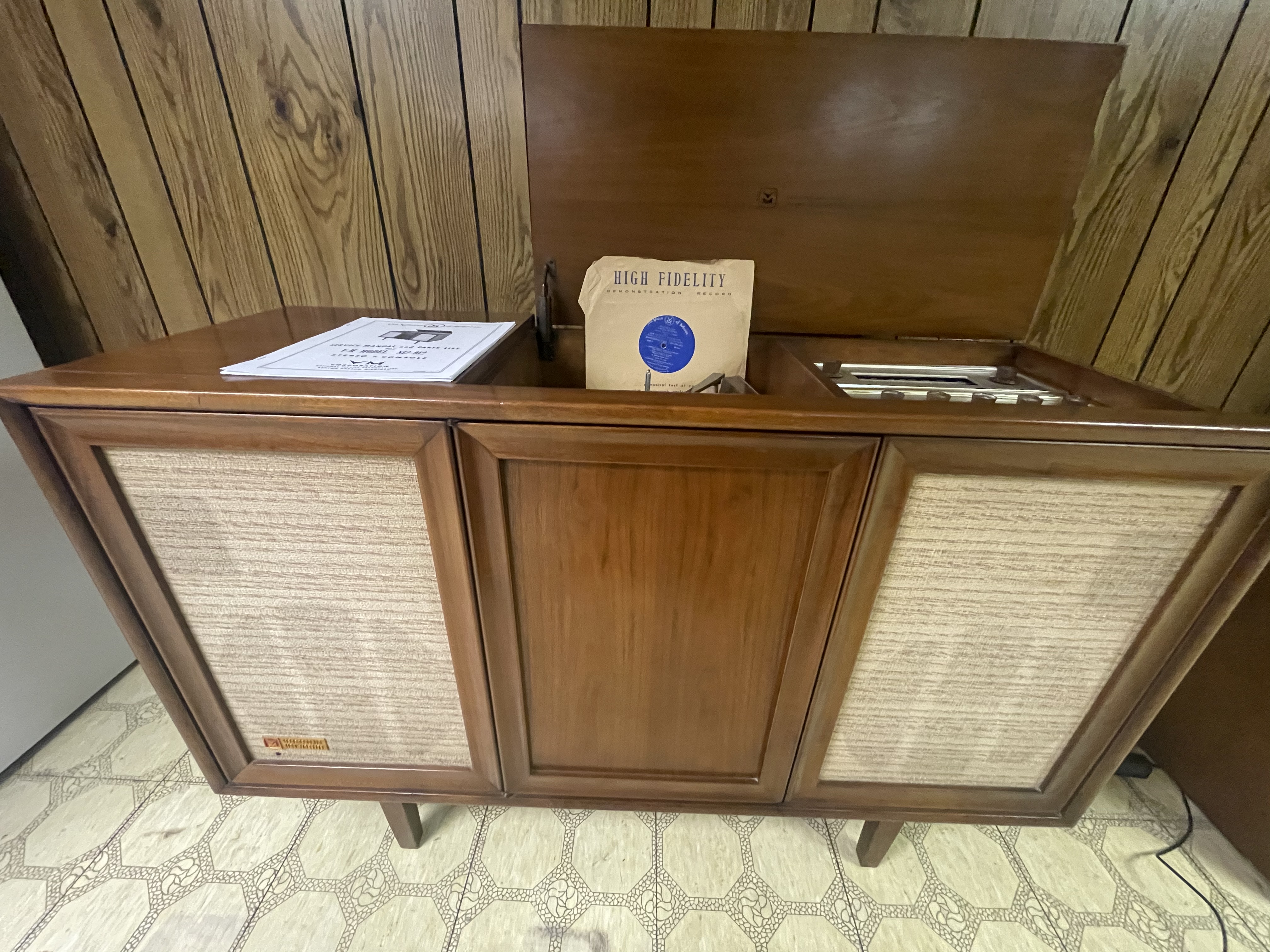

Love V-M equipment. Stylish, charming and easy to work on. These are my 2 restored sets from 1960.

Sticky tile floor and dark wood paneling... so '60s! A perfect match for these early '60s consoles.
