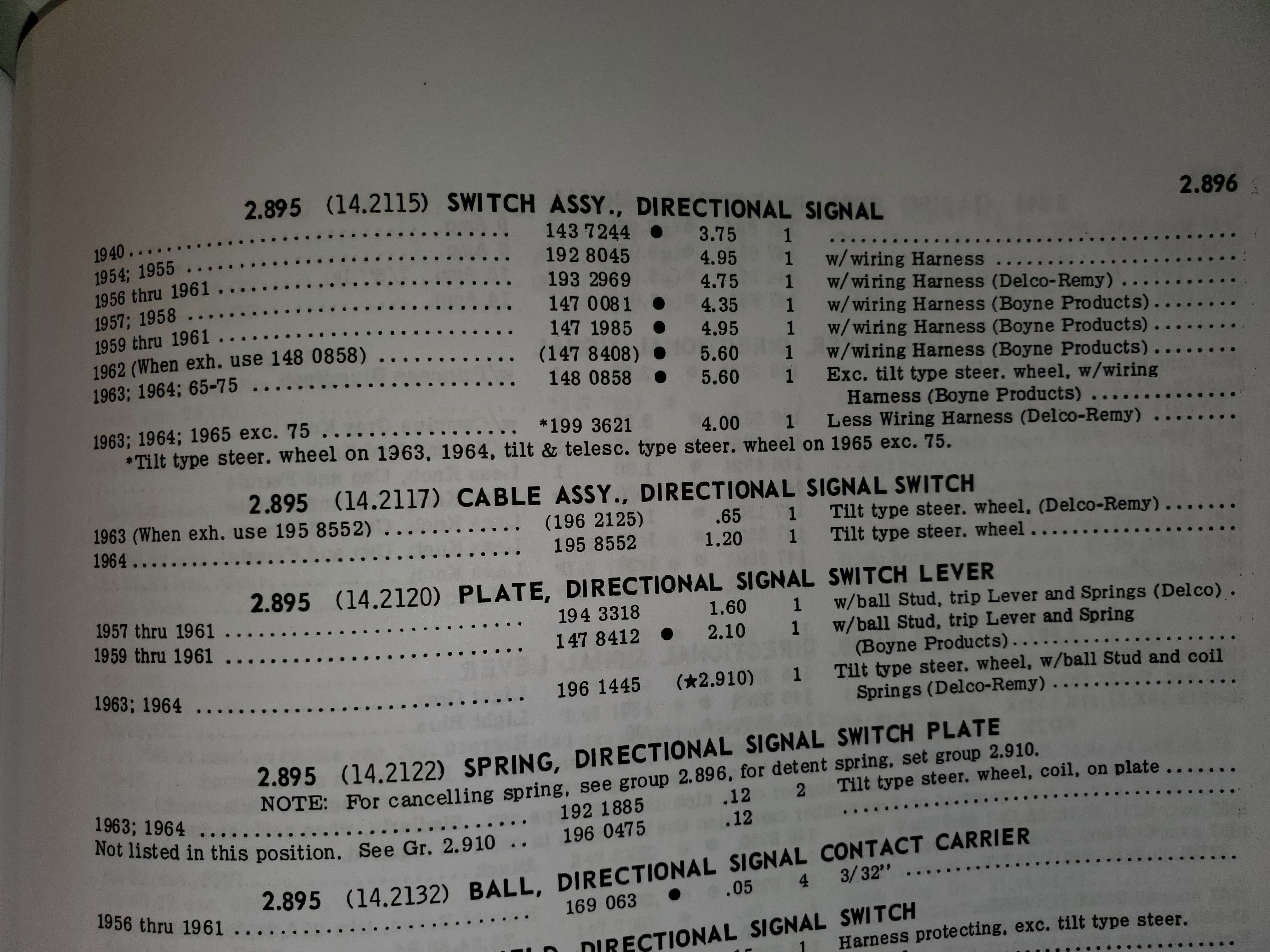

Re: '63 full-size Buick turn signal control cable
Not sure it'll help but here's from the MPL
- Posts: 9029
Thanks, Walter, that does help. #1993621 is the part number for the turn signal switch for the Buick, also fits series 4700, Riviera. I see it fits Cadillac as well. There are only two part numbers for Buick instead of four. One for tilt wheel which all have the cornering light connections, and one for non-tilt. These don't have cornering light connections. According to the Buick shop manual, all jobs with cornering lights use the same switch, whether they have tilt columns or not.
Now to figure out why Scott told me that replacement switches, NOS or used, will not work.
