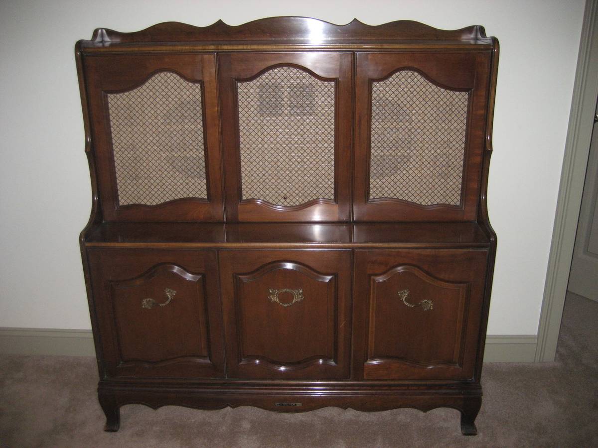

I saw this on CL in Doylestown, north of PHL. Tempting price but not anywhere I can "swing by" on my work travels.
This is a similar model 4VF480
Speakers mounted up high, bass would not suffer TOO much if the cabinet is sufficiently reinforced.

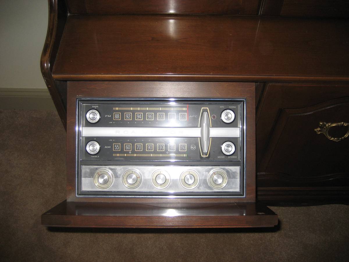

These RCA high boys (spinnet console?) have three fine features common to the better RCA models.
1-RS177 PP6BQ5 stereo amplifier which is comparable to a Mag 93 series, Motorola HS-696 or Zenith 7K31 to restore.
2-RP218 record changer, a great unit but always needs a cartridge fitted because originals dried/shrunk excessively
3-RC1205C tuner uses a 6FG6 eye tube and has on-board mpx decoder, improved (German-made) tuner using a 6C9

Had one once, liked the cool "tilt-out" receiver. The 2 ch PP 6bq5 amp and record player were fine, the tuner, OK, but the biggest weakness was the speakers. They're mounted in the top section in 1 big open rectangular compartment, not sealed, just Masonite on the back, the drivers were also pretty ordinary, iirc 10" woofer and a couple run-of-the-mill cone-type smaller units. The sound was spectacularly unimpressive so I moved it on (intact - the cab was very nice) quickly and cheaply. Also imagine this furniture style and hutch configuration would be a tough sell now. You mighta dodged a bullet on this one. That free one out in Elmira I mentioned a few months back near Dushore was the same thing but in a normal (low style, not hutch) console.
