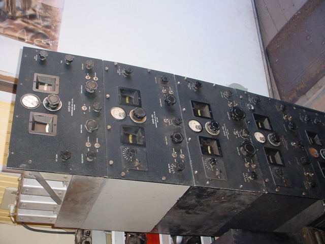

I do it only on my 1936-38 Super-Pro receivers. So few were built, and fewer survive today.

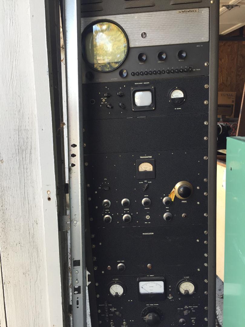

Here's one, a hand-built (by my late Uncle) high power Ham transmitter, circa 1948, that is now actually in a museum.
The Hallicrafters scope section is the only part he bought, the rest was built from parts bought at IBM Endicott surplus,
using a rack, blank rack panels, and Budd chassis, he designed the circuitry, built it, and made decals for all the faceplate letting etc. The man was truly a Renaissance man, he once built a complete set of kitchen cabinets using wood from IBM packing crates. The transmitter is original, so never got a probably needed re-cap, but should be done as original.
