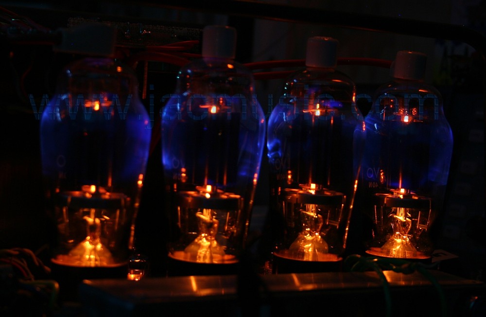

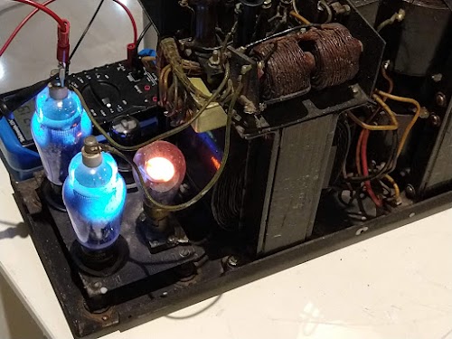

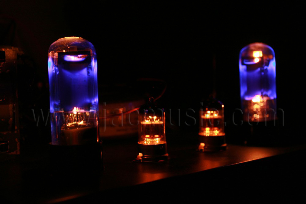

In some pictures of amps and tubes taken in dark conditions I've notice some kinds of tubs glow a very prominent blue. My amps over the years have had 6BQ5, 6L6GC, 5881, 6CA7, 6V6GT, and probably others but all glowed a faint red (but were not red-plating). I've seen Mercury vapor rectifiers that glowed purple, and Thyratrons seem to be colorful. Do certain types of power output tubes glow blue like these pics? The second one looks like a KT88.

I am guessing here but it looks like the cathode emission is "literally shining" onto the glass envelope, through the gaps in the plate.
6L6 - does it best I have seen it myself: https://www.bing.com/videos/search?q=yo ... ORM%3DVDRE

Higher voltage discharges within a vacuum will have a blue glow. If a fluorescent tube had no phosphor coating inside the envelope, you would see a similar glow. The glow can emit UV radiation at high levels, as with the old ozone bulbs, like they used in the old Puritron air purifiers.

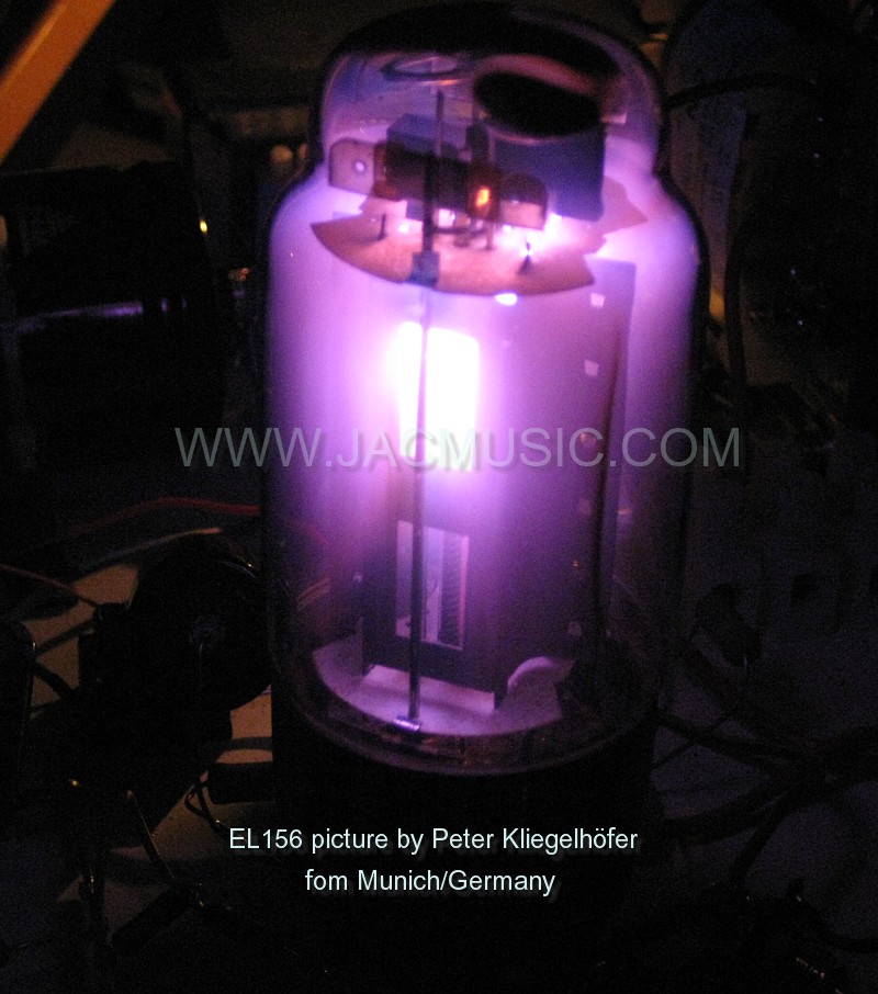

purple EL156

The phenomenon has been known since at least the mid-19th century. In high school, among our small lot of demonstrators, we had a Geissler tube that would contain a glow when high voltage AC was applied to it.
