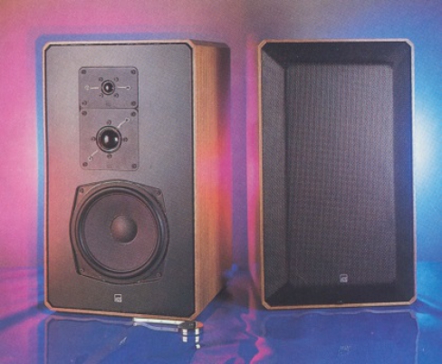

Well looks like I've solved the center channel speaker problem, thanks to Dave MM! He has an ADS L780 which will fit perfectly in the "gap" I have between cabinets, then I can use my 2 smaller ADS L10 (single dome tweeter and 6" woofer) as the side speakers. Those were originally designed to be satellite speakers but work great as the stereo spkrs right now in my office. I bought them in '80 as sattelites for my pr of L-710s. The L-10s had their dome tweeters re-built last year by John Yee in CA, a retired ADS guy. So all the sound would be quite coherent as the L780 has more bass, bigger woofer, and is 3-way, with the same smaller tweeters plus a dome midrange. ADS built all their own drivers and the liquid ferro-magnetic fluid in them give their dome tweeters + mids give them incredibly smooth and clean highs. I had the L-710s back in the day and should never have parted with them. Thanks to Dave this has the potential to be a really well balanced and excellent sounding system for our smallish living room!
- ads-l780-series-2.jpg (128.06 KiB) Viewed 4812 times
