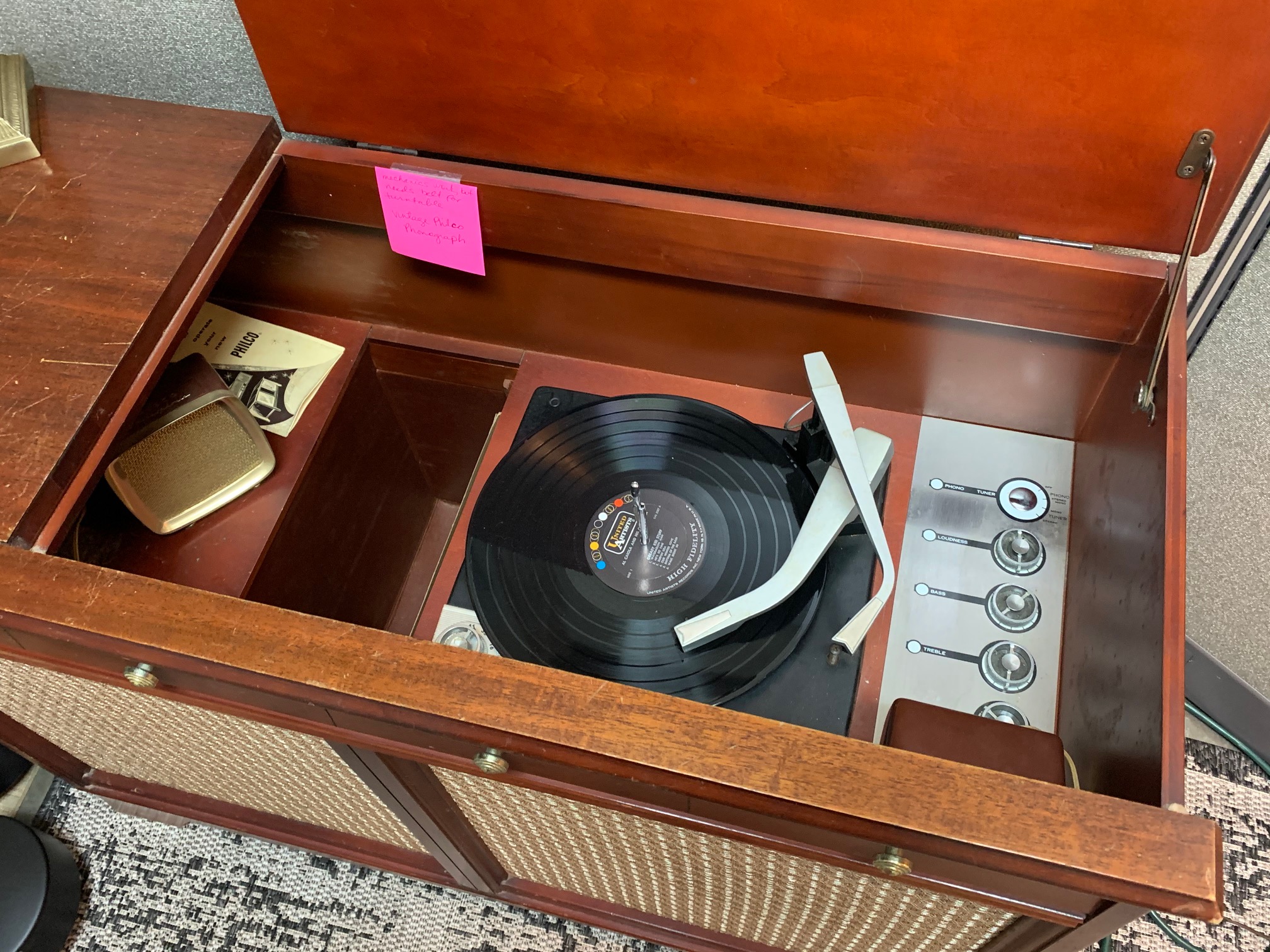

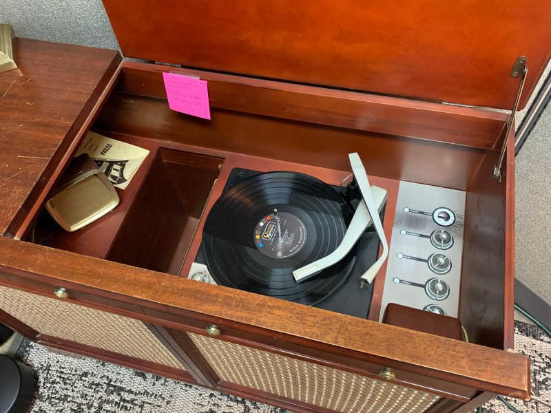

Well, Dave1138 and I installed the amp and changer
back into this 1960-61 Philco today.
All went well. The owner really likes it.
There was all the original paperwork with it.
I had discovered that the Glaser-Steers changer was a
simpler model that did not have the platter stop
action while the record was dropped down the spindle.
It had an EV-26 phono cart, as seen in Magnavox models,
but I put in a new ceramic Pfanstiehl P-226.
Both have same output voltage.
