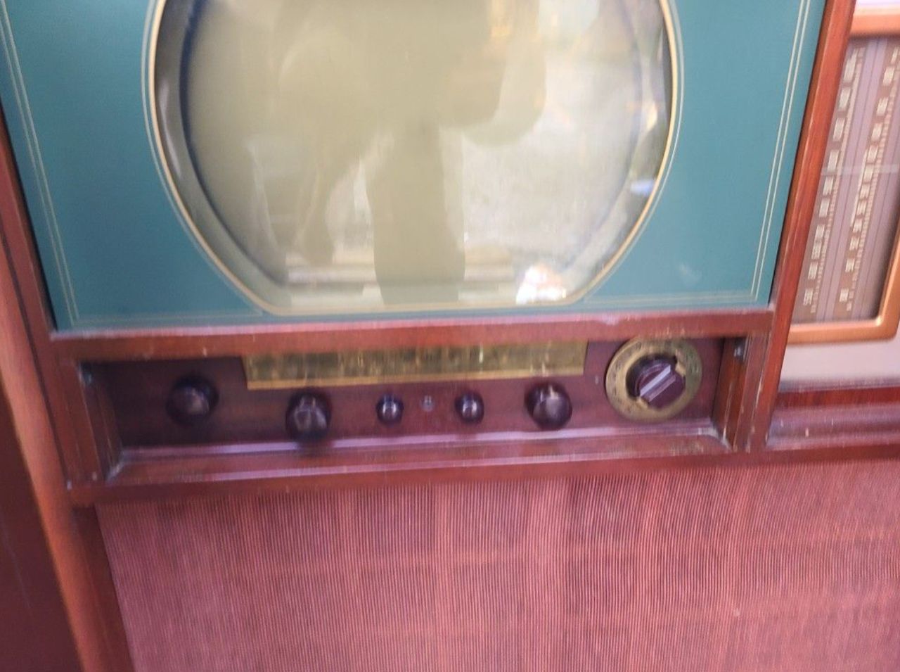

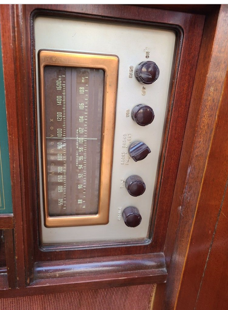

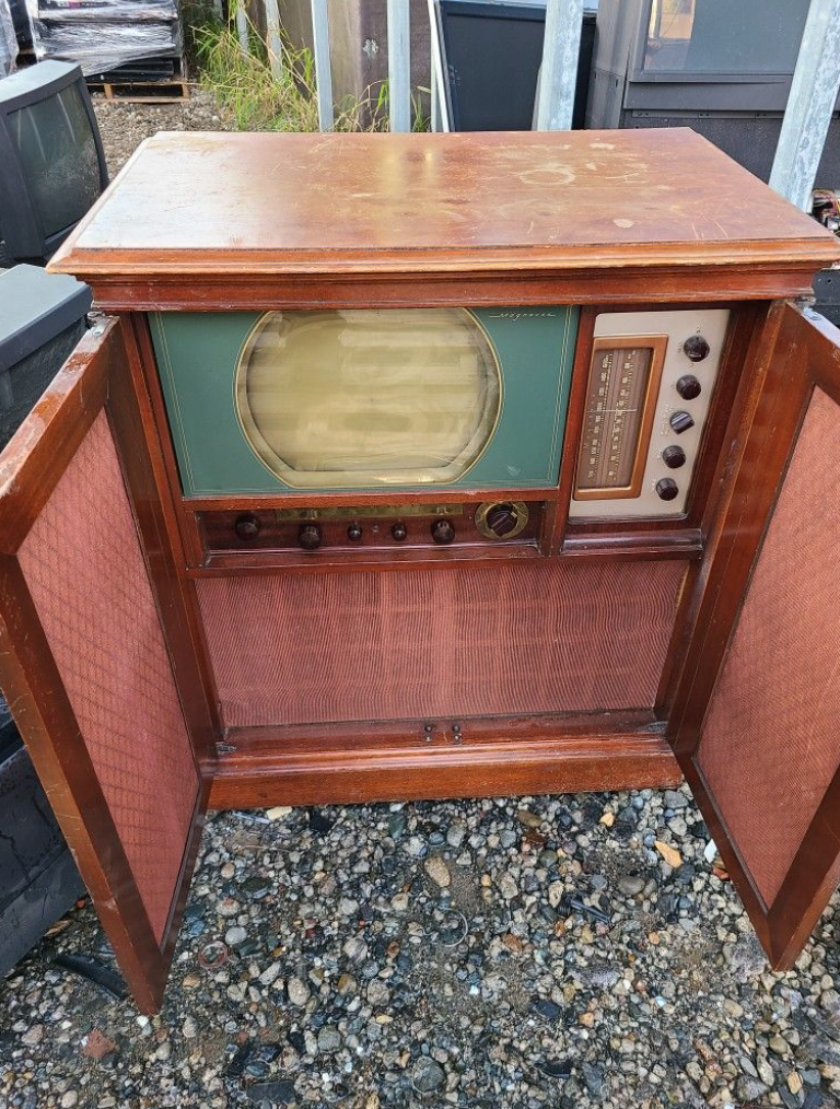

Hello Guys, I find these early combo TV's very appealing. I would like to get one to restore and get working it doesn't have to be a top of the line unit. This one the CRT seems even all across it and doesn't have the fading on the edge. (it's local) What model is this? Are we talking a monumental task to get working again. I know that depends on its condition but I am talking in general. Hydro

There should be a tag somewhere on the back, probably a metal tag, maybe on the TV chassis, that would list the model number. I would test the picture tube or have it tested, before I made the commitment. If the "jug" is bum, you might be out of luck. Otherwise, with time, patience and a bucket full of capacitors, you should be able to get it going. We would be happy to help if you get stuck. We have a member on this forum who is well-experienced with TV sets. Nothing quite like a Stereo Theater-like contraption. They are electronic works of art. You've gone thru a Concert Grand. You shouldn't have a problem getting the combo going again. Good luck.

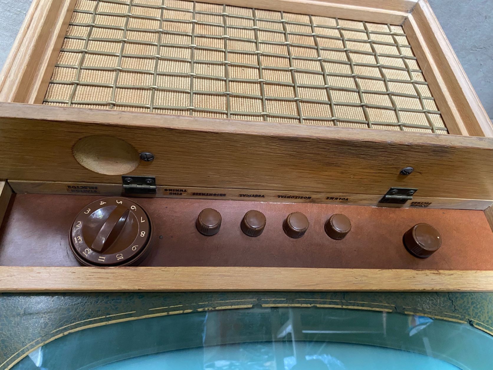

I have been working on this 17" rectangular crt Magnavox TV but this TV looks like a 12" round CRT, though the controls are similar.
The tag reads "model MV-33J" and there are no useful numbers stamped on the chassis. By luck, I found it in Sams # 151 under NONE of the numbers found on the set :( . Riders or Beitmans might have a listing by referencing chassis "CT301 or 104 series models"
The combination unit in that ad is pre-1952, missing the CD marks on the AM dial. I think it may have a similar chassis as the set I'm working on and if that is the case, I say go get it! These are well-designed and this one responded well to just a recap and repairing what I think is the original issue, an open vertical blocking transformer. I got a Merit NOS replacement from Moyers Electronics, when I was up that way last month.
