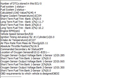

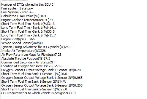

I started the truck and warmed it up twice. I recorded live data when the truck started normally using a manual trigger to start the 54 frame recording. I wanted to show the frames I recorded during a 5 second crank before starting followed with the frame during an immediate start. I'm not sure what I should be looking for in the data. See, if you would, if you see anything that should be of concern.
Re: A Question On Timing
"Engine RPM 0" on the first couple of crank times. It showed RPM of 766 on the subsequent cranks. The engine temp was 54 degrees centigrade (celcius) which may not have had the engine in closed loop. The injector on-times were okay. The O2 sensors looked okay. I'm assuming the engine started and ran acceptably. Which, if any, of the frames you showed experienced a long crank time with no start? Your scan tool shows all the good stuff. What does the book say you should have for ignition timing advance? Your data shows 0 degrees. Is the engine starting and running as it should?
If you are not seeing timing advance and if you are not seeing engine RPM, were you getting spark on the first couple of cranks you showed? Plus, your data showed fuel trim, the injector on time, but did you have fuel pressure?

Frames 1-3 were taken during the 5 second crank. The engine then started, which was frame 4. the timing was set to 5 degrees BTDC with the spout removed, correcting to TDC with the spout replaced. it starts and runs fine when it starts cold.
