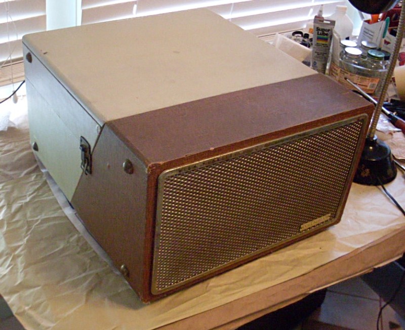

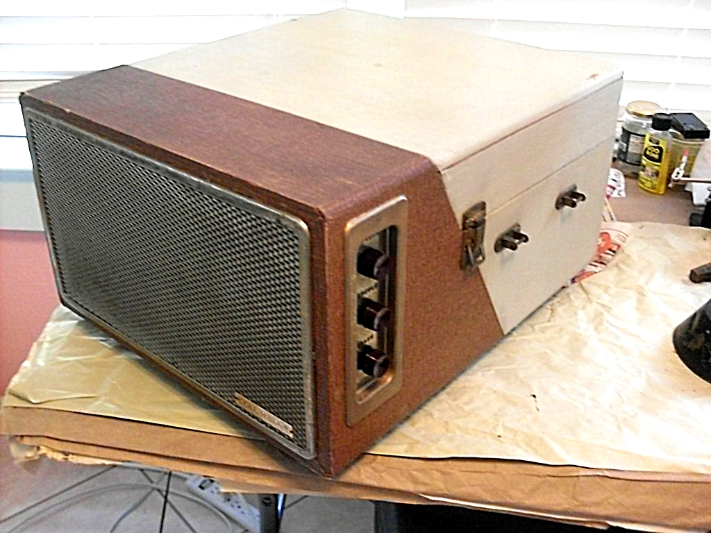

This was the other suitcase player that retained hum after
full re-cap.
I added the 10 mF e-lytic cap from B- to chassis,
and hum is gone.
This Columbia is pretty nice, with a more modern looking
tweeter, and Bass and Treble controls.
PP 50C5 amplifier.
The V-M changer is a 1210, which is stereo capable.
The Columbia has an external RCA jack, for use with
a powered satellite stereo speaker.
The original tonearm had a defunct through the end
of the tonearm turn-over crystal cart.
Because of this, I put in a replacement tonearm with
standard 1/2 inch wide mounting holes for a new
Pfanstiehl stereo cart.

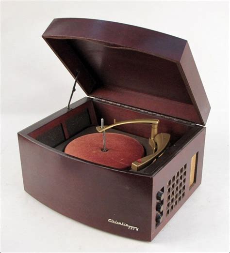

The early Columbia 360 phonos used Webcor record changers.

Is the picture you posted one of yours, Ken?
Posts: 1371
Re: 1959 Columbia 617
Post: # 9913Post Hi-Fi-Mogul »
Columbia also used V-M 950 series stylized changers
in the first 360s.
For the 10 or so, early 360s I have worked on or
owned, they were all V-M changers.
You can see one in the photo inside the
article from 1953.
I wonder what model # the Webcor 360 is ?
Ken Doyle
Posts: 211
Location: Carlstadt NJ
Post: # 9915Post Ken Doyle »
electra225 wrote: ↑Mon Sep 19, 2022 7:14 pm Is the picture you posted one of yours, Ken?
That's not mine, but I've always wanted one. I just grabbed that photo off the web.
I did overhual one for a friend years ago. It had the Webcor changer, a GE VR "Triple Play" magnetic cartridge, and an amplifier with a power transformer, unlike the ceramic cartridge and AC/DC type of amplifier found in, what I assume are, slightly later 360 Phonographs.
