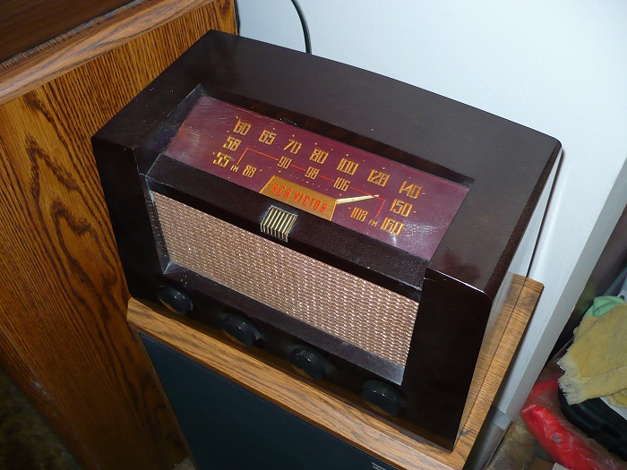

A tabletop AM/FM radio in natural bakelite. My grandfather had one of these on the stand next to his recliner. My cousin and I would listen for the school closure announcements on it. after restoration and alignment,the FM was wonky on it until I reglued a coil that had been duco cemented to the top chassis. These also came in several woodgrained colors.

Most of those early AM-FM table radios had limited FM sensitivity. FM was contemplated as being a purely local medium so they didn't aim much for DX work on the band. I'm wondering how that RCA does?

It does about as good as a more modern FM radio with no external antenna. Propagation is a bit disappointing around here as the terrain is not open line of sight with Atlanta. An antenna 10-15 ft off the ground does much better.

Does the chassis in that radio use the 12AL5 ratio detector?

It uses a 6AL5 ratio detector.
