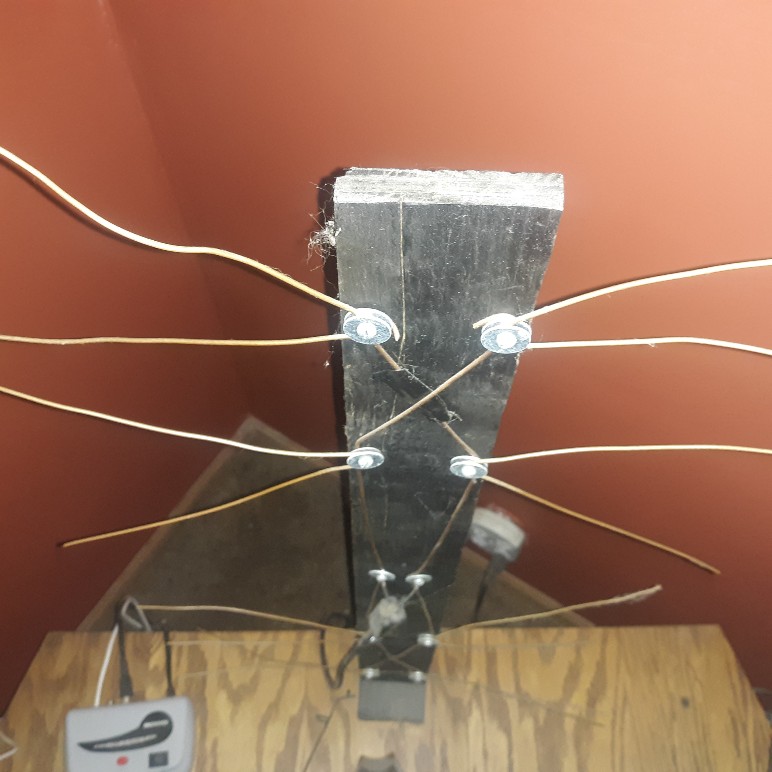

here is one I made with some 14Ga wire it stands about 3 foot tall and is clamped behind my flat screen so you can't even see it...it works pretty well only a couple channels elude me ...

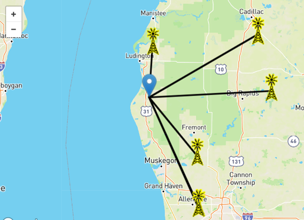

I use this website, which is pretty conservative in its calculations. For my location, I get channels that don't make their list. https://www.fcc.gov/media/engineering/dtvmaps
I plugged in Hart, Michigan and as you can see, channels are in 3-4 directions and on VHF high band (channels 9-11-13) and UHF (20-24-26-32). For FM, we have to make our own using 32 inches as a base dimension.
