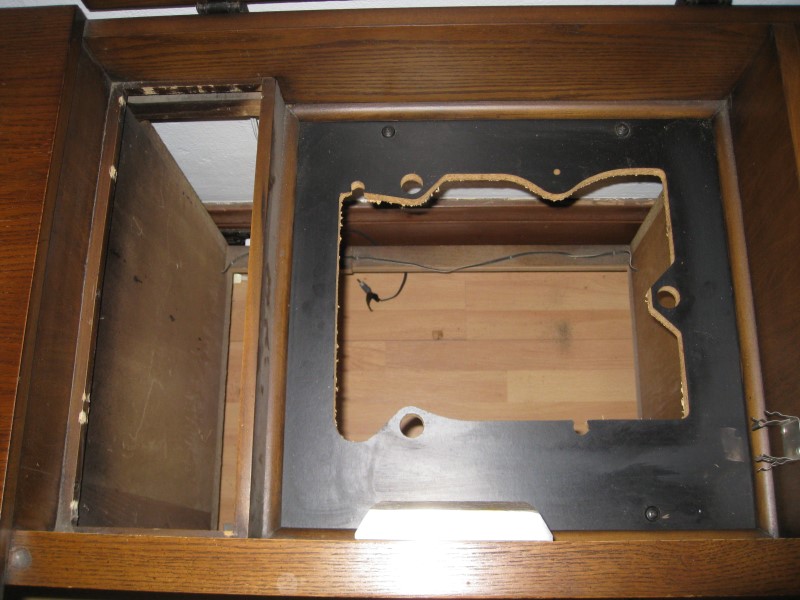

Here's what the inside looks like without equipment
HH Scott empty inside.jpg (96.28 KiB) Viewed 6166 times
Interesting thing about the changer plinth is, even the plinth is suspended on springs and it's weighted.
The changer has it own springs and mounts on the floating black motorboard (Plinth). Double isolated like an electric tool!
I did get the changer running today and all it needed was to be disassembled to clean out more lubricant/glue. Evidently using ISO alcohol didn't get to a couple of important pivot points and they were still not moving freely. I pulled the pieces apart and totally cleaned them, the re-oiled. Works great!
The receiver works great except for FM stereo, it only goes into stereo on very strong signals, and even then not all of them. Another symptom I think is related is FM takes about 15 seconds to make noise upon power up. The phono aux or AM make noise immediately, so it's only FM. All of the audio goes through the MPX board and I see audio immediately from the detector on my scope which narrows it down to the MPX board.
