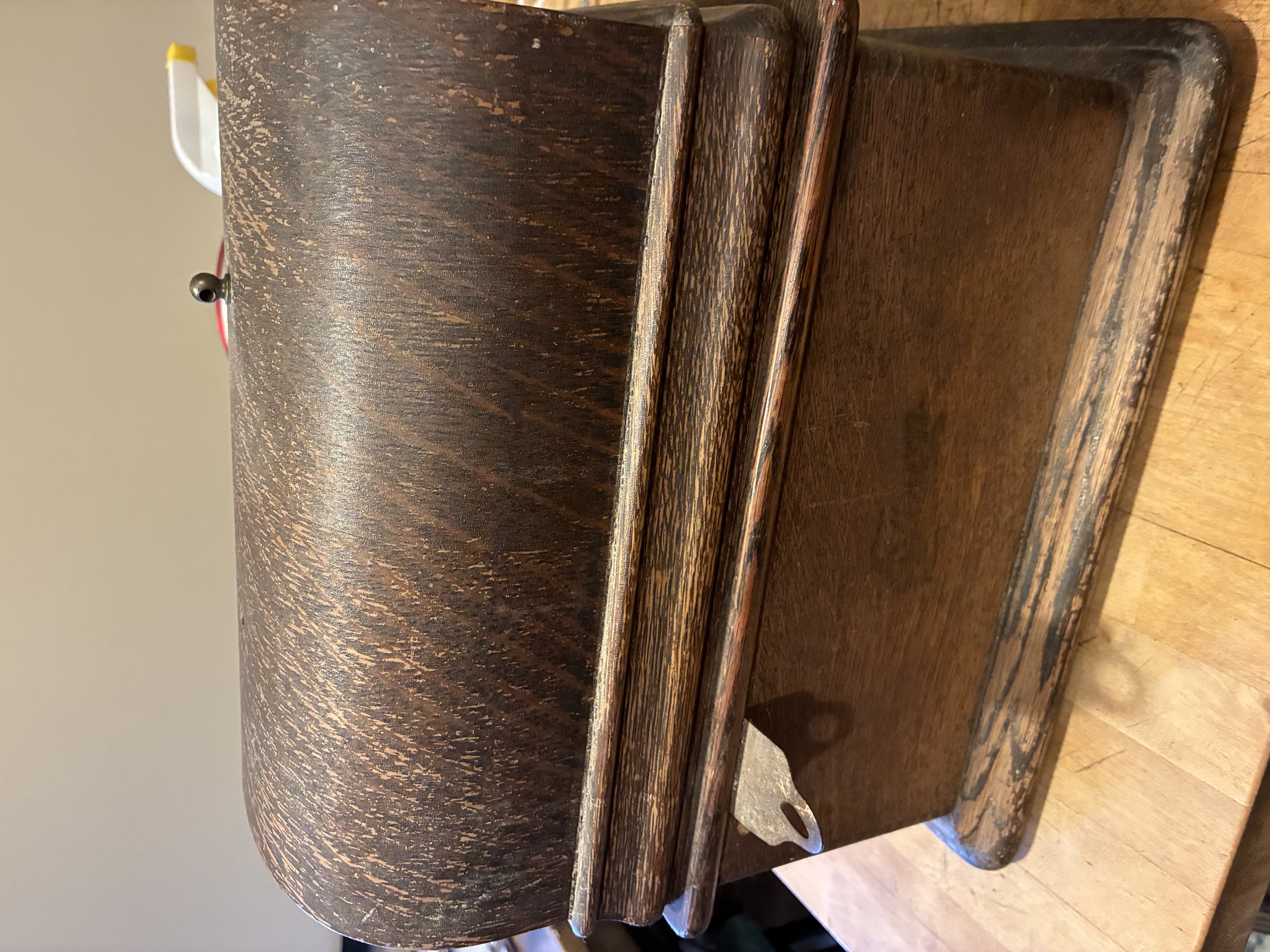

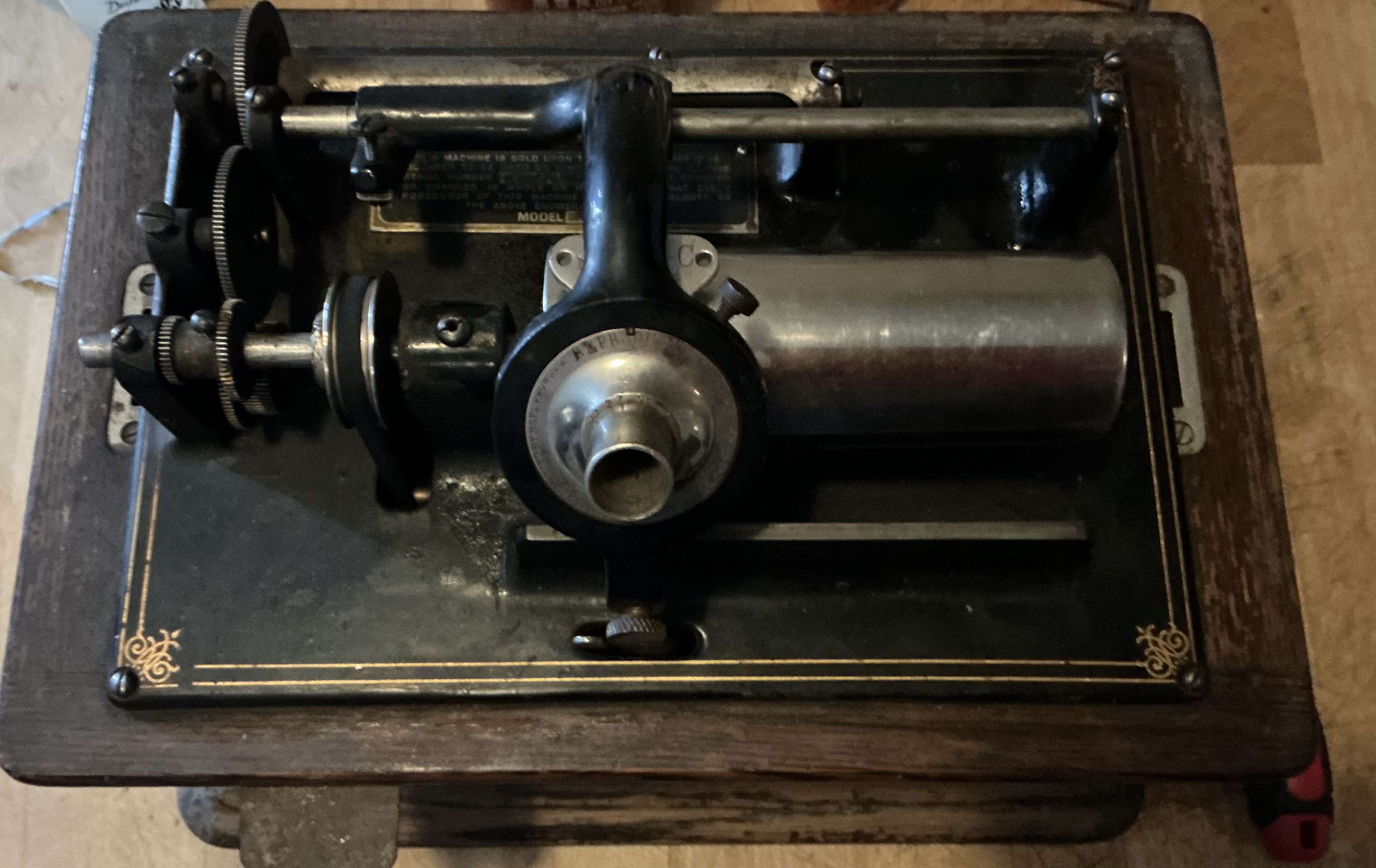

I found this at the same swap meet as the Philco. This 1909 Edison Standard D cylinder player needs a new mandrel bearing to run again! The original is made of swollen pot metal preventing the motor to spin and play a record. This contains no dangerous electronics that will zap me if I make a wrong move! This is something i'm confident on working on myself!

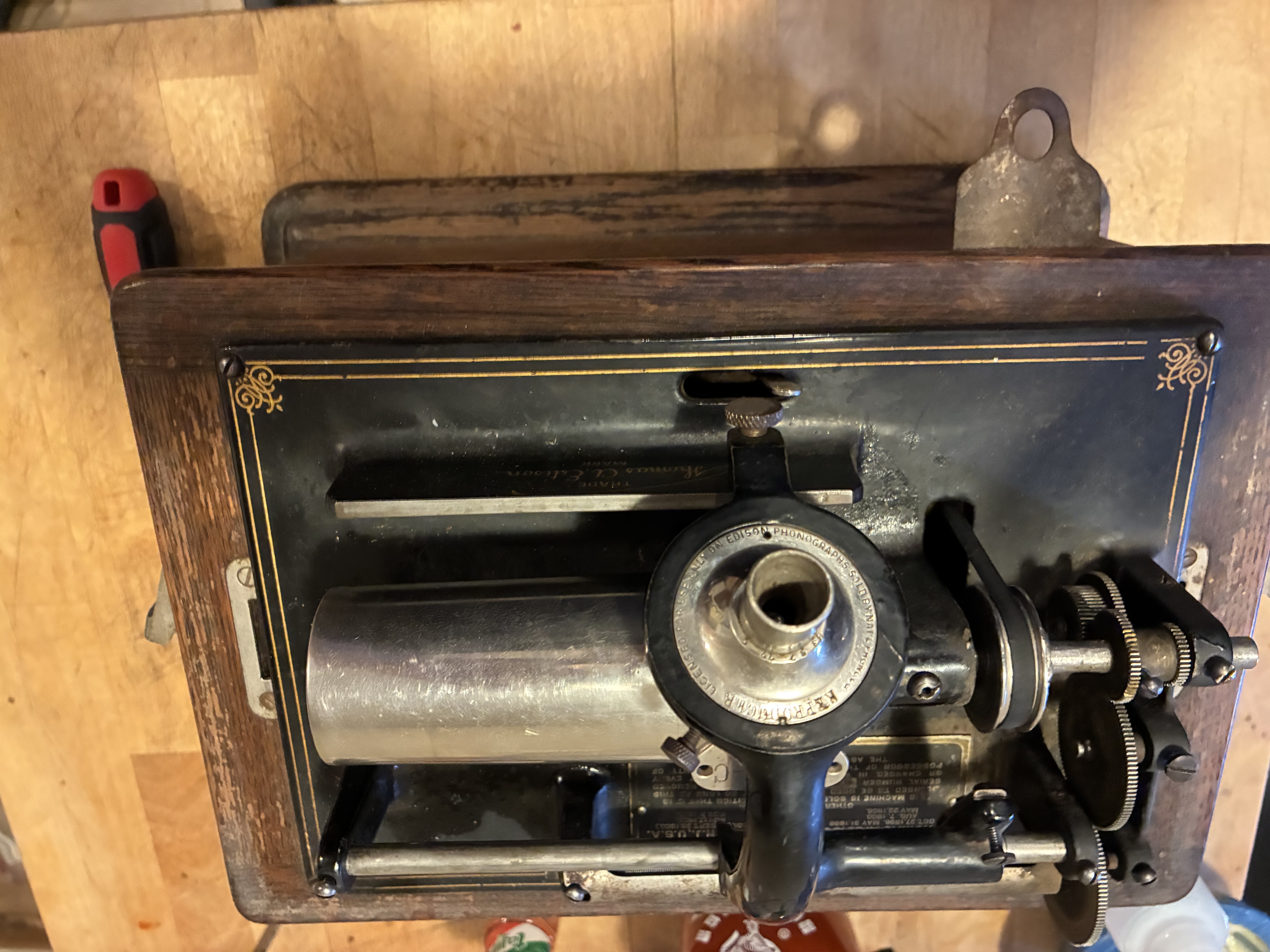

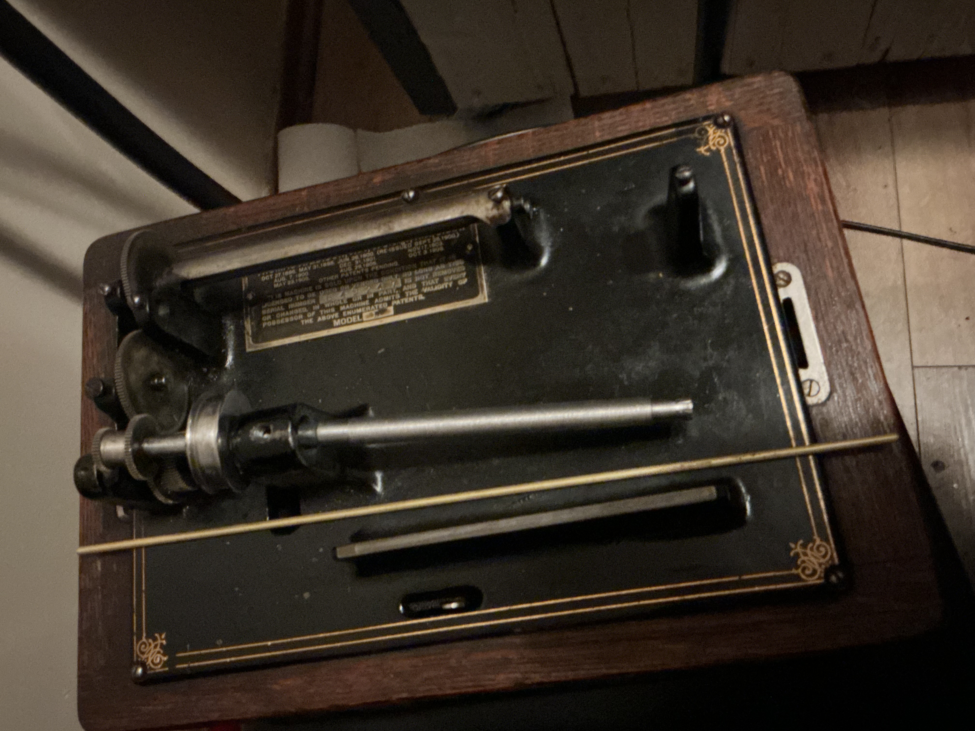

I have gotten all of the old pot metal mandrel bearing chipped away BUT the upper pulley and mandrel gear are COMPLETELY frozen to the mandrel shaft. I tried oil, PB blaster, etc and they are Not freeing up so I'm gonna try and use my soldering iron (yes I bought a new one but it's a cheap one) and if that doesn't work, I got a butane torch that will hopefully melt all the old grease thats keeping this stuff stuck.
Posts: 5398
Re: Now here's a record player even I can work on! 😃
Post: # 29400Post William »
Before you directly apply heat try a hair dryer on the highest setting. I am not a fan of direct heat, touching something, but have had really good luck with a hair dryer. Don't be afraid of getting it HOT, like hot enough you shouldn't touch it. Then if that does not work...
