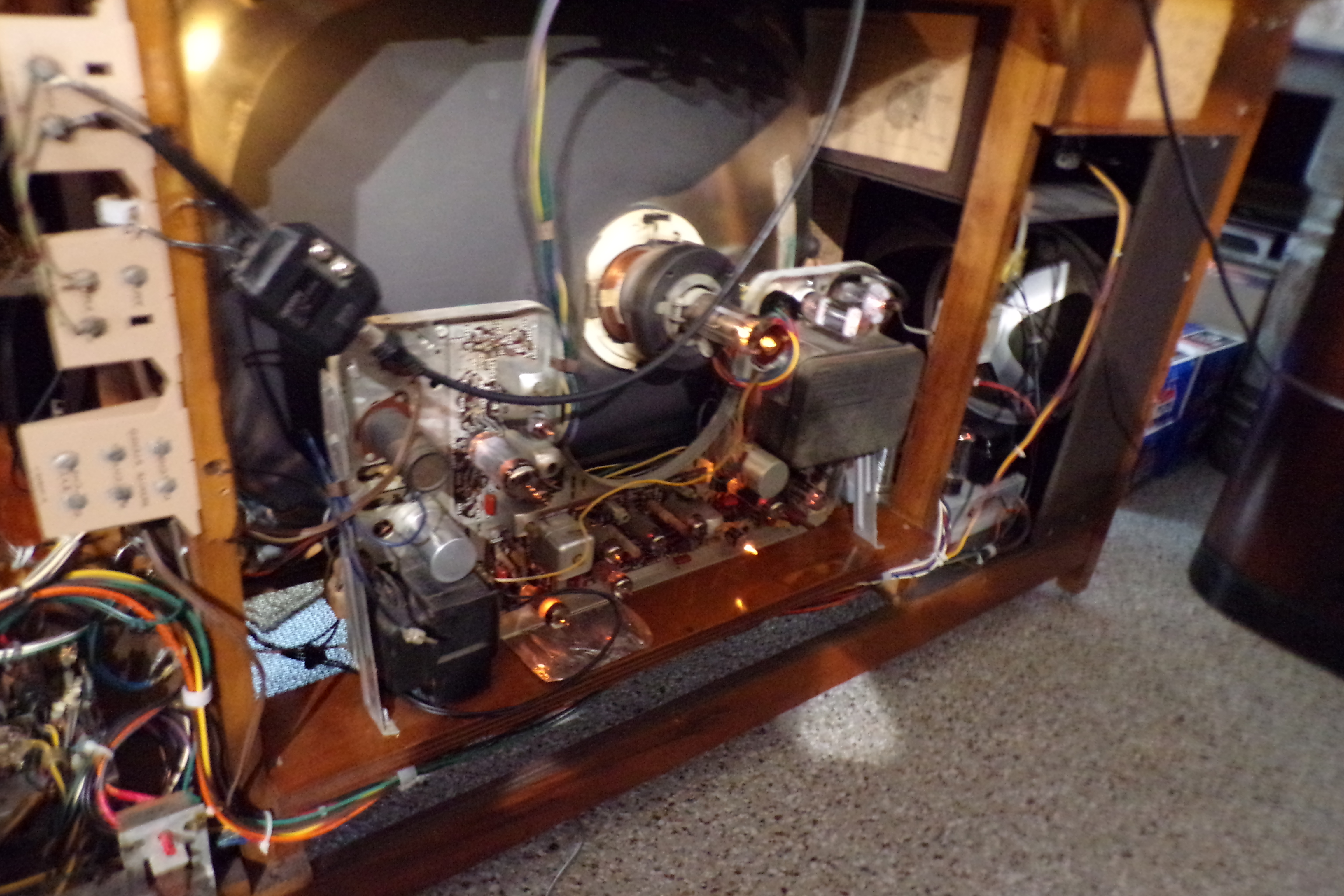

My model 2MV418 Stereo Theater is an amazing device. A beautiful hardwood cabinet. The incomparable 93 series amp chassis, lots of bass, nice bright treble. Having remote control necessitated using 12" speakers, but they give little to nothing to the 15" ones in the non-remote jobs. This ST has the largest TV chassis available in 1962, a 27". It has a beautiful black and white picture. When it works. Therein lies the rub. It seldom works for more than maybe a couple times, then it goes on the fritz, usually while turned off. It has been totally recapped, new tubes populated. It likes to lose its high voltage. One time it was a dirty brightness control. I cleaned all the controls with De-Oxit, but apparently it doesn't work on Magnavox TV sets. One time, the cathode follower tube wasn't making good contact. Wiggling tubes restored operation. I'm overlooking something. TV repair isn't my gig, my diagnostic skills are tentative at best, then I'm terrified of high voltage. A better schematic is the first step. Then I am going to disconnect the plate lead on the Horizontal out tube and do a bit of voltage measurement. I want to clean the controls, yet again, very thoroughly and maybe multiple times. Ditto tube sockets where the tubes carry high current or pulse voltages. I need to make sure the horizontal oscillator is working. Ideas?
Thinking out loud here. What about the possibility of "tin whiskers" on one or more of the controls? The brightness, horiz and vert hold controls, and the contrast control are mounted on the underside of the top rear of the cabinet. This set had copious amounts of cigarette scum on it when I restored it. How does one check for tin whiskers, what tests do I need to do? Then, how do I fix the condition? This set has something odd going on.

While I'm waiting for the schematic to arrive, I tested the tubes. High voltage rectifier, horizontal output tube, the damper, the horizontal oscillator, and the cathode follower all check good. After I receive the schematic, I'll check B+ and boost voltages. Those being okay, I need to see if the horizontal oscillator is running.

I have had issues in the past with dirty controls. I removed the controls this afternoon to check them. The horizontal hold, vertical hold and brightness controls all check okay. They move smoothly and I didn't see any breaks in resistance. The contrast control, however, shows shorted to ground. It looks like there is a mica cap across this control. The schematic should clarify the situation and give me a value. I don't see how a shorted contrast control would give me a dark picture tube. It works in the video amp circuit and feeds the grid of the picture tube (I think).....
If this control is shorted, it might stop the video, but I wouldn't think it would cause a dark picture tube.
- Posts: 8837
Re: 1962 Magnavox Stereo Theater with a busted Theater...
According to Mr. Bing, a shorted contrast control can cause a totally dark picture tube. If the control had gone open, that could also cause a totally black or a totally white screen, depending on how the circuit was wired. I need to remove the wires from that contrast control and investigate this more thoroughly. I said earlier that the contrast control feeds the grid of the picture tube. I think that should be the cathode of the picture tube is what it feeds. This set has that automatic fine tuning circuit, I forget the exact nomenclature at this moment. I wonder that that works with the contrast control circuit in some way.

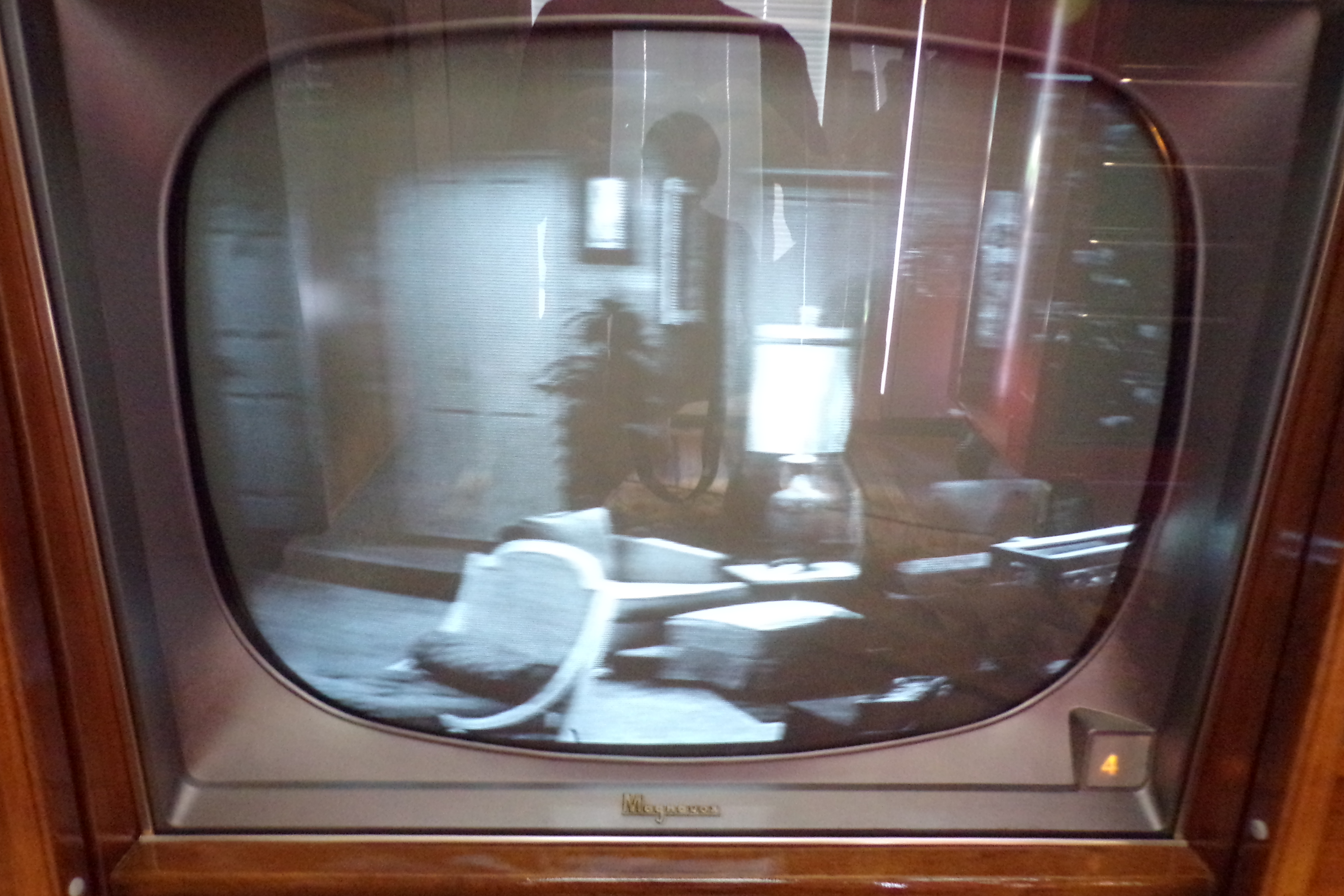

I started this discussion on the "big forum", knowing there were more "TV guys" on there. They talk way above my head, get into stuff I'll never understand. They mean well, they had just as well been speaking Russian for all I understood what they said. I have to work on TV the simple way. I have to be logical and try not to overthink something. I dreaded getting back into this set because I thought the problem was going to be complicated. I didn't consider that the issue could be fairly basic. I had so much trouble with this TV I gave up hope of ever getting it to run again. I don't know that I'm out of the woods yet. It may not work again when I try to power up tomorrow. If it does, I'll try to run it once a week for at least an hour. That should keep it going and not let little things add up.
If you look at the first picture I posted, look in the lower right hand corner of the CRT mask. You will see the tuner is on channel 4. The DVD player I was using was on Channel 3. This shows how far the fine tuning was off on this chassis. The procedure is to set the fine tuning on each channel you will use. Then, with the automatic fine tuning feature of this chassis, the fine tuning will set automatically for each channel. When I changed the horizontal oscillator tube when I restored the chassis, that changed the horizontal frequency control setting. Now I have to reset that. There is no AGC adjustment on this chassis.

Congrats! Is that the Dick Van Dyke show on your screen?
- Posts: 8837
It is. That is my test DVD. I fired the ST TV set up this morning. It came right up. I need to warm up the Analyzer and make a few adjustments, vertical height, horizontal width, maybe a touch on the focus. Watching an Andy Griffith DVD revealed that not all those old remastered DVD's are good quality. You don't want to condemn performance, nor do you want to praise performance, based on those things. I'll make determinations based on the Analyst then leave well enough alone. This stereo pulls almost 600 watts with the TV running. Seems like Magnavox could have switched the MPX off while the TV is running. We have 36 tubes hot with the TV running, won't get an Energy Star rating like that. The Magnalux feature of this set is amazing. It varies the brightness and contrast based on room lighting. When I walk past the set, the picture gets darker and lighter as I pass. The audio on this TV is amazing, never had a TV with that good of audio. The power transformer on the TV barely gets warm after running for five hours. The PT on the amp chassis, however, gets hot enough to fry eggs. I don't like that, but it doesn't seem to hurt it. Been like that ever since I've had the stereo. I'm really excited to have this thing working as well as it does. I need to consider making a modified back for the cabinet like I did for the Concert Grand. Not only does it have a "sparkly" TV chassis where the tube filaments glow brightly, but it puts out a lot of heat. No manufacturer was as good at producing sloppy wiring with mix and match components like Magnavox was. It's a wonder to behold. I can sit and look at the backside of this stereo for hours, amazed that it works at all.
