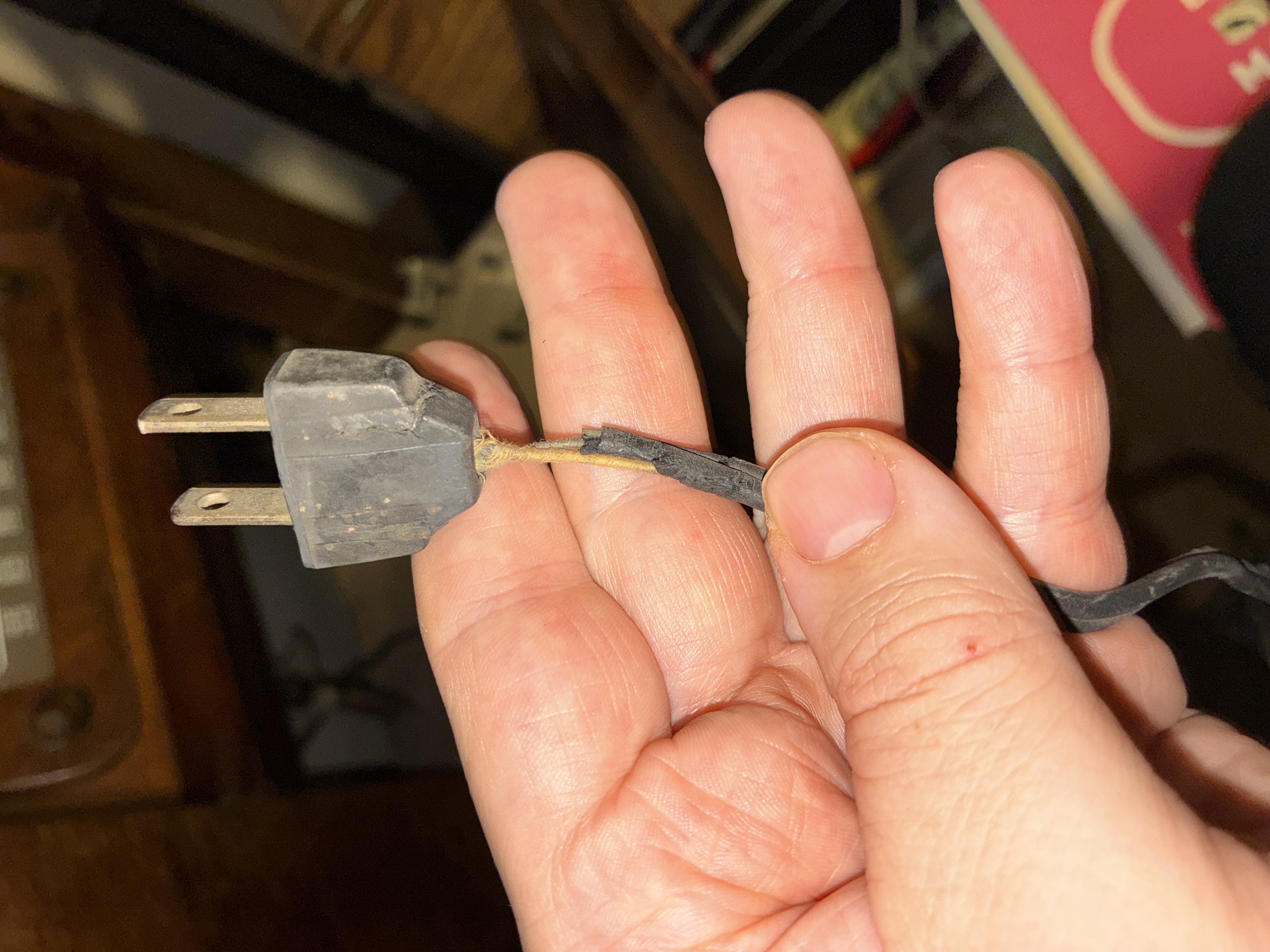

Yup, I think a new cord is the first thing that needs to be done. :roll: ;) :)
