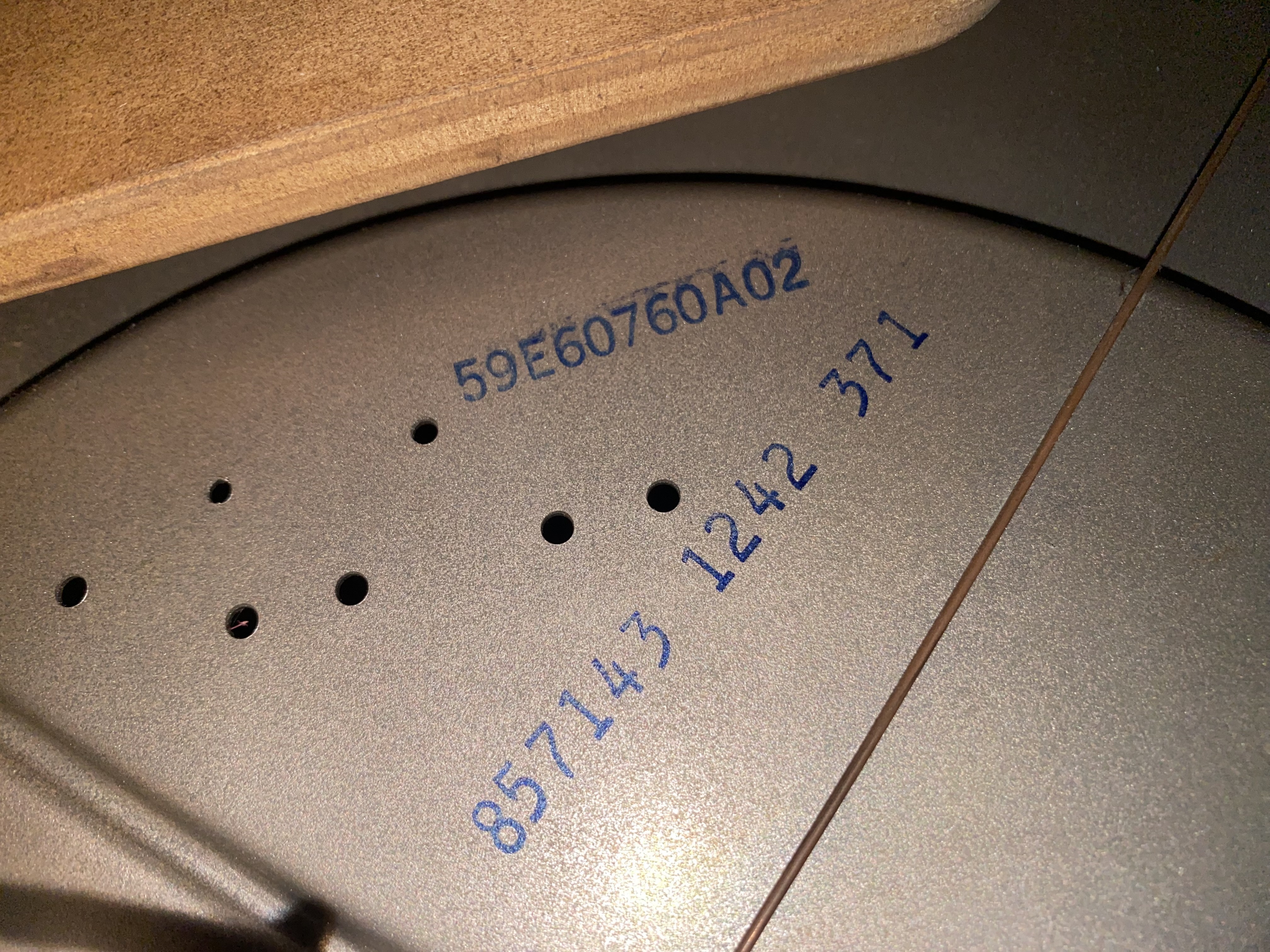

With regard to the record changer, here is a picture of the ink stamp on the underside. If I’m understanding the deciphering of the numbers based on what I saw at the Voice of Music website, the record changer is made the 14th week of 1963, and the model number would be a 1242.
I know the cartridge takes a 9T stylus which has two sides for LP or 78 records. I’m pretty sure the cartridge is good, but also pretty sure I should buy a new stylus. The stylus alone is going to be around $20-$25. The cartridge appears to be made of unobtanium, and if one is obtainable would be priced pretty close to $100.
Here is the ink stamp on the record changer.

1. Your V-M 1242 record changer: 857 (VM EIA code) 143 madeSSGNDoc wrote: ↑Tue Jul 15, 2025 3:47 am
The second point. The cartridge and stylus at least did make noise when we did the briefly powered test. I know appearances can be deceiving when it comes to electronics, but the wiring to the cartridge looks pristine, and the cartridge also looks quite nice.
the 43rd week of 1961.
I will upload the V-M 1571 manual which should have all the
functional charateristics of the 1242.

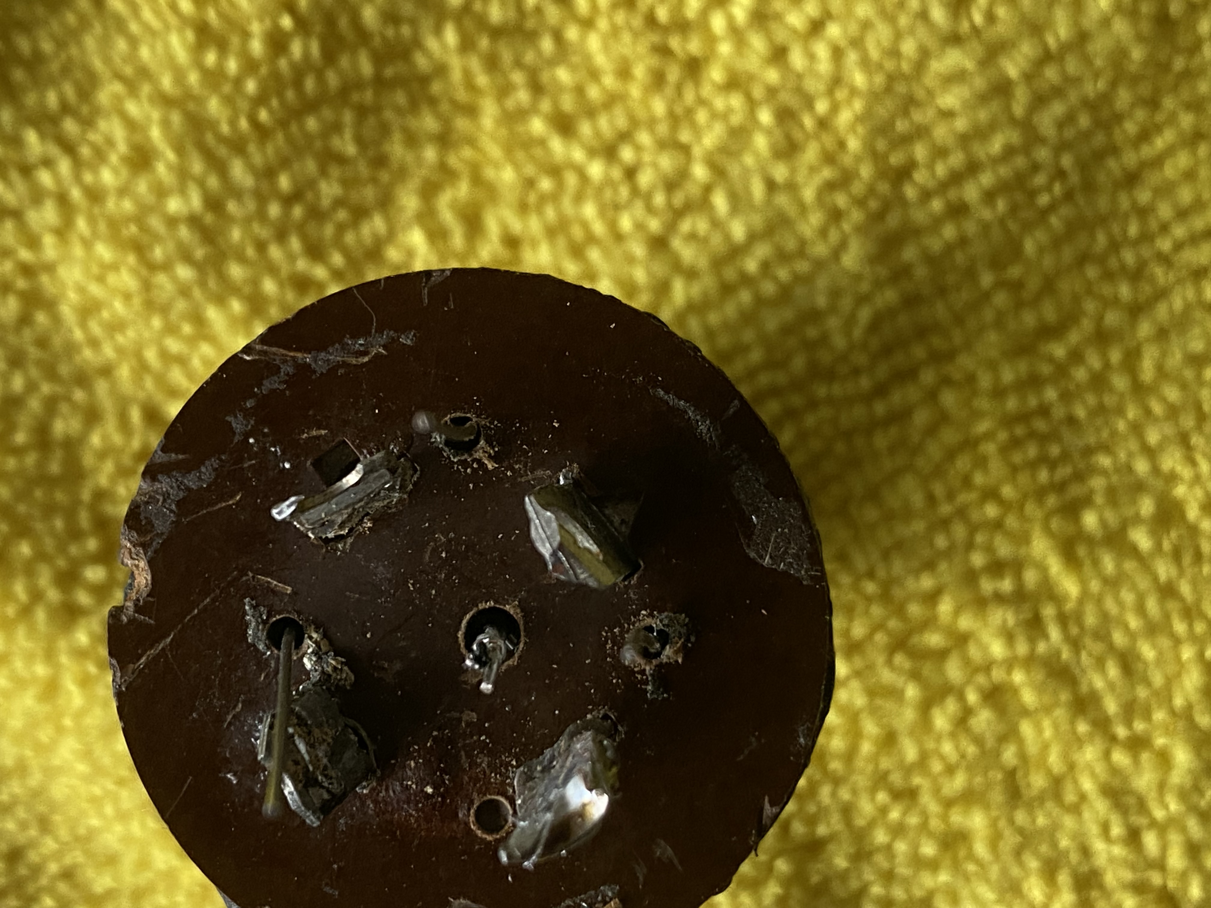

Also it looks like, whoever did replace this Capacitor soldered in two of the twist lock tabs. (The other two twits locks appear to be broken off or removed but have some solder blobs that look like they are being used as grounds. I cannot get a view of the “arrangement” of the central tabs symbols to know what is connected to what capacitance and voltage. When I try to check capacitance with my meter 3 of the tabs read below 10uF and the 4th under 20uF. So…it is definitely no good. (But I’m checking it still in the chasis, and not sure if that is truly correct.).

Most multi-section cans ID the lugs via symbols cut into the bottom insulation at the lugs--usually a square, diamond, and triangle (or maybe nothing for the 4th one). If you're unsure, trace back from the component that's connected to that tab per the schematic. Be aware that you are looking for electrical equivalence--sometimes two destination points, two solder lugs, are connected together and the cap may be connected to one of them that isn't physically at the point shown on the schematic, if it's electrically equal.

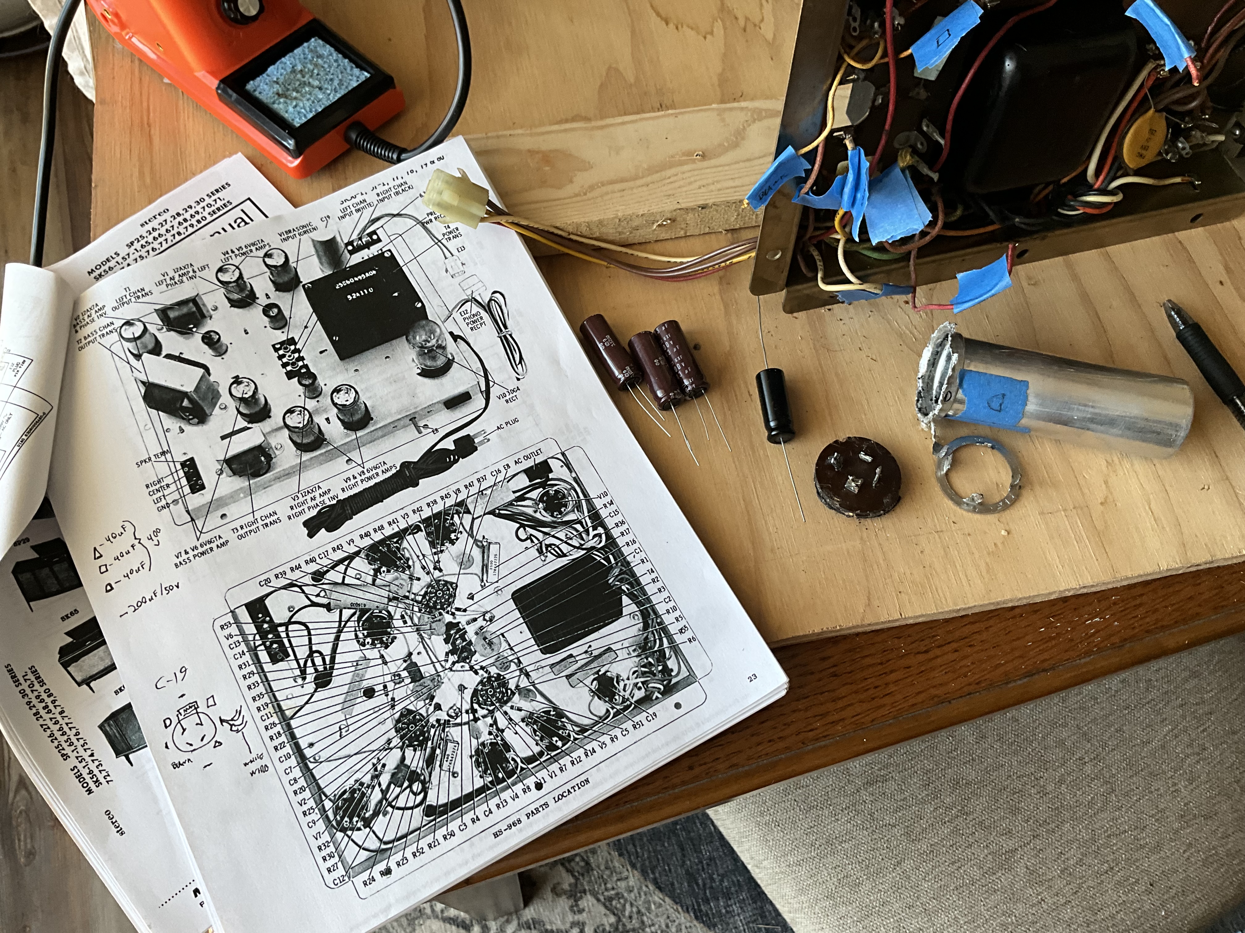

The schematic is on the opposite page. Between the schematic and the photo “map” has been pretty helpful. I wouldn’t have been able to use the photo for wiring, the photo is much neater than the underside of the actual chassis.
Having both has been pretty helpful.

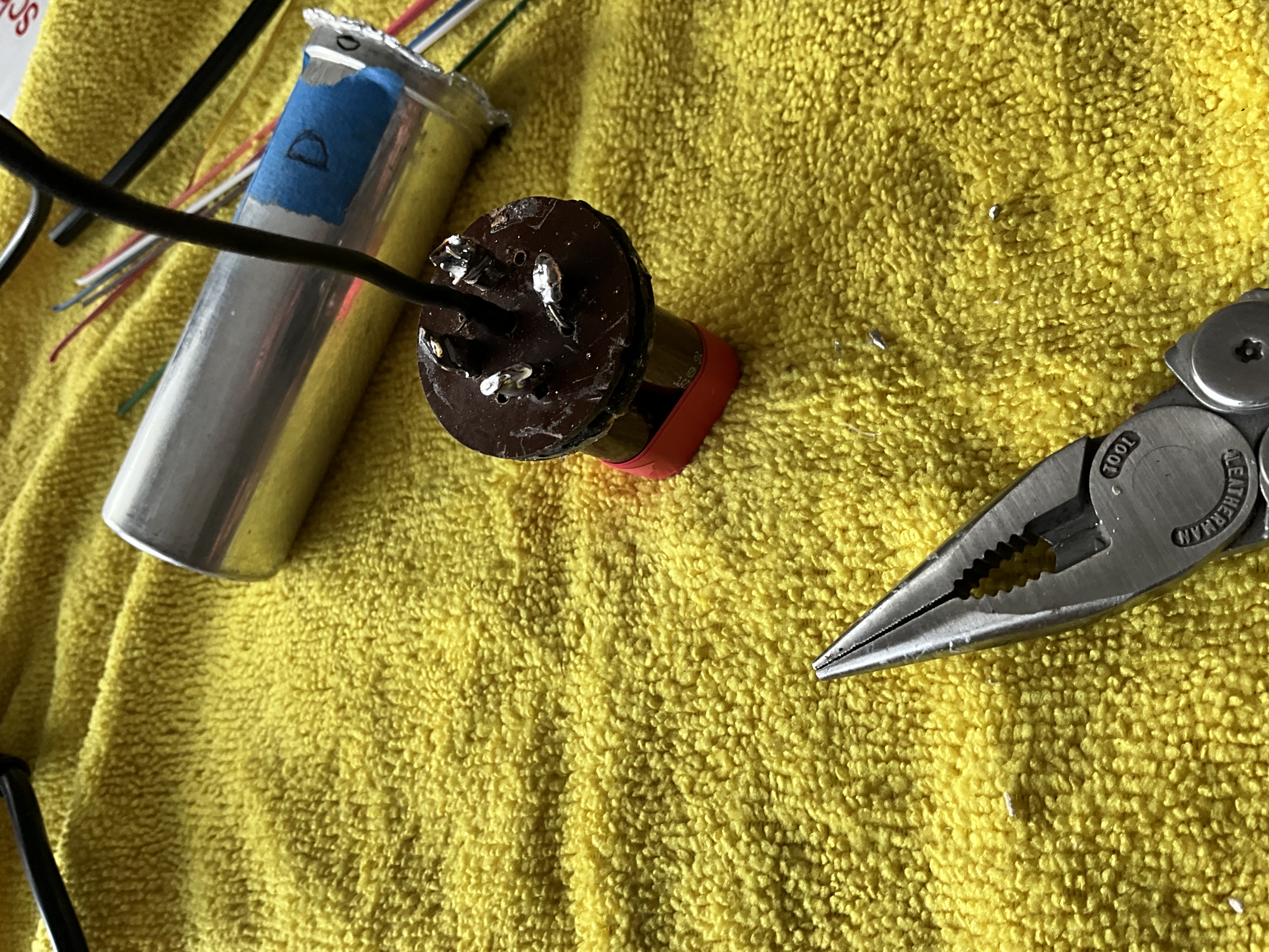

Making headway on restuffing the can capacitor. I elected to only put the three 43uF/400V capacitors inside the can. I will place a 220uF/50V capacitor on the underside of the chassis. Waiting for that capacitor to arrive (I think I found a smaller one that I ordered, which should fit better.
I think it came out pretty ugly on the underside but not too bad looking up top. But the connectors were all pretty heavily covered in solder before I ever got into it. I did butcher up the lip of the can that retains the steel ring. But that won’t be visible.

Looks good....
