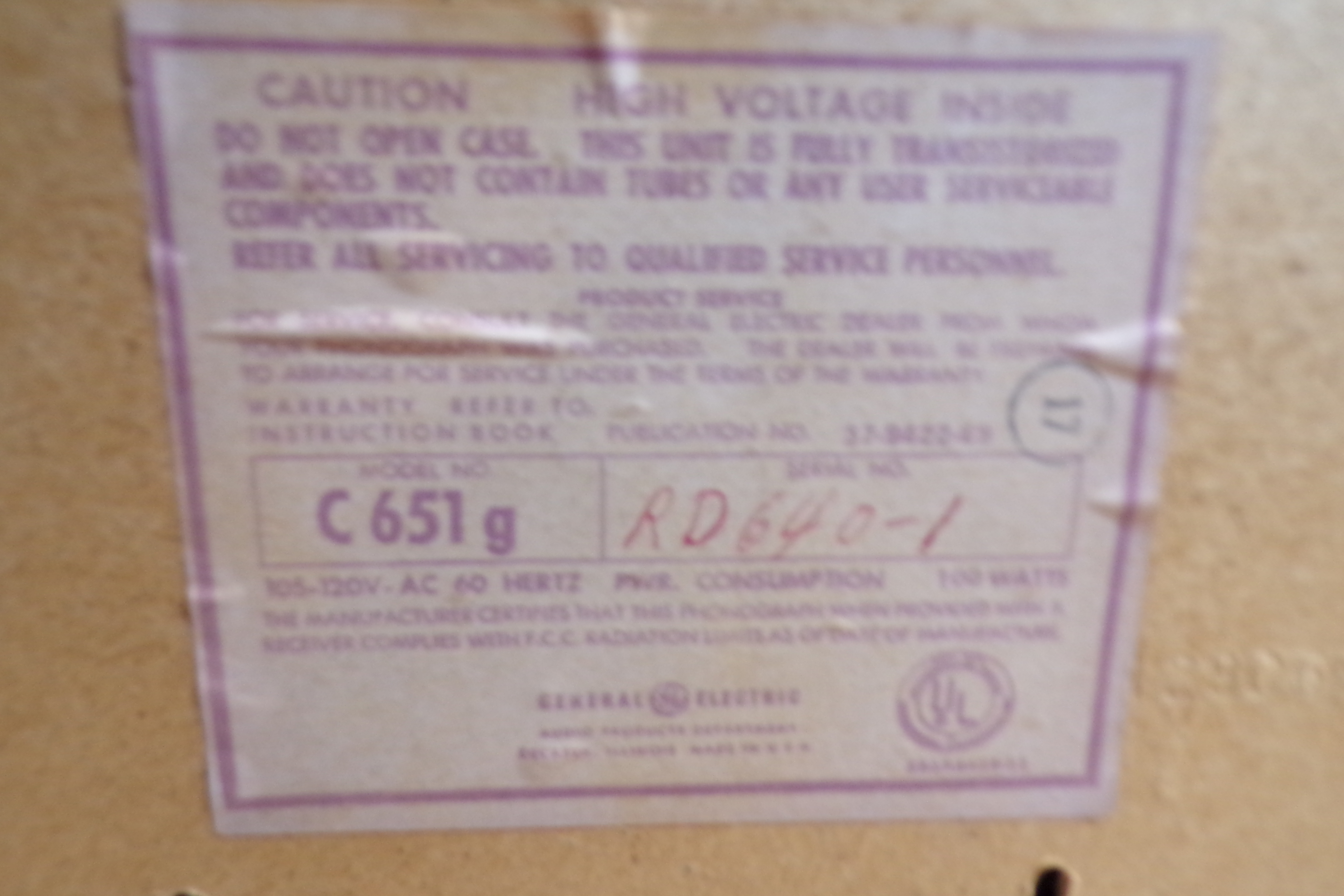

This stand-alone changer belonged to my step dad. He was a GE dealer until he passed in 1987. He was a diehard GE fan. He believed you could pay more, but would not find better electronic equipment than General Electric. He liked GE because he felt they were simple, relatively trouble-free and were easy to repair. And they were "popularly priced", i.e. cheap. This changer is like those used in the higher-end GE stereo equipment. This one is four speed, has an Astatic N-50 magnetic cartridge, and, apparently, still runs its original needle. I'm sure Sam would not have paid the price for a genuine replacement, he would have found an aftermarket cheaper replacement. The LP side of the needle is really bad. The changer runs, all four speeds works and it shuts off after the last record has played. I qualify that statement by saying the tone arm returns to rest, the knob returns to "off" the platter quits rotating, but the motor stays running until you rotate the platter one more revolution, then something clicks and the motor shuts off. Probably something gummed up with old grease. By the way it acts, the shut-off mechanism must pull the drive tire away from the motor shaft when it shuts off. I have no idea what model changer this is. To get the changer out of the base, you remove a Masonite cover off the bottom and get it out that way. There is a model number on the label, but that is for the outfit, not just the changer. It also says there are no user-serviceable parts inside....

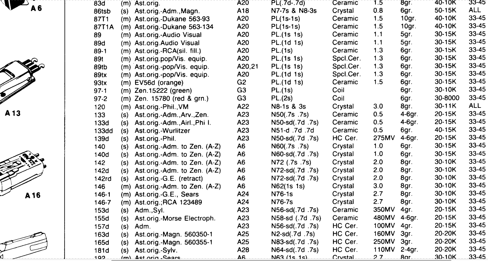

So, if I understand correctly, my "stand back and shoot it with WD-40" routine may be the best way to service this changer? Any suggestions on what the issue with shut-off might involve? I have been looking on Mr. Google and on Gary's site and I don't see any reference to an Astatic magnetic cartridge. I can still get needles for an N 50 cartridge, but is it really magnetic, or just a low-output ceramic? What is this changer worth if it is serviced and ready to go? I may try to sell this, since I don't use it.

There are several types of Astatic N50 cartridges in
their original catalog.
They all appear to be ceramic carts.

The fact that the Astatic N50 appeared to be a ceramic cartridge was my understanding as well. Thank you for the verification. Where did GE get the idea that changer had a magnetic cartridge? It's possible that this cartridge is not the original. My stepdad used this changer with a Marantz 2245 receiver which I still have. I will have to look and see if the Marantz has a provision for using it with a ceramic cartridge. I think I have a Pickering magnetic cartridge around here someplace......

As for a magnetic cartridge, it may have been original but cost of replacement may have driven a decision to use an Astatic, looks like a 133?

I haven't figure out a couple of things. One is why there is no magnetic cartridge, when the tag on the turntable plainly says it has one and there is a four-pole motor, presumably to help with turntable rumble versus the standard two-pole job. Second is how the cartridge that is there is installed. The tone arm looks like it would accomodate the standard 1/2" mount cartridge. It may be glued in. I've had this changer since 1987 and I've never done anything with it.

It certainly appears to me that the cartridge is glued in. It is obvious that the headshell is made for a 1/2" mount cartridge. The original cartridge was possibly an Astatic 132, which is a "low output" cartridge of approximately .35 volts. I have had the changer since 1987 when my stepdad died. He was using this on his home stereo, the only one he had along with a Marantz 2245 that I still have. He used a set of large, 12" GE speakers, which lasted about an hour powered by my SX-1050. When this system was new, it had a GE tube receiver with it, but he had a customer "with money burning a hole in his pocket", so he sold the receiver to his customer, then bought the Marantz for temporary use until he got another GE receiver, which never happened. The only time I have used this changer was to digitize some 78's one time. I'm wondering if turntable rumble was an issue with this changer, so somebody, sometime, changed to a ceramic cartridge as a workaround for the rumble. I don't know that, just speculation.
