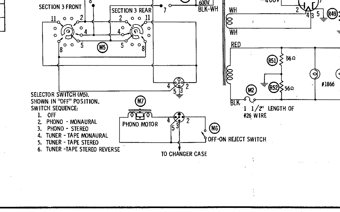

I'm waiting on the idler and drive wheels to arrive.
When I am ready to power up the motor, will I
connect AC power to pins 4 and 5 ?
It looks like pins 2 and 4 also will work,
though switched ?

Post: # 26253Post electra225 »
Correct!!

Post: # 26256Post TC Chris »
Interesting schematic--that corner shows a transformer winding that looks a like a filament supply with "1-1/2 inch piece of #26 wire" in series--to serve as a fuse? And if so, why?

Post: # 26258Post electra225 »
Maybe we can impose on Mr. Mogul to post the entire schematic. Your comment has piqued my curiosity...... ;) ;)
The 1 1/2" length of #26 wire is drawn as a fuse. But what circuit does it protect? And, is that transformer a power transformer or an isolation transformer? :?: :?:
