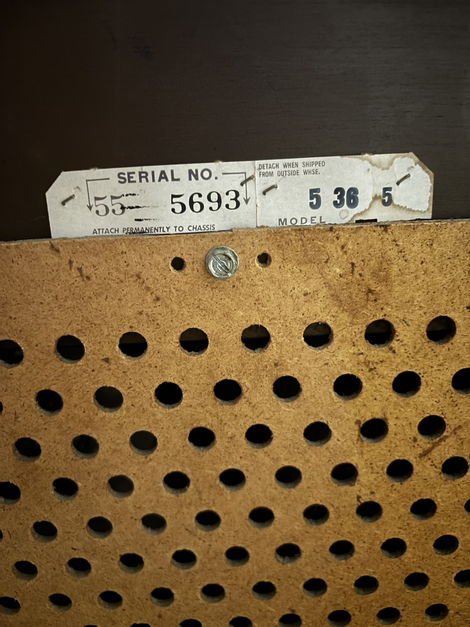

I inherited a New Vista RCA VGT 90 W K from my wife's grandparents, original owners. I've come to learn it is likely 1965. Very cool unit, much sentimental value. (we also got 100's of records with it!)
> Serial # 55 5693
> Model 5 36 5
> Serial # 55 5693
> Model 5 36 5

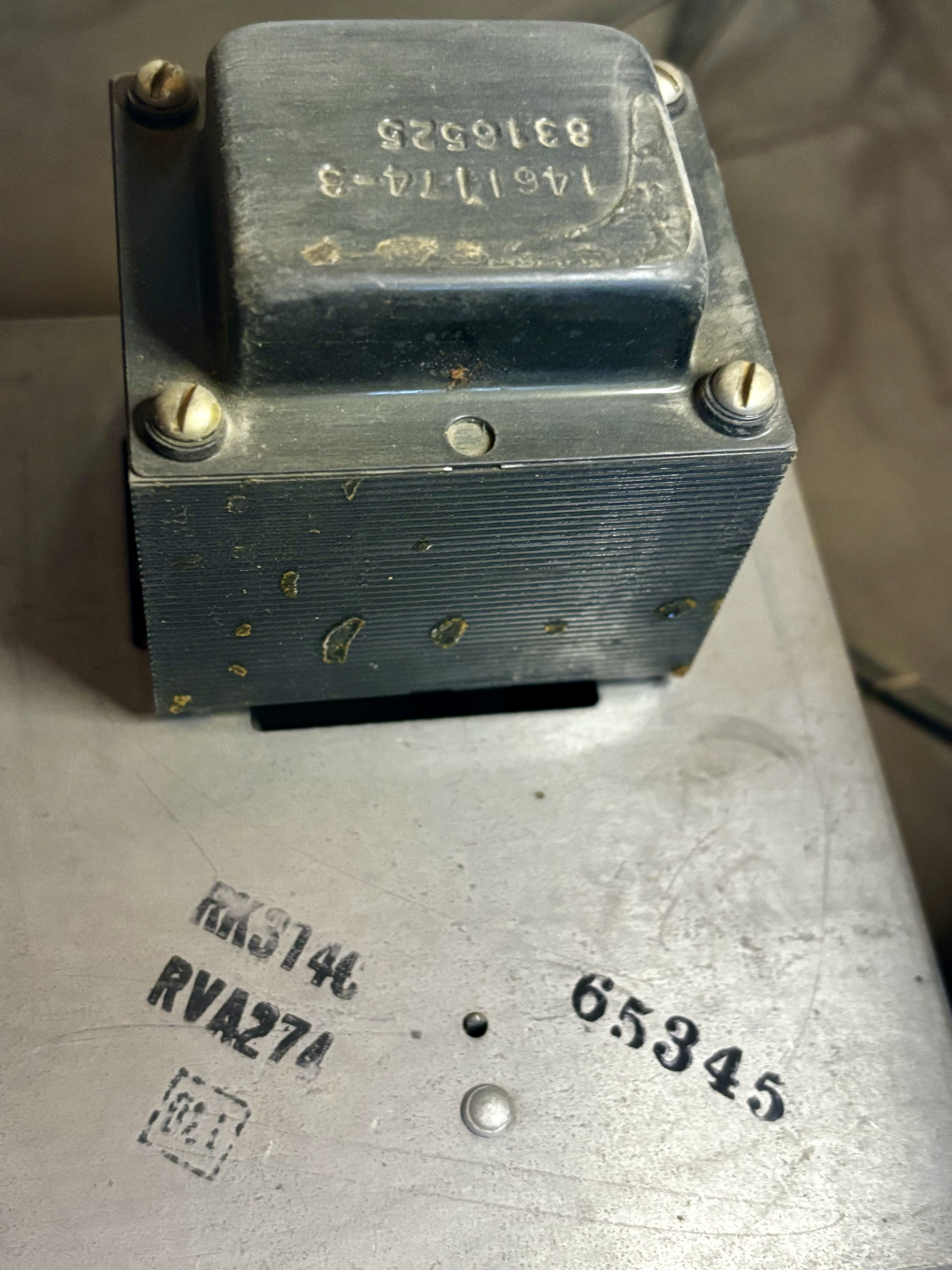

Referring to you yellowish photo, and looking at your VGT 9 0 W K model number, look to the right of your model number and notice the other numbers. If I am remembering correctly, the RS-215C should refer to the amplifier number. The RC-1223B should refer to the tuner/radio, the RK-314C should be the power supply, and the RP217C-12 is the changer. If I am wrong on that, please someone correct me.

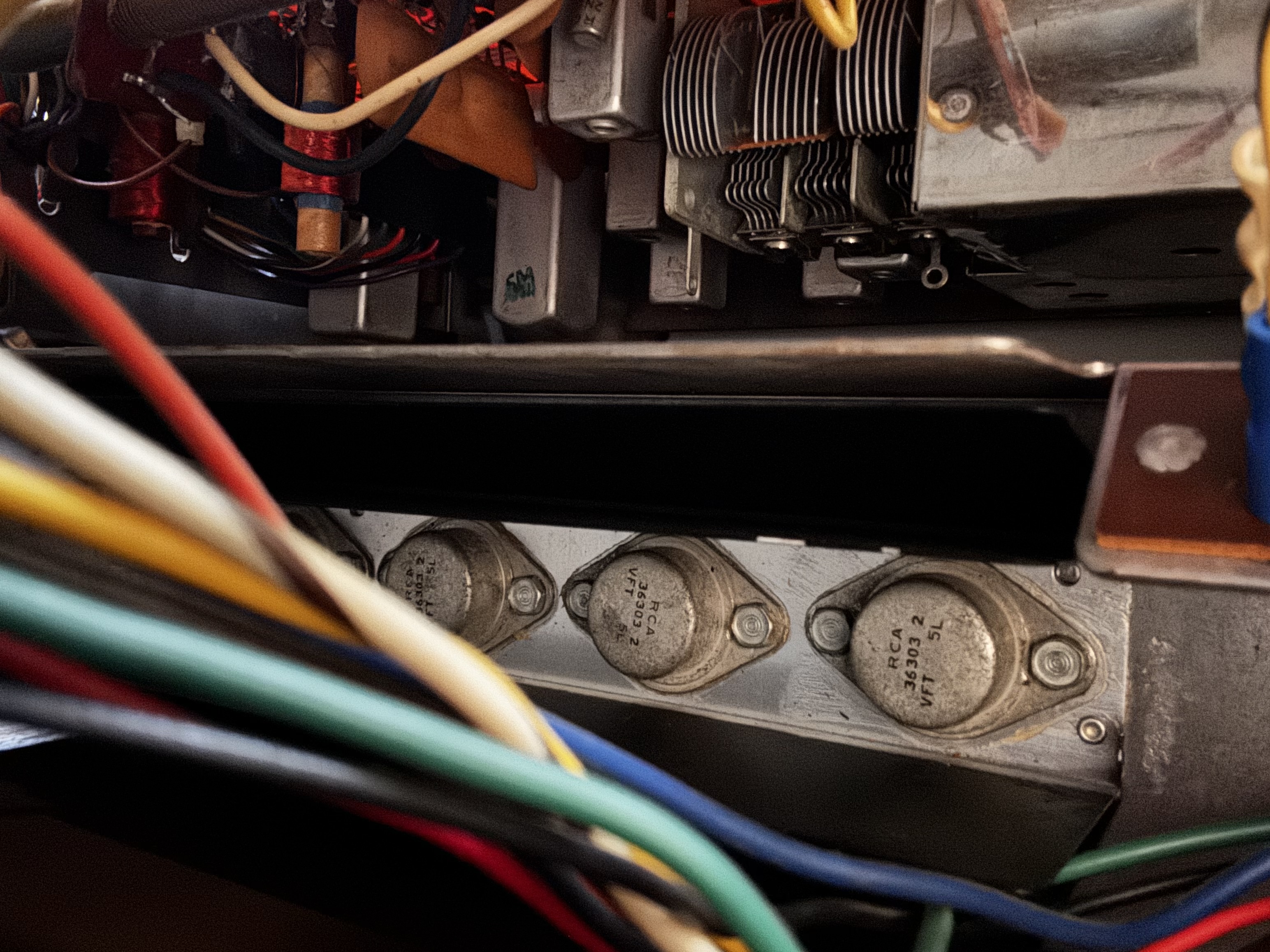

Good Morning, i’ve got the day off today. I have all my tools out, lots of extra light, and cleaning brushes, and all that kind of stuff. I have a question right out the gate, as I try to lubricate and clean these control knobs on the receiver, should I just try to get some lube up underneath the dials? Or should I remove these dials? To remove them it seems I just have to pull really hard, but I wanted to check here first so I didn’t break anything.
Thank u!
Thank u!
Re: New Vista RCA VGT 90 W K

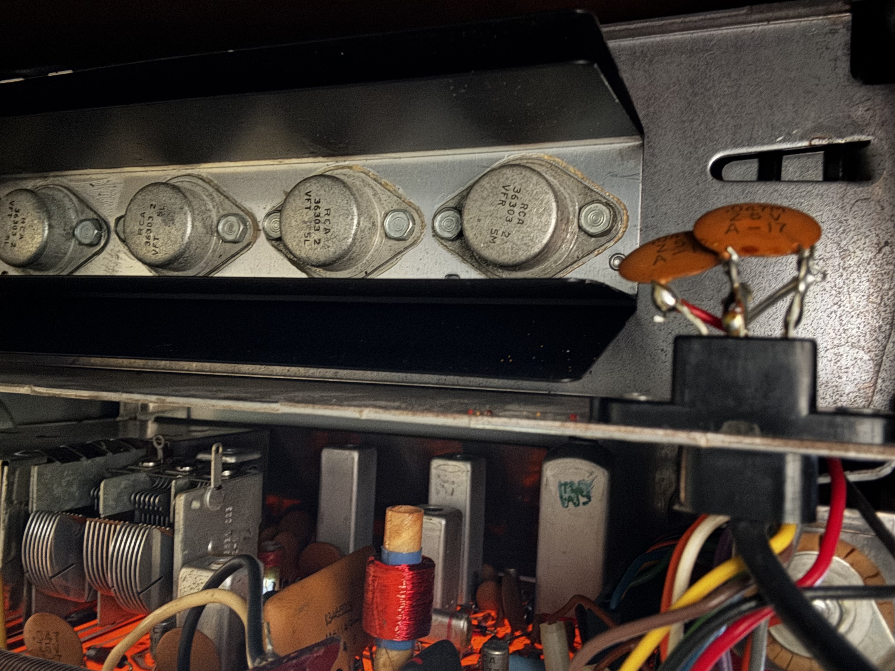

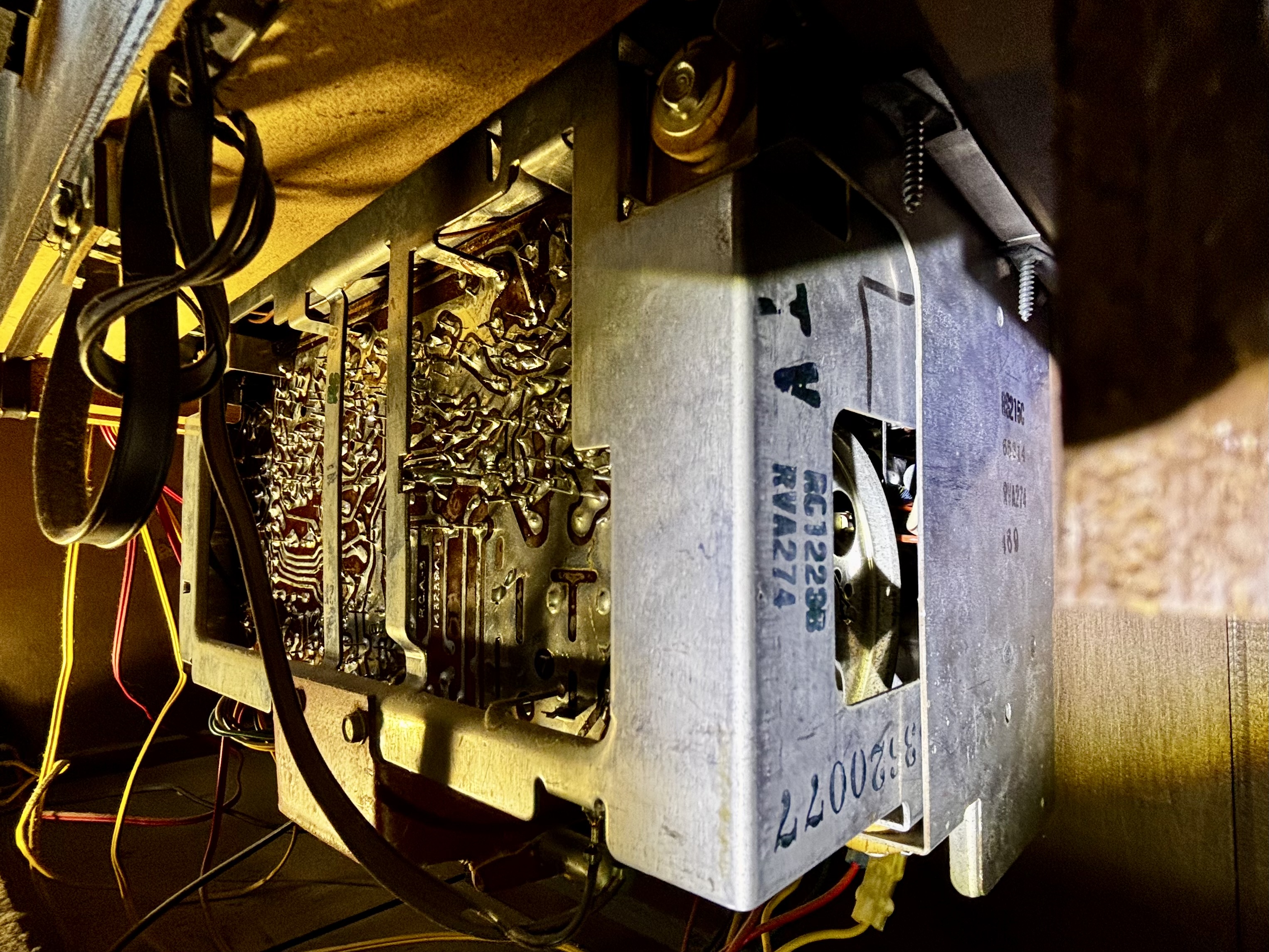

Here are some more pics of the receiver from the innards.
I’m just gonna spend some time brushing the dust out of this cabinet and vacuuming it up which I think is gonna take a while, then I’ll check back here to see if there’s any advice on next steps and/or how to get those knobs off.

It looks to me like you may have to remove the knobs and the bezel to get at the controls. It may be the case that you will have to remove the chassis to clean the controls. In any case, the knobs should be able to be pulled straight up and off. It should then be obvious how the bezel comes off. If you have doubts, post a picture of the bezel after you get the knobs off. Sometimes there are screws under the knobs that hold the bezel on. Perhaps someone else has more specific information that will help you.
Thanks, that makes sense. I will give it a go, nice and gentle, nice and slow.
The cleaning up is going well. It’s not too bad over aok and everything looks nice, no rust, no damage, no cut wires, or weirdness that I can see, but I am an untrained eye.
A wider picture of the whole cabinet, a picture of the power unit, and some more ID information stamped on the cabinet.
Cheers!
Cheers!
- Posts: 8902
Built the 34th week of 1965? Those numbers on the power transformer may or may not be useful. I realize this is not a very good answer, but, depending on the parts source you are talking to, they may want the chassis number instead if you were to have to buy a new one. If this was a tube stereo, we would be advising you to add a fuse to the primary circuit of the power transformer as an extra level of protection. The guys on here more familiar with solid state stereos than I am will be able to fill in the blanks there. You may need the various chassis numbers that you have posted if you want to order service information for your stereo. I collect Magnavox stereos and I can tell you that the model number of the stereo is worthless if you need service information. They go strictly by the model numbers on the chassis. Starting out, it might be well to do it both ways. Start out with the model number of the stereo, then, if that doesn't work, try by the model number of the chassis you are working with.
