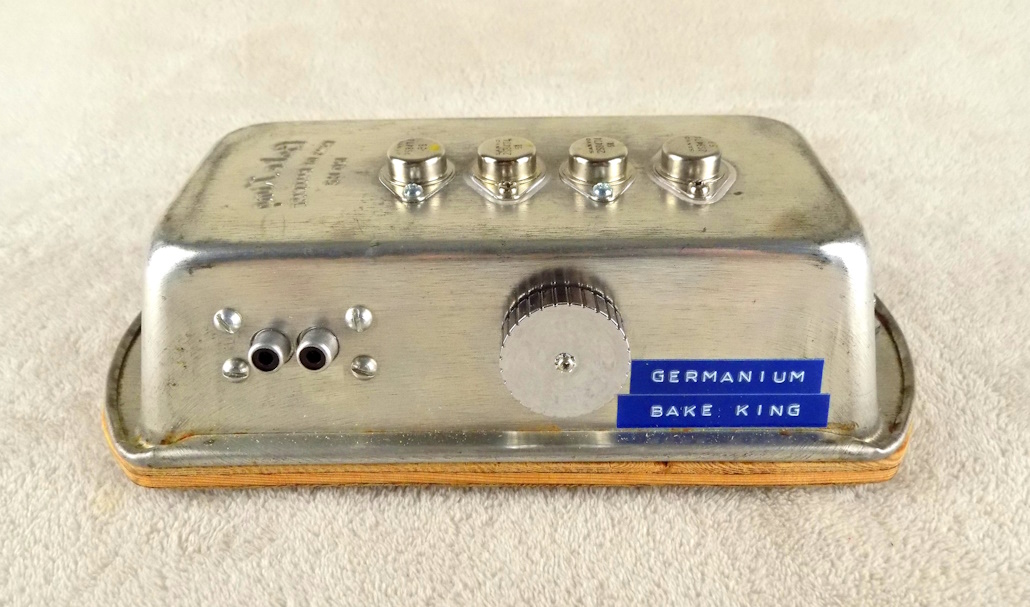

I reworked one of these as a learning exercise into a small stand-alone amplifier that I detailed in my "Germanium Bake King" project:
https://classichificare.com/viewtopic.php?t=2984
Kraco 8-track Reborn as Germanium Bake King

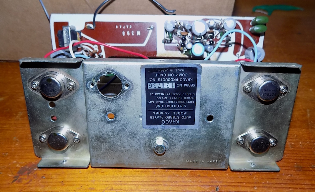

ranked lowest cost first. For a germanium amplifier you will want to look for a deck that is 8-track only, usually an earlier looking design, the more chrome the better. 😀 It should be from the late 60's or early 70's, with a boxy rectangular "under the dash" design (Not the two-shaft through the dash design). You should see only volume, tone, and balance, with no radio dial. Once you get into the late 70's with AM or AM/FM designs they have moved on to silicon transistors or integrated circuits- also fun, but not my focus here. If you want to be really sure, find the ones where you can see the power transistors mounted on the outside of the rear panel like this Kraco:
Rear of original Kraco KS-408A 8-track (w/Transistors)
You might even be able to see a transistor number and look it up. Even if you can't see the transistors on the outside, if it's 8-track only, you stand a good chance, and it is worth finding one with the transistors inside, as they will likely be fresh and clean looking like new, unlike the external ones that are often corroded.
Anyway, happy hunting, and please share you results or thoughts. -Warren

Thanks for sharing, Warren. So, what transistor is missing in you Kraco photo/

It does look like that doesn't it! That was where the Power/Speaker connector plug was. Only four output transistors, rest were mounted on the PCB.

Post: # 24657Post William »
I sure does look like a transistor hole. I thought maybe it was some kind of a transistor rectifier or something. I have yet to tackle transistor stuff, have enough trouble with tube amps and especially radios. I do enjoy reading your posts and trying to figure out what you are doing. Maybe someday down the road I will get there. Thanks for sharing.
