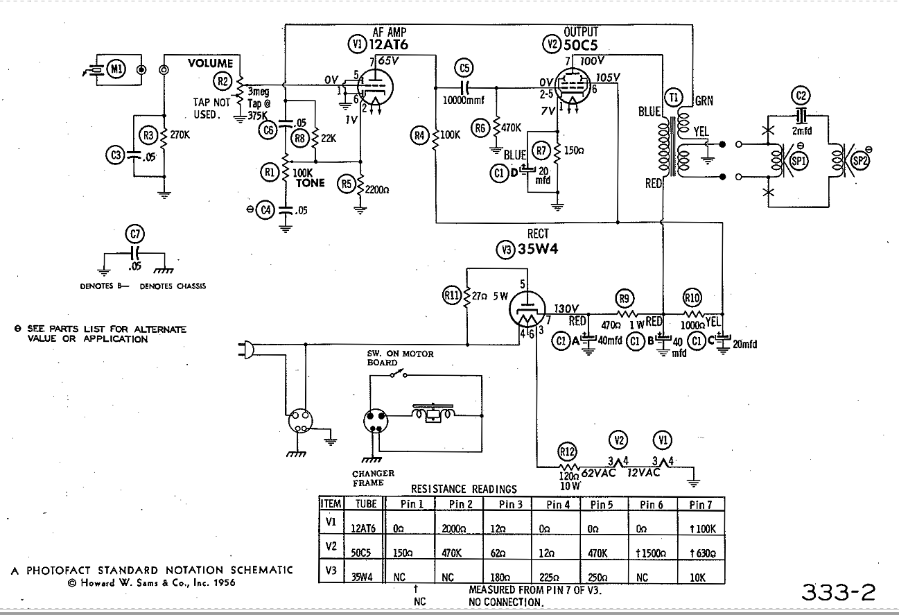

What is the purpose of R11 ( 27 Ohm 5 watt resistor )
b/t the 120 house VAC to the plate of the 35W4 rectifier ?
Today this basic info eludes me.
- Posts: 9078
Re: Airline-Ambassador Resistor Question
To control current "in-rush". The idea is to soft-start B+. They can also run a higher-capacity input filter cap to control hum. Sometimes, you find that resistor after the cathode of the rectifier.

Oh yes, that's the location I was more familiar seeing.electra225 wrote: ↑Thu Oct 31, 2024 5:01 pm To control current "in-rush". The idea is to soft-start B+. They can also run a higher-capacity input filter cap to control hum. Sometimes, you find that resistor after the cathode of the rectifier.
Thanks !
Exactly. It does also provide a continuous voltage drop in operation to reduce the B+ somewhat.
Neat little record player. I dig the negative feedback coming from the audio transformer secondary winding back to the tone control in the 12AT6 cathode circuit. How does it sound? Pretty good I bet. I see all of the capacitors are in one can- Do they work? Have you tested those?

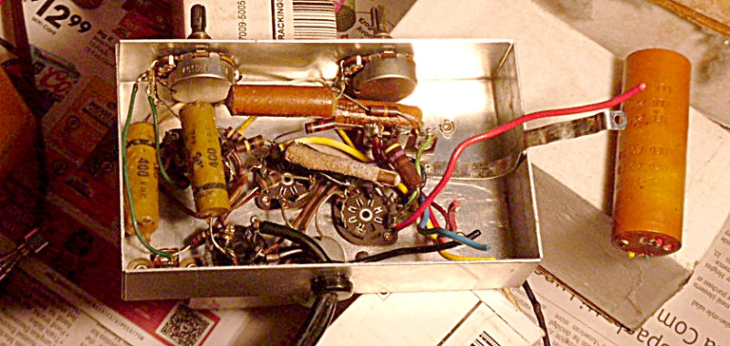

I powered up the record player to make sure there waswparks wrote: ↑Thu Oct 31, 2024 6:59 pm Neat little record player.
no motorboating like in the AMC.
The usual bad e-lytic filter cap hum is present.
The 12AT6 tested weak, and I had a replacement.
I drilled out the rivet/band holding the multi-value
capacitor.
The 27 Ohm sand resistor is degraded as they do,
so it will be replaced.
Will check the resistors and wiring,
then on to the re-cap.
- Posts: 9078
If you would care to have a tad more gain, replace the 12AT6 with a 12AV6. I would also replace C1D, the cathode bypass capacitor with one of higher capacity, probably a 50 uf at 50 volts. This tends to reinforce the "bottom end" of the amp, as far as bass response is concerned. I like using 50EH5 in record player amps in place of the 50C5. It takes less grid voltage to drive a 50EH5 to full output, but that's just me. This may be more important when there is no first amplifier tube.

I did a temporary wire up of the e-lytics, and upped the C1(D)
cathode cap to 47 mF.
It did help some on the mid-range notes. I'll use that value
when I solder it all up.

- Posts: 9078
I think you meant to type 12AV6. The 12AV6 was a new tube in 1953, IIRC. The 12AT6 appeared in 1946-'47. I read an article one time explaining why the AV6 was advantageous to the AT6. Higher gain, lower noise and something else that I forgot were the main differences, since they did the same job. I always try the AV6 and many times have found advantage to using it. GM car radios used a 12BF6 instead of the AV6 due to its tendency to have less microphonics in equipment that was subject to jarring, such as a radio mounted in the instrument panel of a car.
Also check R7, the cathode bias resistor. It needs to be right on value, 150 ohms. If it has drifted high, that may cause the output tube to conduct more heavily, which can put the audio output transformer in jeopardy. This may not be a huge deal on a small record player amplifier, but it is good general practice to check this resistor and be aware of it's purpose in the circuit.

1. The cathode bias R7 is right on the money.
2. Tonight I hand drilled two holes to mount the
terminal strips for the 4 e-lytic caps.
I added some electrical tape pieces on the
chassis' sides where the terminal strips will be
for added protection.
3. Tomorrow to solder the caps' leads onto terminal strips, then
solder on B- connection wire and the 4 wires
to the e-lytic caps' positions.
I'll also replace the 27 Ohm 5 watt sand resistor,
then hopefully have a successful power up test.

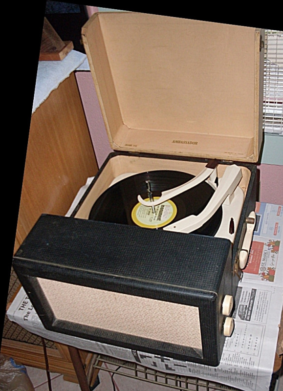

Re-cap finished and all re-assembled in
the cabinet.
Sound is very good.
With the 5 inch speaker, it puts out more
than enough volume.
A couple of minor tweaks, and then I'll run her
over to the record shop for consignment.
This Ambassador is the same unit as a
Wards Airline GAA-954 from the same year, I have.
Will probably attend to her next, since I'm familiar with
the setup.
The V-M 954 changers are identical in both.
From the code I supplied, Gary at V of Music said
Audio Industries were the buyers of these V-M 954 changers.

- Posts: 9078
The cabinet on that record player is a LOT like the one on the Magnavox TP-241D I have. The blanked-off corners on the cabinet are unique. I wonder if they were built by the same company.
Nice job! Somebody will enjoy it for many years to come.....
