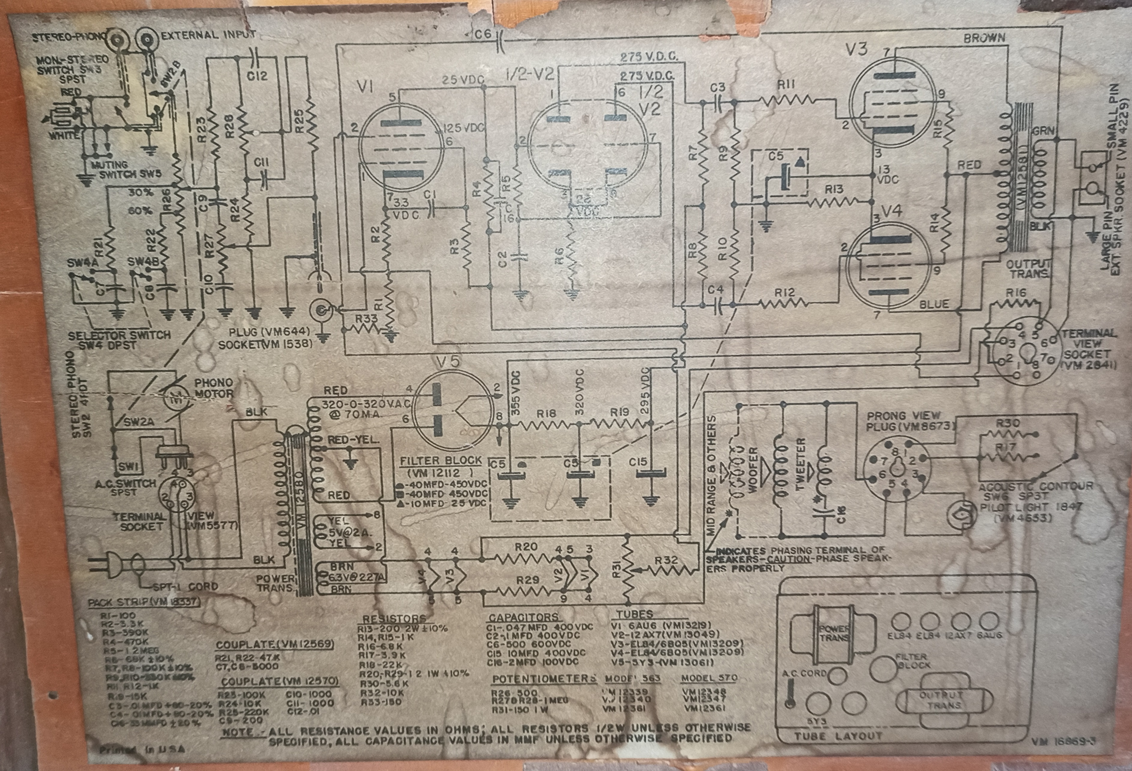

Hi all,
The restoration is almost done. Posted an update and a photo in viewtopic.php?t=2797
Discussed about the next steps with the technician. He said a few things I disagree with:
1. The console currently has two speakers. Judging from the schematic at the back of the cabinet (see photo), I see that there should also be a 3rd speaker, a 12-inch woofer.
He said that we should not add a 3rd speaker, as it will cause issues with the amplifier output (impedance mismatch or something).
2. He also said that the VM-570 is a "Mono" model. I was under the impression that it's a "Stereo" model and that you can plug in an external speaker.
Found this video on Facebook:
https://m.facebook.com/whiteelephantman ... 574539920/
Does anyone know if it will be ok to add a 3rd speaker and if the VM-570 is mono or stereo?
Any info about the external speaker?
Finally we considered adding a Bluetooth receiver in the cabinet and connect it to the second input of the amplifier, so that we can play music from a smartphone (mono or stereo).
What do you think? Any suggestions for a Bluetooth receiver module?
thanks in advance
Andreas
thanks in advance
Andreas
- Posts: 5531
Re: VM 570 turntable issues
Oh my! To start, your unit is a three-speaker unit, and you seem to be missing the 12" woofer as you pointed out shown in the schematic you provided. Besides, how does he account for a 12" hole that is obviously put there from the factory. For this unit to sound like it was intended from the factory you need the 12" woofer, and your amp was designed to power all three speakers with the proper crossover capacitors installed.
The Facebook link that you provided is your and my unit and I do have the extra speaker/amp to make it stereo. Notice I said speaker/amp as the auxiliary cabinet contains an amplifier along with a 10" woofer and a tweeter. If you take a look at your changer, you will notice two slide switches mounted on the changer. The one on the left, labeled phono/tuner, shuts off the changer motor and the one on the right, under the tone arm states mono/stereo. In the mono position all input signal from the cartridge goes to the main unit. In the stereo position the signal is split, and the main unit becomes the LH channel, and the auxiliary cabinet becomes the RH channel. I presume your cartridge is stereo so you should be ready to add the RH channel at some point. To tell if your cartridge is stereo count how many wires are attached to it. Three or four should make it a stereo cartridge. It would also be interesting to know what kind of cartridge your 570 has.
There is a tricky part to the proper wiring for these 570 units and I hope your service guy recorded where the wires were located as schematics do not reference them very well. The wires I am referring to are the ones that go to the two slide switches.
As far as adding Bluetooth, that should be easy as the LH slide switch allows for an auxiliary input. The slide switch is labeled phono/tuner. In the tuner position the motor is shut off so only the amp is being used and there is an input jack I believe called external input located on the back of the cabinet under the changer. You will also find a second jack which is where you plug in the auxiliary speaker/amp to make it a stereo unit. Also, listed on the amp is an auxiliary speaker jack but that will not make it stereo, it just allows you to add extra speakers. Do you have a photo of the back of your 570 that you could share?
I hope this helps and maybe it will help the guy that is doing the work for you. If he still insists that the 12" woofer is not needed, then I might question his ability to do electronic restoration. All the best on getting this resolved, and once it is done and done correctly, you will have a great sounding Voice of Music 570 to enjoy.
- Posts: 9084
Insist that the 12" speaker be replaced, mucho pronto. The schematic clearly indicated that the 12" speaker is a part of the circuit that needs to be there in order for the circuit to function correctly. Leaving that speaker OUT may cause damage rather than putting it back in. I question whoever is working on the electronics on their ability and knowledge of tube equipment. You are right to question what you were told. Good luck.....
Thank you both for the information!
Will try to pass by the shop tomorrow to drop some components I received.
Will tell them about the 12 inch woofer.
You mentioned crossover caps, I see only one in the schematic. Should we add more and if yes, where and what type/values??
Cannot take a photo now, unfortunately, but will try to take a few when I visit the shop or when I bring the unit home.
--A
