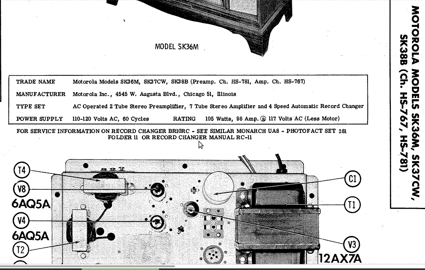

Well, I see from the Sams that it is a BSR/Monarch UA-8.
Hi-Fi manufacturers had their own model numbers, as well
as their suppliers' model numbers.
Zenith is one example I've seen regularly.

Wow. That's strange.
Radio Museum shows the Galvin changer being used in this console and no mention of a BSR. :o
I don't have it however it's also supposed to be in Beitman's Vol 20, 1960
I wonder what they show?
Re: Motorola changer
Post: # 22643Post Hi-Fi-Mogul »
Here is a good example of a manufacturer (Motorola/Galvin)
printing their own "in-house" service publication about the
BSR changer they bought for use in their units.
That info is under the "schematics" section, if you open it up.
https://www.radiomuseum.org/r/motorola_br10rc.html
If you'd like the BSR UA-8 service file, let me know, and I'll upload it.
p.s. the Beitman's only has the circuit schematic, no
record changer info that I could encounter.

That's it Mr. Mogul.
I just now checked out a YouTube vid of UA-8 being serviced and the mechs are the same.
Thank you!
I just finished servicing the motor which was very sluggish and slow. It now spins like a top.
